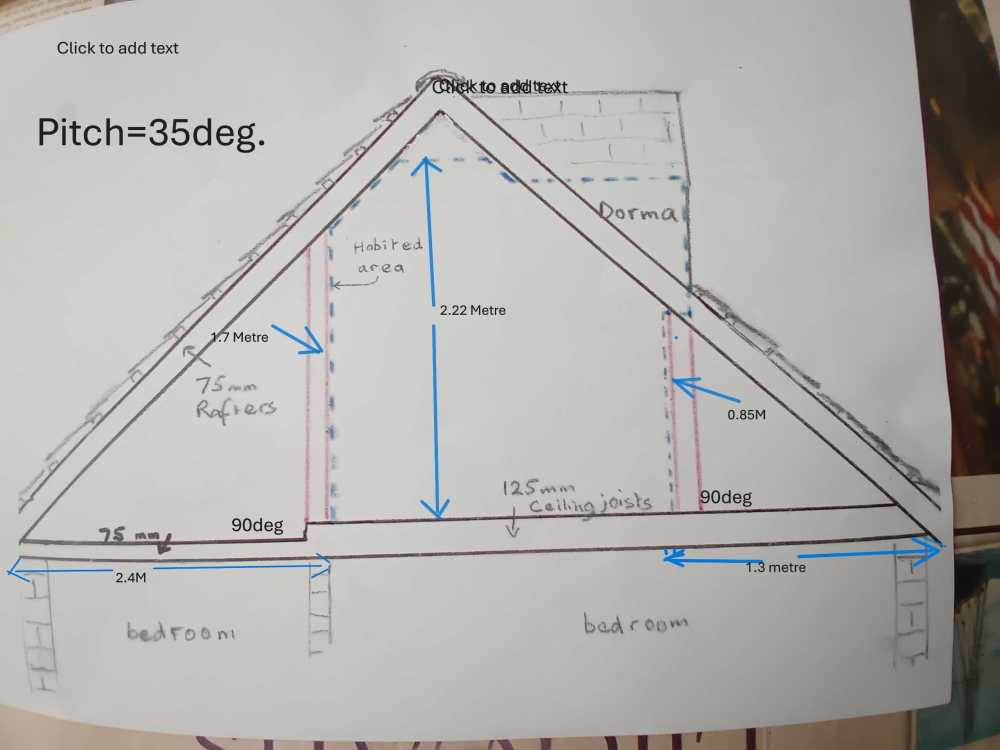

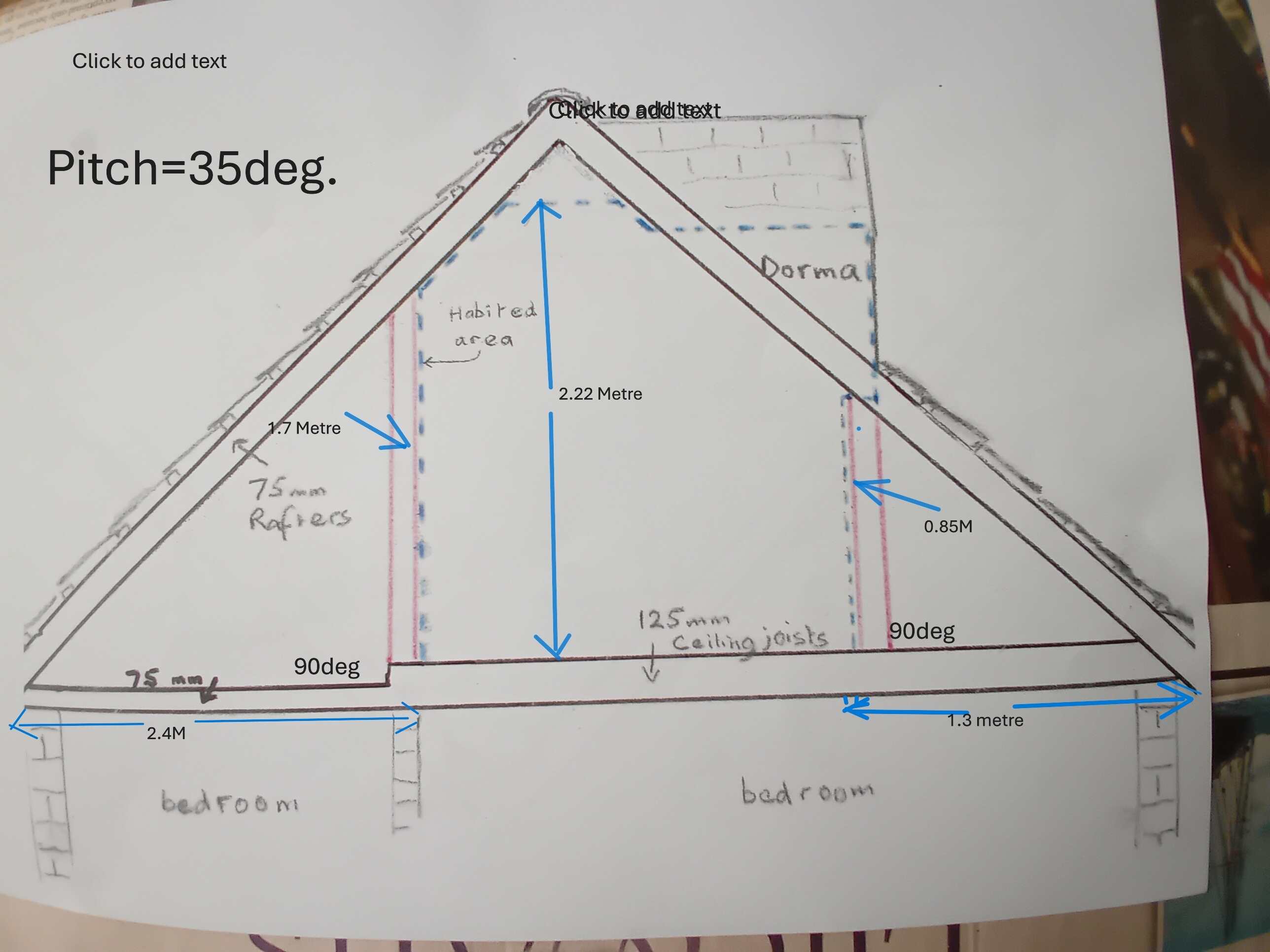

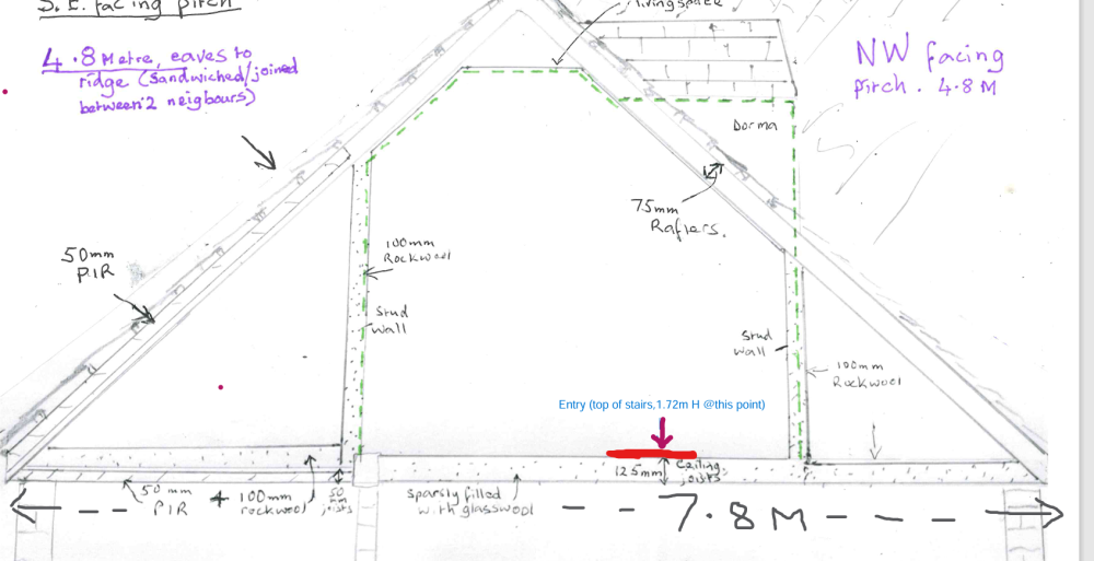

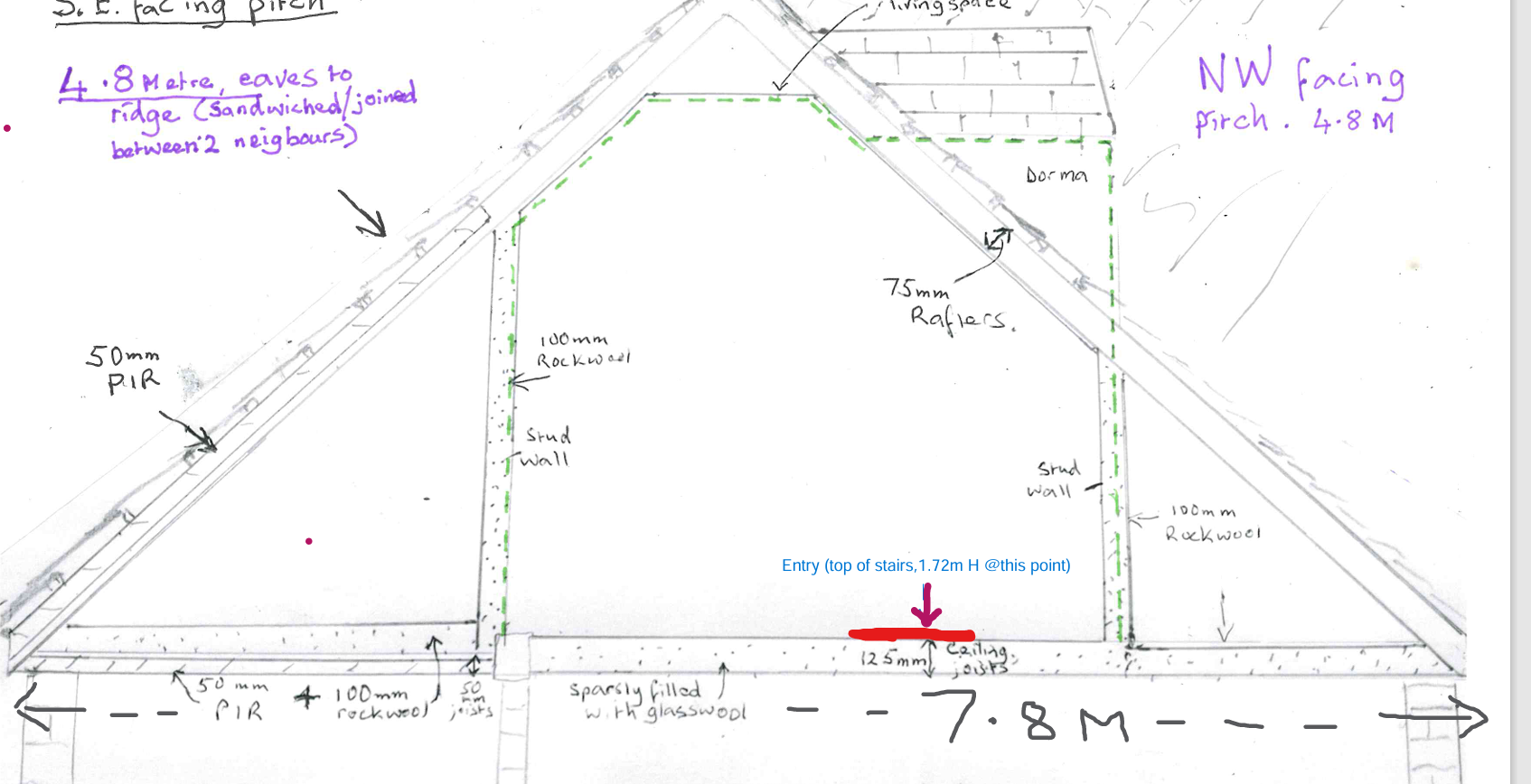

  8. Thanks yet again @Redbeard for your latest suggestions & indeed I hadn't thought of this 'tunnel', & if I decide I can 'live with it' + convince B.C. this could be a way to avoid expense of raising the roof / insulation height. I attach the diagram again but with various additional measurements. Of course I could also add substatial amounts more insulation to those voids in both eaves, to (hopefully) create a much improved U-value & to compensate for deficiency elsewhere (though perhaps never able to get sufficient in) as you yourself mentioned a while back, as well as the 75 + 25 PIR you mention in yr prior post. If anyone knows how to calculate a u-value for these 2 'triangular voids' in Ubacus etc (filling up with rockwool perhaps) could be helpful. Your 'tips' too about a SAP & a greater than 15yr payback period 'excuse' noted; then also your tips re materials for the box gutter construction sound helpful, thanks. This box gutter would be very much for a specialist to do, if I go that direction.
  9. Many thanks @Redbeard, also @Iceverge for your constructive suggestions. These have helped me focus harder on the project, the only major refurb of my 36 yrs in the house - to put slates back on this 1897 terrace after previous owner opted for a cheapo cement tile job - & with no insulation. And its the upgrading of the roof thermal element which will require technical ingenuity & thank you for your already helpful advises etc. Currently I'm awaiting BC considering dispensation allow me a lesser U value in roof thermal element, in light of a low attic ceiling, as in reality it prevents my insulating under it, although, the only other place I could then put insulation is within the 75mm rafters (minus a 50mm air gap !). Instead therefore, I DO HAVE TO seriously consider raising the roof & fitting upto say 5" of insulation there (& making a warm/hybrid roof). Thus planning permission would be sought & I may have to bear with neighbours objections & some significant uplift in project cost. But this increasingly looks the only realistic option, + would make for a thermally more efficient house. And, I've begun looking closely at the type of 'bonding gutter' I'll need at junction with neighbours roof (one side). A chat with a 'lead fabricator' / supplier has recommended a box gutter instead. Photos below are:- 1, my current roof 'junction' (with neighbour); this runs down centre line of chimney. 2, This a perhaps suitable box-gutter design?? I'd much appreciate any views/suggestions from anyone on this aspect of the build. I'd employ a leadworker for such work but any independant views on this detail from forum members welcome, before I commit. Infact I can't find any photos of a box-gutter install on a roof like mine - only pics of where 2 (opposite) pitches meet together. Did the 'lead-worker' mis-advise me? Any thoughts please, appreci\ted !

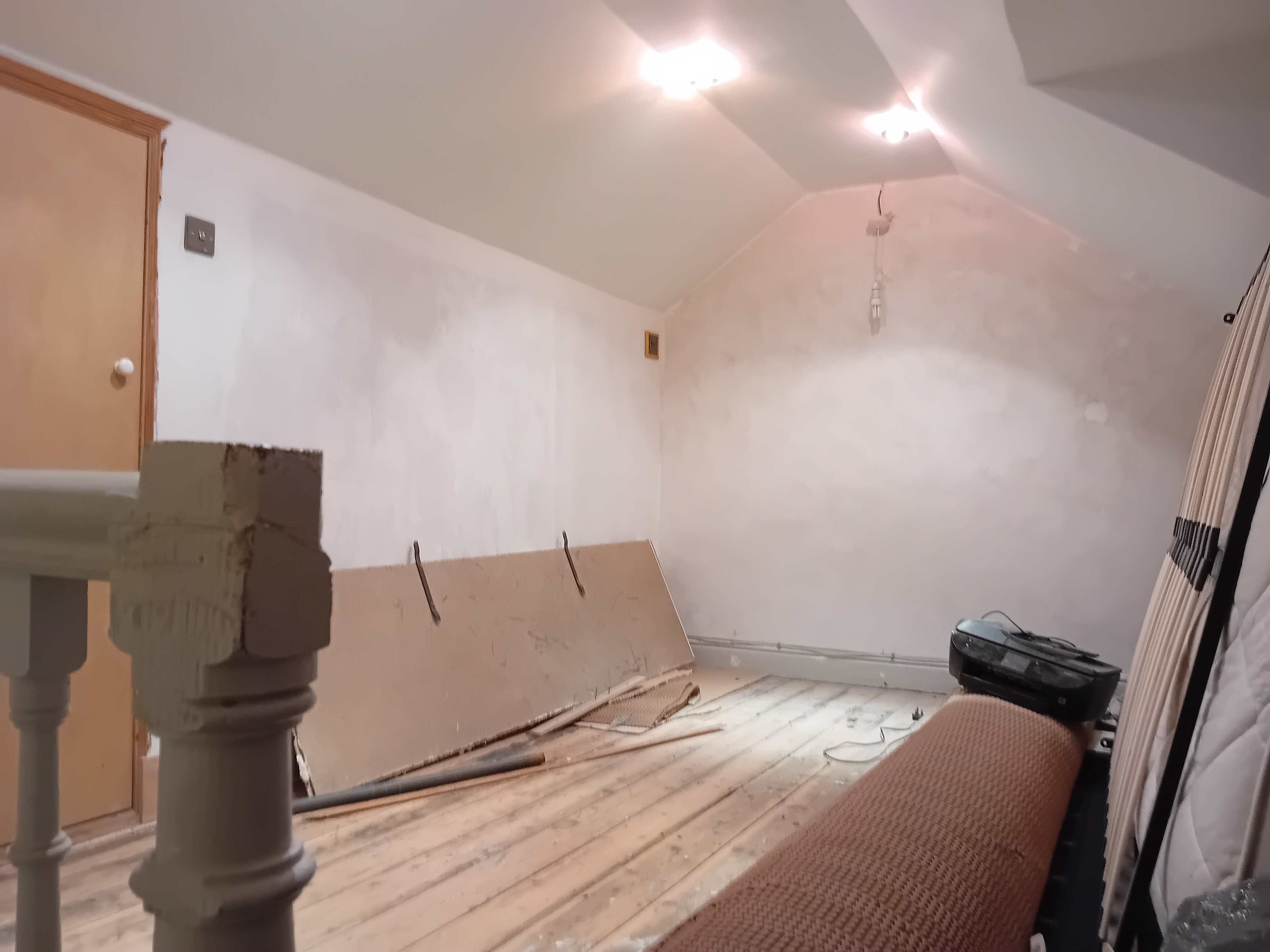

  10. Many thanks@Redbeard your continuing interest in my roof+insulation upgrade. To answer yr Q's of last night hope the following helps: 1st pic is a 'section thru' my current roof as in my prior post but now with measurements. (It does include info too about the insulation currently in there but this likely ripped out during upgrade). And here's a a pic taken from the entry point @ top of stairs: In light of yr suggestions I've made a bit of progress this week & am drafting this right know, so will post this too forthwith

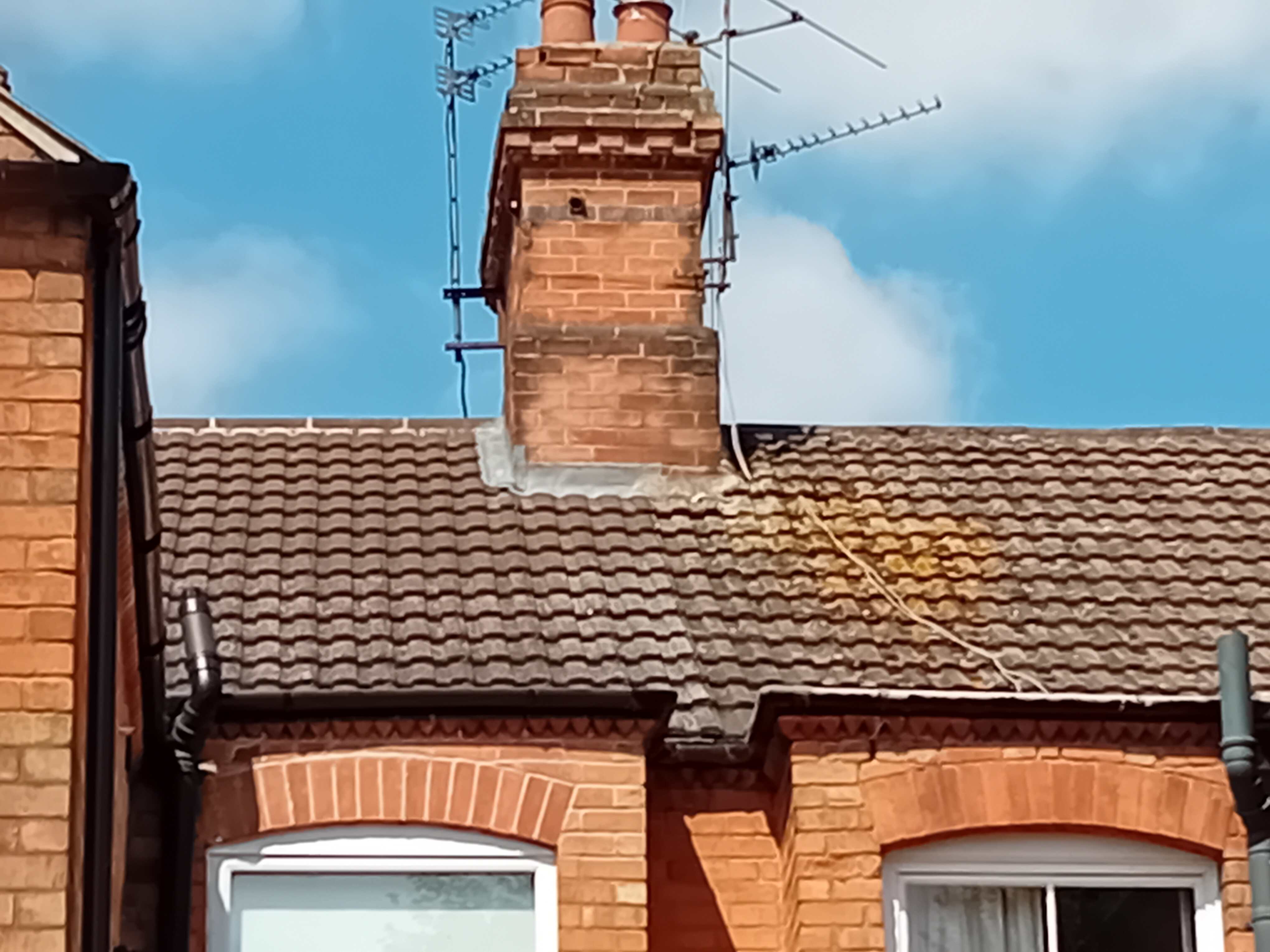

  13. Roof was renewed in the 70's to a cement tile in an all-round poor quality job, now needs doing sympathetically, & back to slate (though possibly with some IN ROOF solar on back elevations). 1. Its a cold roof, see pic 1, showing SE & NE elevations. A main issue is - to up-grade its thermal element extra insulation on interior side of (original) attic room of greater than 40-50mm would be impractical due to already restricted room height & width, see pic 2. So, I'd 'try' adding insulation above rafters, complemented by the PIR between rafters, (& then makes it a hybrid roof, as Redbeard reminded me on here). So I see raising roof height (by say 50mm) basically being essential, to get to regs, & being 'engineered' by way of a counter-batten etc; but its also necessary my roof 'integrates' with my neighbour to the left side (using a bonding gutter of some comprehensive design I guess, though my B.C. officer says such a bonding gutter, & perhaps additional lead flashing(s), no big deal!) I'm still going to struggle to get to a 0.16 U-value however much insulation I can get in/up there but see little other option. (Redbeard also mentions a 2-thirds above/ 1-third below-rafter rule of thumb for insulation to avoid the 'interstatial' enemy). Q) Has anyone else any thoughts / suggestions on my meeting my 0.16 U-value for insulation requirements or even approaching - B.C. look sympathetically at draughty old properties . . they say. 2. I include below a link showing how TLX (gold, a multifoil) suggest their product be used above rafter in build-up of roof thermal element -including a counter-batten, stated as 38mm (old regs?, presumably now 50mm?), & which also provides ventilation on cold-side of roof. And this would raise my roof +/- 50mm). See its detailing & spec. here:- https://tlxinsulation.co.uk/wp-content/uploads/2021/08/TLX-Gold-Counterbattened-plus-50mm-PIR.pdf 3. It says, in this link, that TLX multifoil used to build-up thermal element with this product, including air gap/s, above rafter, followed by 50mm PIR/phenolic within rafter, has a U value of 0.34. So, if I were to indeed add a further 40-50mm max. PIR (thermal conductivity .022 W/mK) to the inside, under plasterboard . . would this 'build-up' get any where near the 0.16 requirement? (its beyond me to calc. this myself!). a) Anyone else care to comment further on my thoughs on this insulation detail? b)also what do you/others REALLY THINK about these multifoils - do they actually work (as long as fitting + air gaps adhered to) . . or not, & actually meet U values claimed? c) Also I'd be interested to hear from anyone about design/detail of a succesful bonding gutter - my roof will be in ~10mm slate but raised say 50mm as explained : meeting neighbour's cement tile. Many thanks, Stephen, Leicester area.
