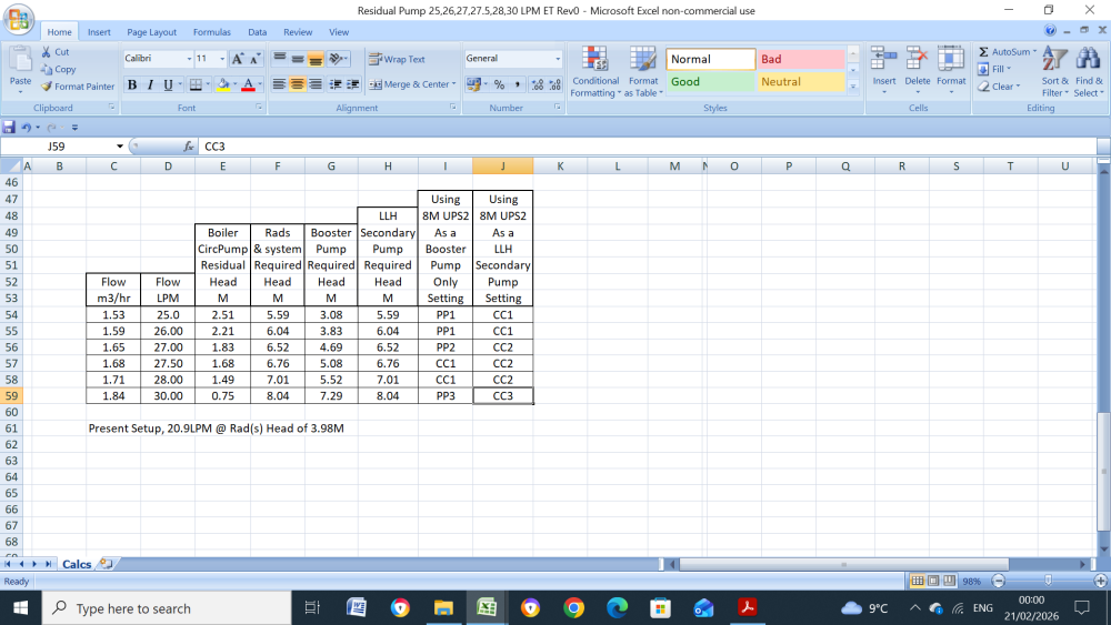

EinTopaz Posted January 5 Author Posted January 5 (edited) On 02/01/2026 at 21:28, JohnMo said: Thick stuff - 25mm wall thickness, cover in aluminium tape to stop mice eating it. It has some of the 25mm stuff on already but struggled to get it that thick in many places as the pipes are tied directly to the underside of the floor joists. So a good portion of it is only 13mm thickness too in tighter spaces I was thinking of getting a plumber round to unpin them and run them along the concrete slab floor instead, well not directly on the floor I’d put 100mm PIR board on the floor and run them along that. Then I could go as thick as I like with the insulation. Or put even more insulation ontop of it too then. Or box all the pipes in in using more PIR. I also saw there’s a pipe insulation called phelonic which has a much better insulation rating than the foam stuff. Though it’s about £6 per meter. Wondering how far is too far. But it is -4 here today and that subfloor is very well ventilated. Probably best to treat them as external pipes, or as good as. Edited January 5 by EinTopaz

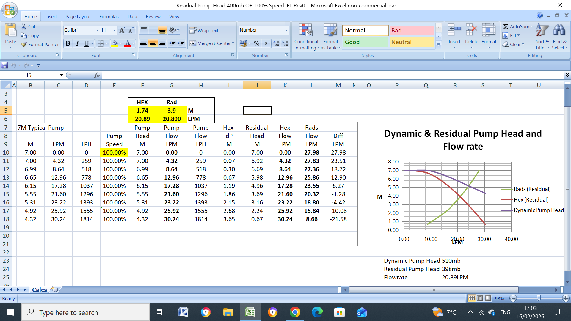

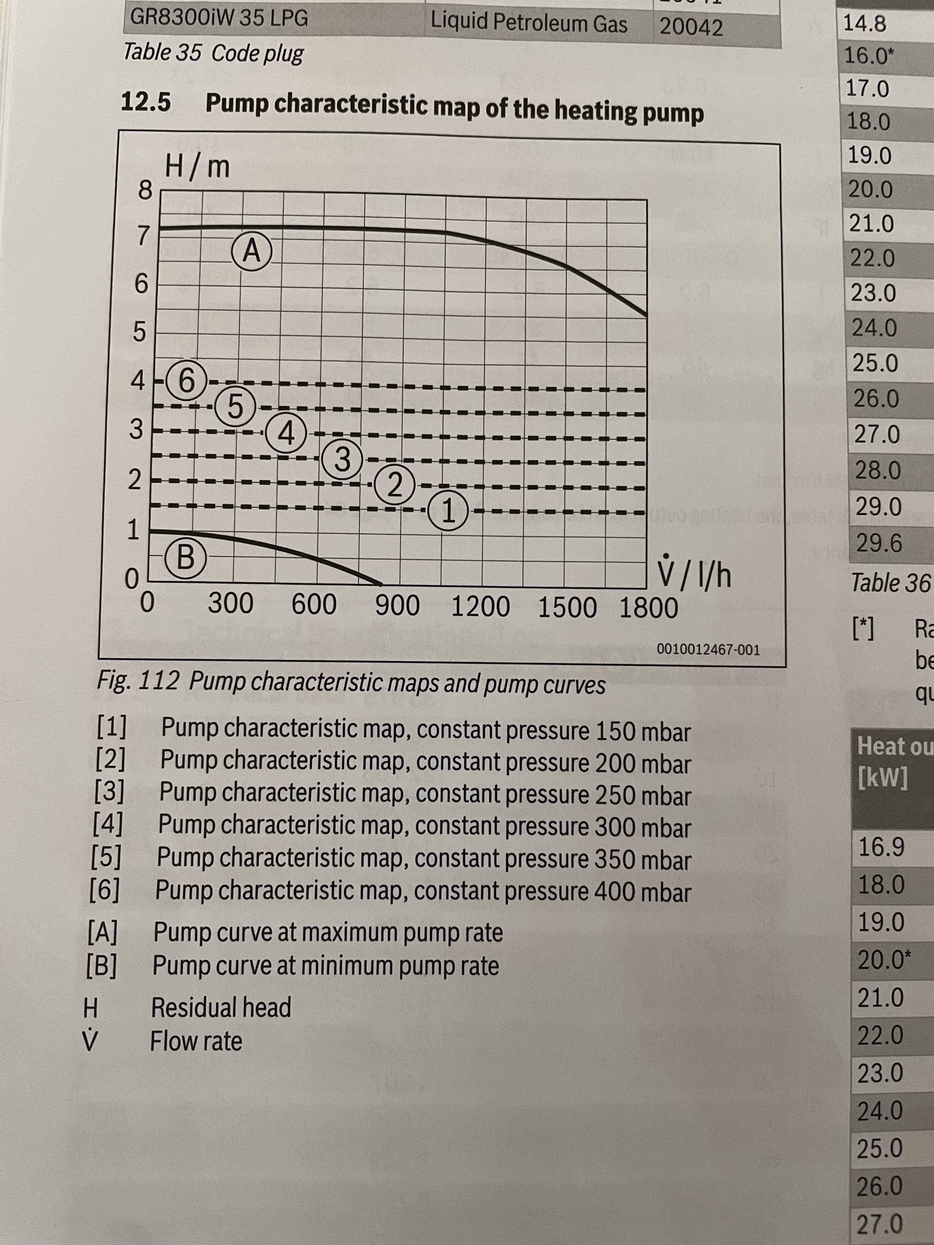

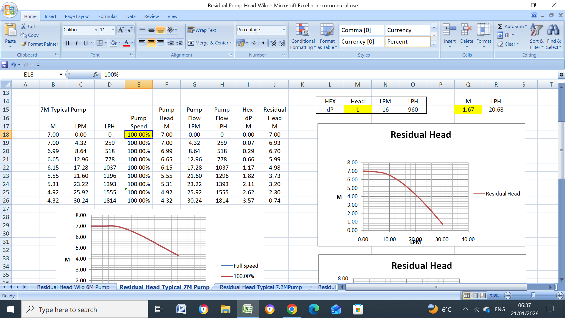

John Carroll Posted January 13 Posted January 13 (edited) If you look at the pump curve above, you will see "H/M" (M is meters) right at the top and it states right at the bottom that H is the Residual head. Residual head is the pump head available after the boiler HEX, you can see the pump head just starts falling, 1200LPM (21.7LPM) @ 7.0M head which indicates to me that the boiler HEX has a pressure loss of 7.0-4.0, 3.0M at a flowrate of 21.7LPM, you are getting very close to this flowrate, 21.5LPM at full pump speed. The residual (remaining) net head of 4.0M is lost through the CH system. If you now install a LLH where the primary pump just circulates through the boiler HEX and a (new) secondary pump circulated through the CH system, then, all the secondary pump head is used to increase the flow through the CH system which will increase the return temp/reduce the dT and get a increase in rad output and a faster warm up. If you install a "6M" secondary pump then the flowrate will increase from 21.5LPM to, 21.5*sqroot(6/4), 26.3LPM, not a lot as the rads dT will only fall from ~ 12C to 10C which only gives ~ 3% in rad output, say a increase of 0.6kW from 18.0 to 18.58. The easiest way to get a faster warm up is to increase the flowtemp to say 75C but would need reducing again when roomtemps reached to maintain reasonable boiler efficiencies. When the engineer next attends ask what the pressure loss through the boiler HEX is, dP & flowrate. Edited January 13 by John Carroll 1

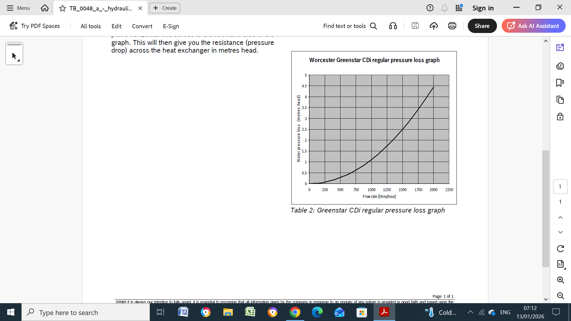

John Carroll Posted January 13 Posted January 13 (edited) Below gives a idea of the loss through the boiler HEX, this might be the same as your boiler but try and get the proper one for your boiler. The pump curve above shows that the flowrate (curve A) is ~ 27.5LPM, 1650LPH at a head of 6M, the screenshot, below shows that the boiler HX pressure loss at this flowrate is 3.2M, this leaves a residual pump head of, 6-3.2, only 3.1M, so would require a LLH to allow a secondary pump to suppy enough head to give this flowrate. You could look at installing a booster pump instead of the LLH, far cheaper, even though frowned on by some because a perceived problem that the pumps wouldn't be matched leading to problems, I don't see a big problem with this as pumps like my own Wilo Yonos Pico have virtually infinite head setting (in 0.1M incremants) in CP (and PP) mode, to match the other pump. Edited January 13 by John Carroll 1

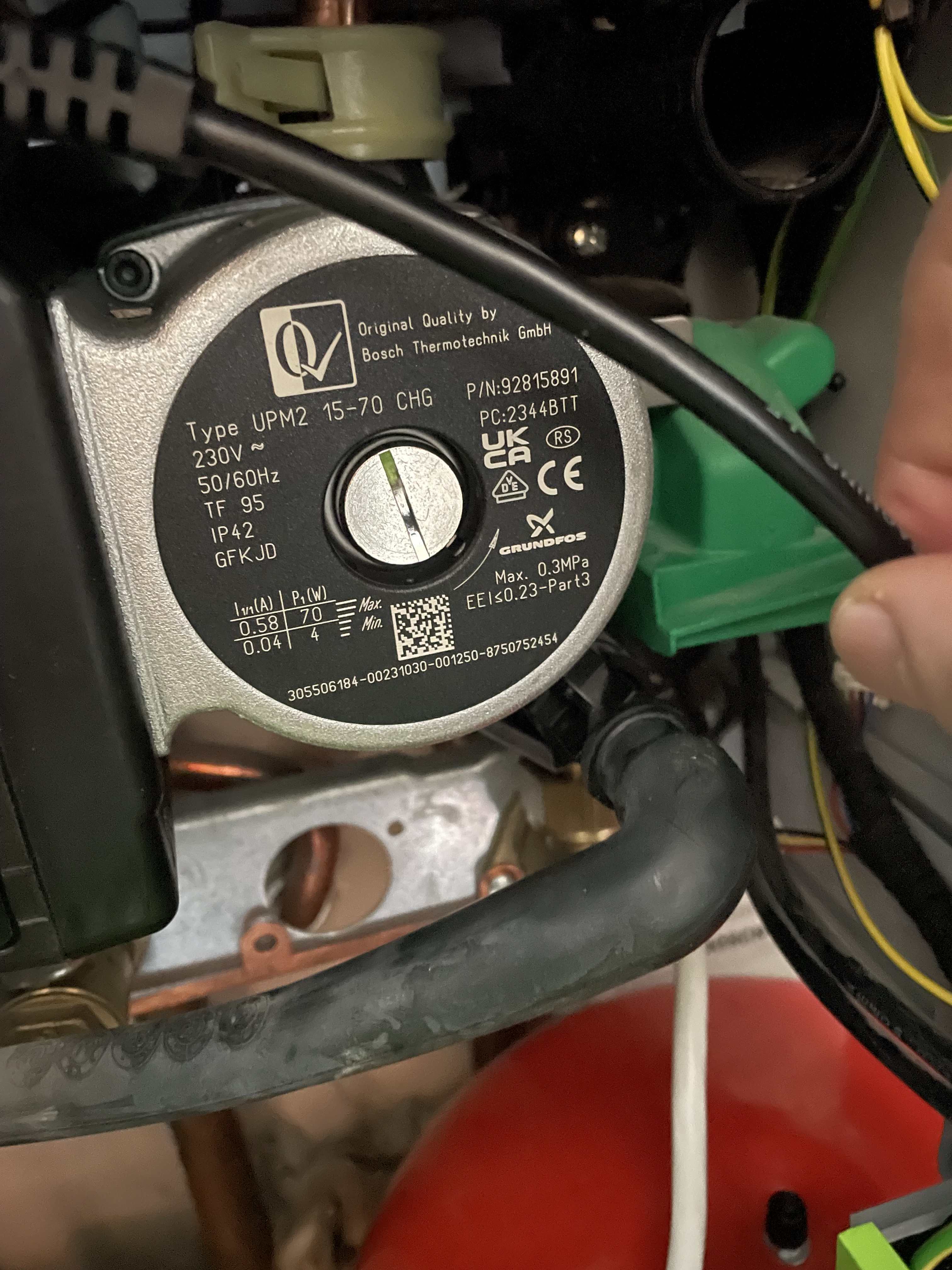

John Carroll Posted January 21 Posted January 21 (edited) @EinTopaz I think I may finally have a answer to your query..... " if its 15-70, why is setting 6 (400mbar) show as pump output 100% on the boiler LCD display? Does that essentially mean its got way more head than it's able to use? i.e it's capable of 700mbar, but can only run 400mbar max? I find the manual quite confusing here and it'd be great to understand" The pump appears to be able to calculate the speed required to give a RESIDUAL HEAD of 400mb based on the HEX dP and the system/Rads dP, in your case, with a new clean HEX and because of your system resistance then the pump has to run flat out to achieve this residual 400mb, you can read off the flowrate from the Residual Head chart, which is 20.7LPM at 400mB, the clean HEX dP is only 1.67M at this flowrate. I have based the HEX dP on one I think is correct for your boiler, you might ask them for it sometime. Edited January 21 by John Carroll 1

John Carroll Posted February 6 Posted February 6 Yes, but remember the flowrate is a indicated 21.5LPM at 100% pump speed,a pretty hefty flowrate. If the engineers haven't come and gone please ask them for the boiler HEX pressure loss as I used a assumed one. 1
