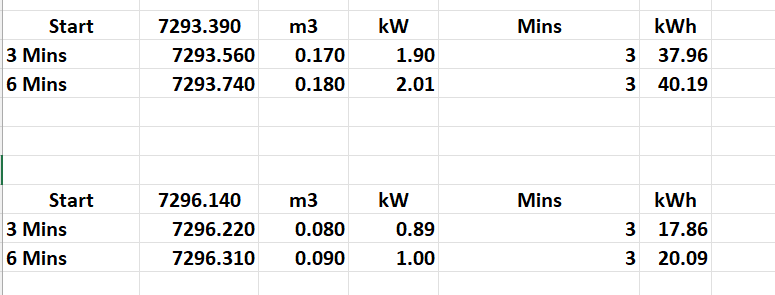

Lastly, I did two lots of measures on the meter, first set when the boiler was at 100% and second set when it had settled to 49%
100% meter readings (in m3 meter cubed)
0mins  - 7293.39
3 mins - 7293.56
6mins - 7293.74
49% meter readings ( in m3 meter cubed
0mins -7296.14
3mins -7296.22
6mins -7296.31
What do you guys think? To me im not sure why it's staying above target for so long before it starts modulating down. If the greenstar 8000 has no return sensor, i wonder what is making it think it needs to stay so hot at such high % long after target is achieved?
0mins  - 7293.39
3 mins - 7293.56
6mins - 7293.74
0mins -7296.14
3mins -7296.22
6mins -7296.31
I would think it's managing the modulation based on flow temp target
Anyway kWh usage below for the for the two sessions
100% being the first one shows the boiler is really chucking everything it can at the circuit
49% being the second one shows it's modulation percentage is not far out

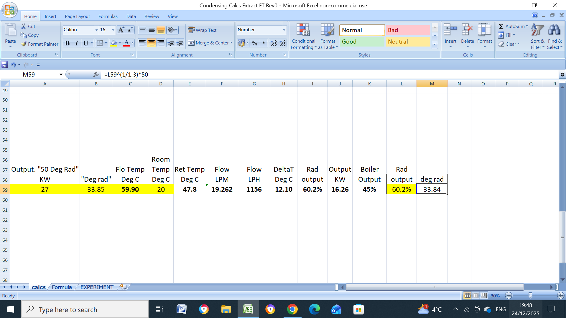

Posted (edited)
Overall, not too bad really, 25 minutes from a cold 15.6C to 60C Target/flowtemp in 25 minutes isn't outrageously slow IMO.

Posted (edited)
thanks for the data again on that John.
RE: the 25mins to 60'c yeah Im happy with that. It's more the fact its going so far beyond target and still not modulating down for a while that's concerning me. It has took a turn for the worst again on Christmas day, will make a separate post below as it's a bit meatier.
