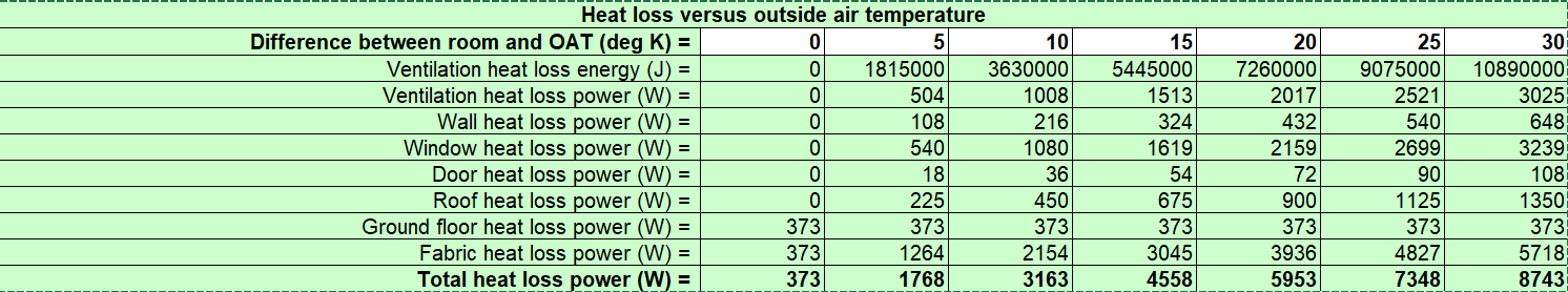

Thanks to all those who have already assisted me on these topics.
We are embarking on a major renovation of an 1949 bungalow, extended through the late 1900s to dormer bedrooms. Building a new first floor with timber construction, extending ground floor a little, adding external insulation to any existing walls, new DG windows and doors throughout. South-westerly aspect without shade. Will have PV and battery storage (not got to work on planning this yet).
GF heated area 148m2
FF heated area 85m2
Total vol approx 600m3
Location N Somerset, just west of Bristol
I have run Jeremy's heat loss calcs as best as I can, yielding the following (with soil temp 6C, ACH 0.5, no heat recovery)
Looking at UFH throughout ground floor - mainly suspended timber and will be able to add plenty of insulation, but small area (kitchen/dining) of existing concrete floor to be extended slightly.
Probably FCUs upstairs, although not decided yet, with the intention of some heating if necessary (maybe not needed?) but definitely active cooling,
Family of 5 with 3 kids who will be teenagers soon - I am firmly against long showers but their mother is harder to persuade. Envisaging 300L UVC emptying rather fast so considering a larger one.
Have been offered plenty of high output heat pumps through MCS-certified installers, with the accompanying eyewatering costs. Trying to get my house in order to challenge them, but also want to know I'm not going to regret going smaller!
Questions:
  1. I am looking at ASHPs with max ouput 8-9kW based on previous advice from this forum. However my interpretation of the above calcs is that I need to be able to modulate down towards 3kW for efficient running in the less cold months. Is this correct? I've earmarked the Vaillant aroTherm + 10kW model as one option but finding it hard to identify other models with enough modulation (mainly due to poor documentation by the manufacturers - is there an "uber sheet" with these data anywhere?!)
  2. Wunda have offered me a 2-zone UFH system for the GF for £4.4k inc VAT - 2 zones needed as, whilst most is suitable for a between-joist system, the concrete floor area needs their "rapid response" to give similar performance. I had asked them for a screed system throughout the GF and need to ascertain why they think their proposal is better. Also sounds like a lot of £ compared to what others have posted. Thoughts? System volume is 148m3
As will be evident, I've never done anything like this before and am doing as much reading as I can to defend myself against blowing a big chunk of the budget on an inappropriate heating system!

I'm not sure that the way the losses are displayed from Jeremy's heat loss sheet is the most user friendly and helpful. Personally, I always derive a W/K heat loss value from the heat loss calc which I then use to understand a what outdoor temperature the heat pump reaches minimum output. For example, if it reaches this at 13C, it may be much less of a problem than if it reaches it at 8C. Some manufacturers, like Nibe provide max and min outputs in charts (not including defrost) for all relevant outdoor temperatures whereas so many just give a figure at a defined outside air temperature and you then have to learn what it really does.
