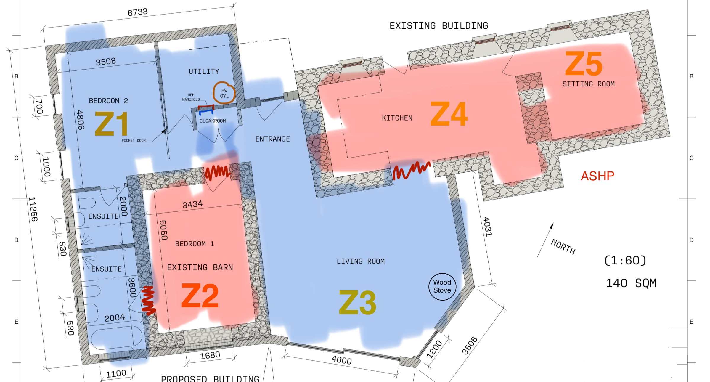

December 11, 2025Dec 11 We're planning a full renovation of an old stone cottage, with a new large extension. We'll have in-slab UFH throughout, and for the extension the concrete slab will be the finished floor. Because of the way the extension wraps around two sides of the cottage, it might be too risky to dig out both sides of the stone walls, even with underpinning. It would be much safer to pour the extension slab and inside floor separately. Would it be possible leave the pipes sticking out of the slab edge at the opening to the cottage, and then attach more pipe with couplers when completing the cottage floor and bury them in concrete. I'm worried that the connection is a failure point, some of the couplers say they are not to be buried. Would it be better to have the whole pipe loop sticking out of the slab, and then lay it down after digging out the old concrete and rubble floor. Then I'd be worried about it getting damaged. The other option I can think of is to dig out a small part of the floor to where the couplers could be hidden in an access hatch under a kitchen cupboard, or maybe slightly up the wall to be connected above ground?

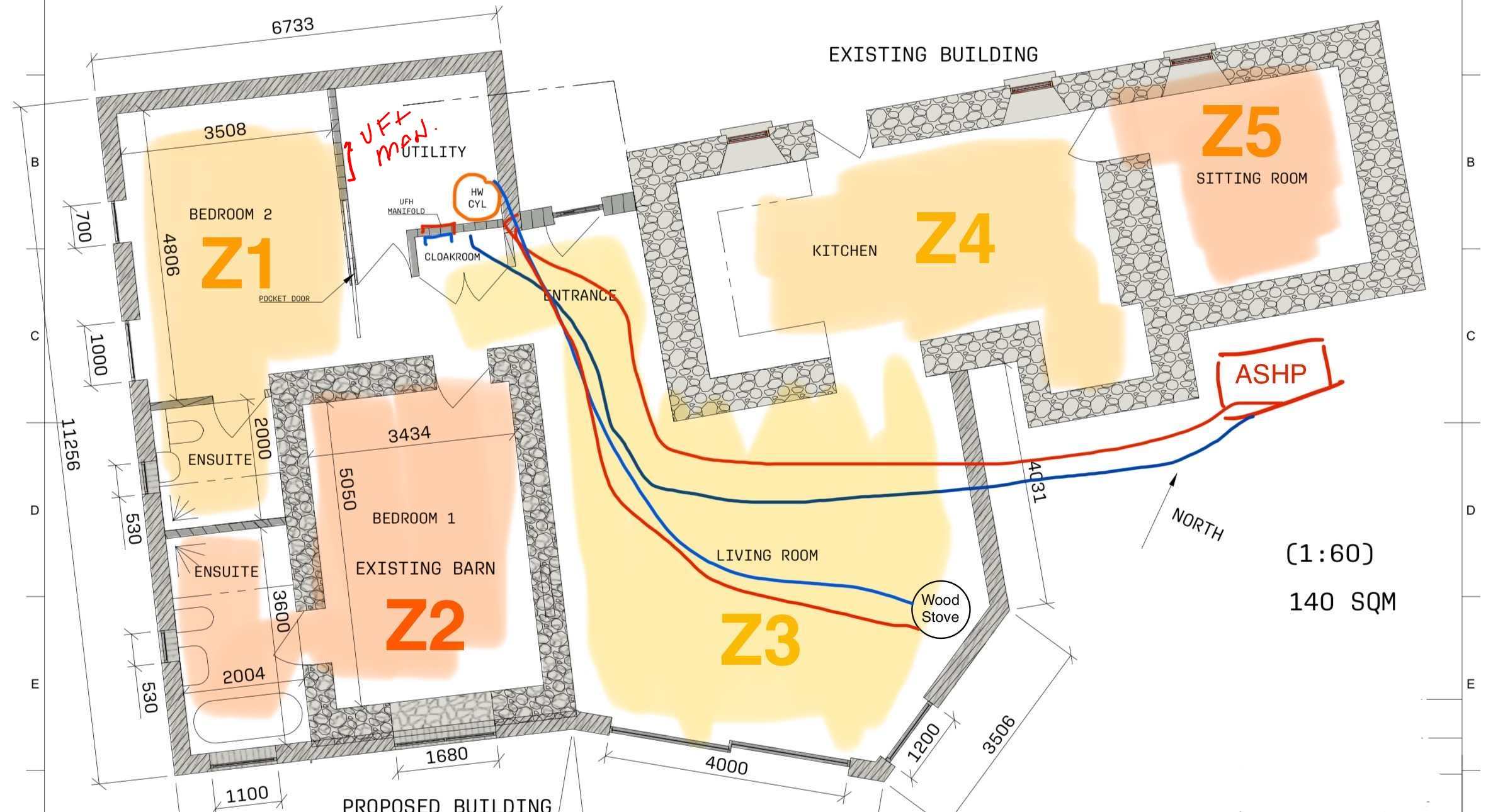

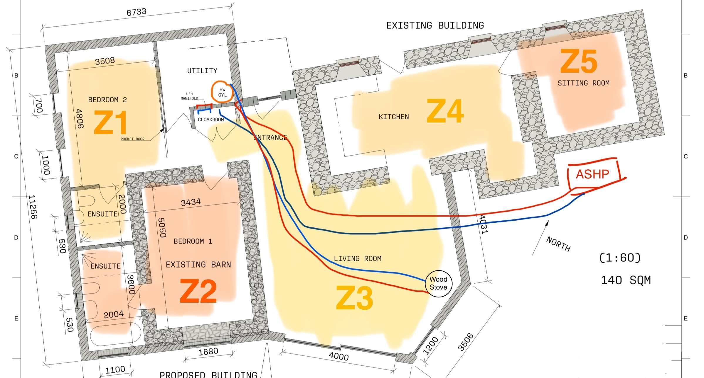

December 14, 2025Dec 14 Author Sorry I forgot to check back on this! Here’s a drawing. We’re renovating an old stone cottage with 50cm thick stone and rubble walls, and a small outbuilding of similar construction. The new extension will wrap around the outbuilding with a larger pitched roof, and a flat roof living room links to the original cottage. The new slab foundation is Bed 2, both ensuites, utility and living room. I planned for the main manifold and hot water cylinder to be in the utility room. The ashp is over the other side though, it’s a corner out of the way that we wouldn’t otherwise use and is away from the bedrooms. I was going to run the pipes to it through the insulation under the slab and insulated through the ground at the last bit. It’s about 12-15m. We want to have a small wood stove in the living room, mostly because it’s nice but possibly as an extra heat source if the ashp struggles at any point. So we’d run pipes through the slab for that. I’ve seen some cylinders that have separate ports for stove boilers, I guess that makes it easier to get lots of heat out of it without over heating the ashp or UFH? Such as for hot running water? I was also thinking that during a power cut (common where we are) we could run the pump from a battery/generator and use the stove to heat everything. The floors in the old cottage and possibly also Bed 1 might have to be poured separately to the rest of it so we don’t undermine the walls. We could put the main en-suite on another zone and run it outside the stone wall so it’s all in the new slab. For the cottage maybe it makes the most sense to have a second manifold in the kitchen? I also wondered if it should be a separate mixer as it would have different thermal characteristics to the new slab. Could that be connected to the return from the ashp or would it take too much heat out before it gets to the main manifold? Thanks for any and all advice! (edit: we’re also putting in MVHR throughout) Edited December 14, 2025Dec 14 by Jess Shannon
December 14, 2025Dec 14 If you located the manifold on bedroom 2 / utility wall, you could takes pipes in to utility and terminate them on the manifold? Are you using the wood stove/boiler just for cylinder heating or UFH as well? Could you locate the ASHP nearer the utility? It looks to be on the south side of the house, which isn't ideal. Should be located out of the sun really.
December 14, 2025Dec 14 Author 25 minutes ago, JohnMo said: If you located the manifold on bedroom 2 / utility wall, you could takes pipes in to utility and terminate them on the manifold? Not sure what you mean. The manifold would be in the utility next to the hot water cylinder, to the right as entering the room, the wall straight ahead will have washer/dryer etc. 27 minutes ago, JohnMo said: Are you using the wood stove/boiler just for cylinder heating or UFH as well? Don’t know yet, depends on cost/complexity. It would only be for occasional use. So far my plan is to run pipes for it in the slab, and then figure out how we want it after spending a winter in there with just the ashp. 29 minutes ago, JohnMo said: Could you locate the ASHP nearer the utility? It looks to be on the south side of the house, which isn't ideal. Should be located out of the sun really. The north is facing the road and entrance into a courtyard area on the left. Where it is on the diagram is the most discrete place, could it be shade from direct sunlight with a screen, or should it really be on the north side?
December 14, 2025Dec 14 21 minutes ago, Jess Shannon said: Not sure what you mean. Locate as shown, drill holes through wall from extension low down (piping level), and excavate area under manifold, connect UFH pipes, pressurise. Then no joints needed etc. cover manifold with some insulation to protect it from bangs and knocks. 21 minutes ago, Jess Shannon said: occasional use. Is it worth the hassle and increased expense to install boiler stove, piping and additional heat dump etc?
December 14, 2025Dec 14 Author Ah sorry, that is all part of the new slab, shaded here in blue. The old floors that might need to be second phase are in red, and connecting points at the red squiggles
