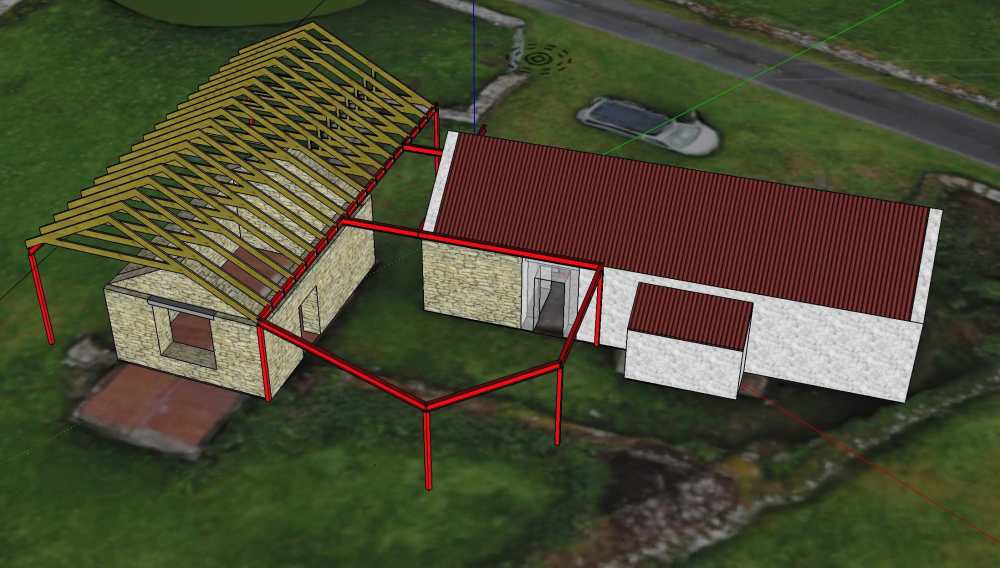

  2. We're building an extension on to an old stone cottage. The new foundation will be insulated raft with UFH. The extension will have a pitched roof section and a flat roof section with steel frame connecting to the old building. A builder friend is helping us design it. He's suggested 220mm studs so we can have a thick layer of insulation. He said twin studs could end up costing more due to added labour over any material cost saving. But will the cold bridging mean it's not worth it in the long run? Should we apply an external layer of continuous insulation too? I've mocked up his suggestions on ubakus to look at performance (edit it here). And this is a build up that I've put together based on other research, with an external PIR sheathing (edit this one here). Would this kind of PIR board be able to wrap up and over the roof too?

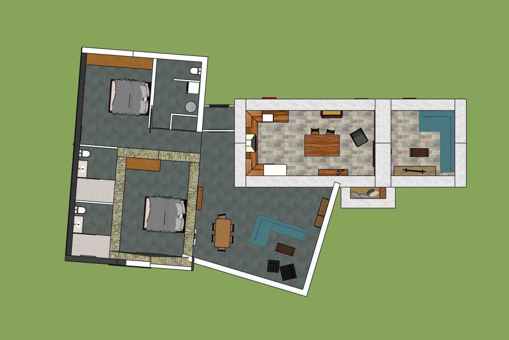

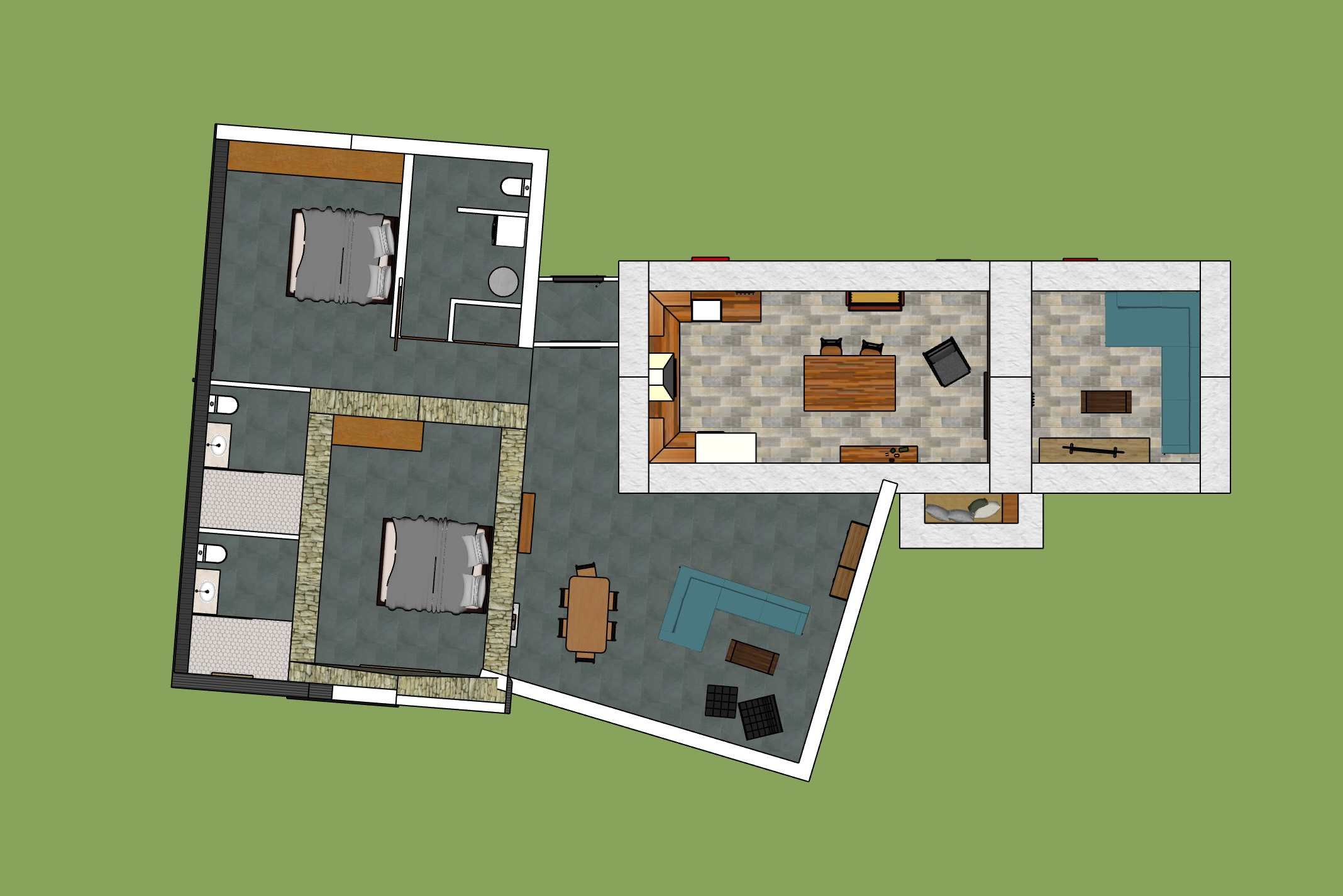

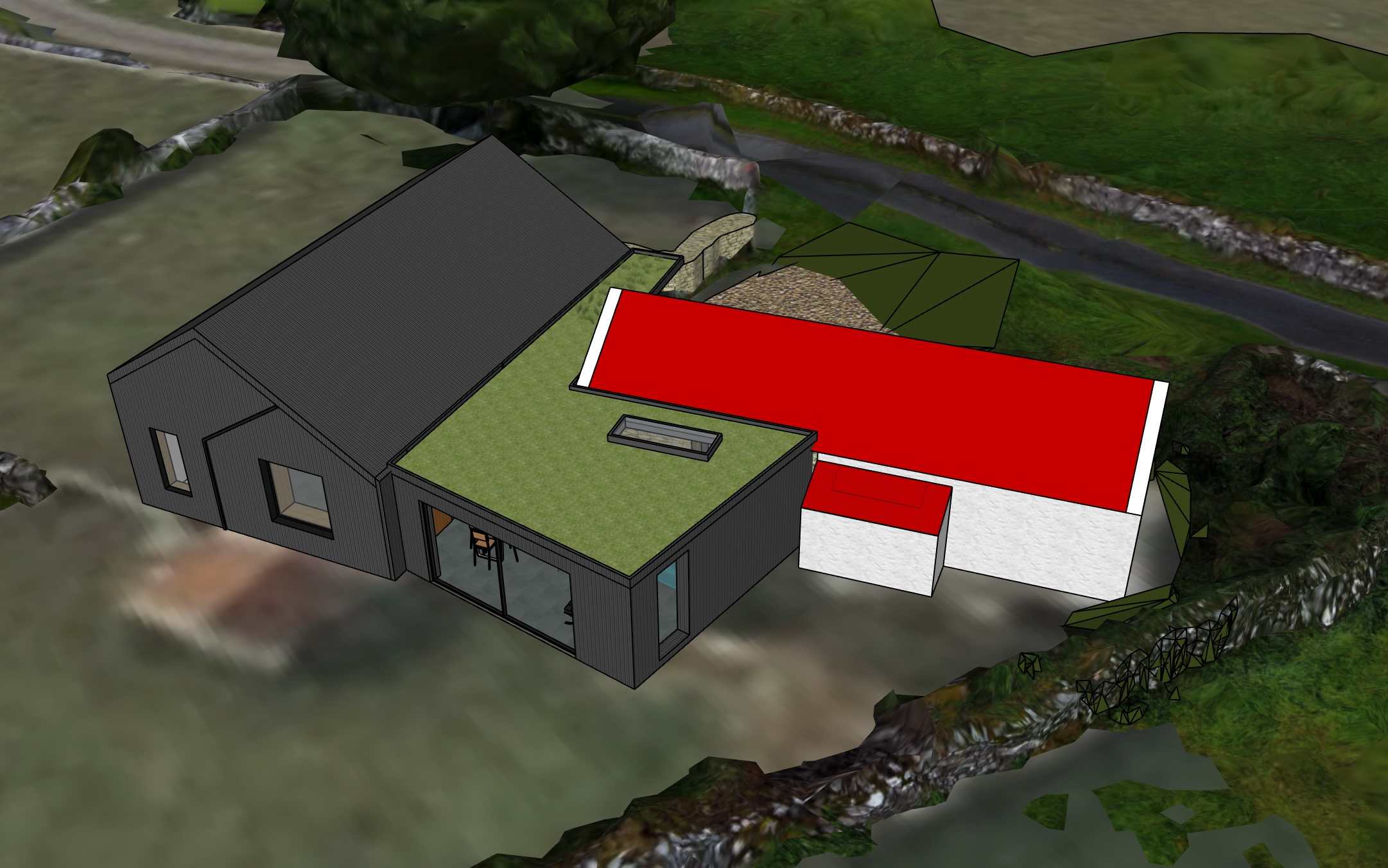

  4. Ah sorry, that is all part of the new slab, shaded here in blue. The old floors that might need to be second phase are in red, and connecting points at the red squiggles
  5. Not sure what you mean. The manifold would be in the utility next to the hot water cylinder, to the right as entering the room, the wall straight ahead will have washer/dryer etc. Don’t know yet, depends on cost/complexity. It would only be for occasional use. So far my plan is to run pipes for it in the slab, and then figure out how we want it after spending a winter in there with just the ashp. The north is facing the road and entrance into a courtyard area on the left. Where it is on the diagram is the most discrete place, could it be shade from direct sunlight with a screen, or should it really be on the north side?
  6. Sorry I forgot to check back on this! Here’s a drawing. We’re renovating an old stone cottage with 50cm thick stone and rubble walls, and a small outbuilding of similar construction. The new extension will wrap around the outbuilding with a larger pitched roof, and a flat roof living room links to the original cottage. The new slab foundation is Bed 2, both ensuites, utility and living room. I planned for the main manifold and hot water cylinder to be in the utility room. The ashp is over the other side though, it’s a corner out of the way that we wouldn’t otherwise use and is away from the bedrooms. I was going to run the pipes to it through the insulation under the slab and insulated through the ground at the last bit. It’s about 12-15m. We want to have a small wood stove in the living room, mostly because it’s nice but possibly as an extra heat source if the ashp struggles at any point. So we’d run pipes through the slab for that. I’ve seen some cylinders that have separate ports for stove boilers, I guess that makes it easier to get lots of heat out of it without over heating the ashp or UFH? Such as for hot running water? I was also thinking that during a power cut (common where we are) we could run the pump from a battery/generator and use the stove to heat everything. The floors in the old cottage and possibly also Bed 1 might have to be poured separately to the rest of it so we don’t undermine the walls. We could put the main en-suite on another zone and run it outside the stone wall so it’s all in the new slab. For the cottage maybe it makes the most sense to have a second manifold in the kitchen? I also wondered if it should be a separate mixer as it would have different thermal characteristics to the new slab. Could that be connected to the return from the ashp or would it take too much heat out before it gets to the main manifold? Thanks for any and all advice! (edit: we’re also putting in MVHR throughout)

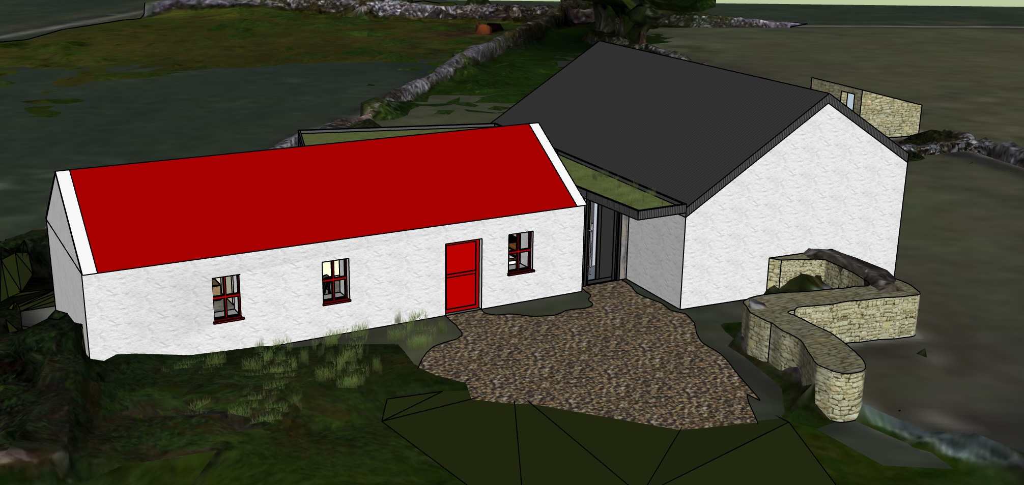

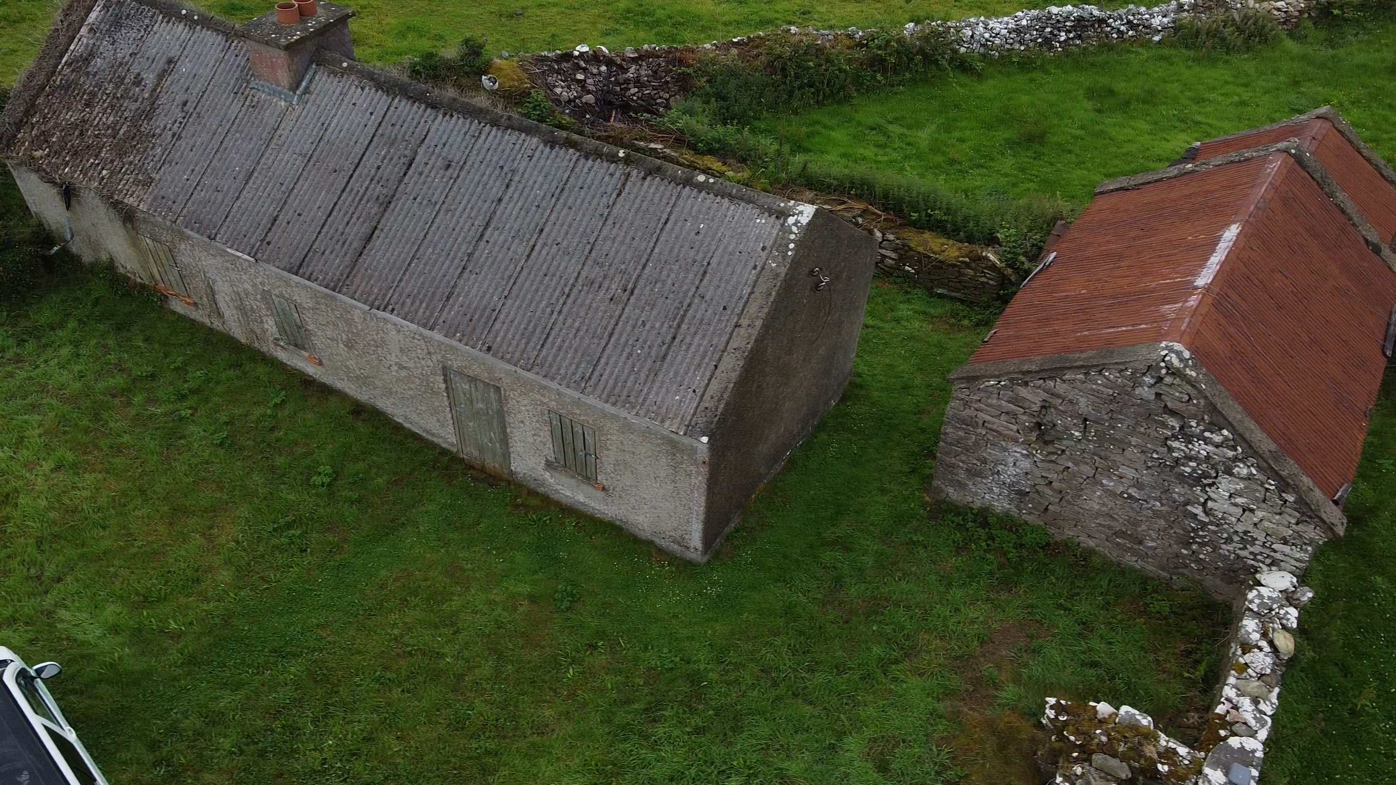

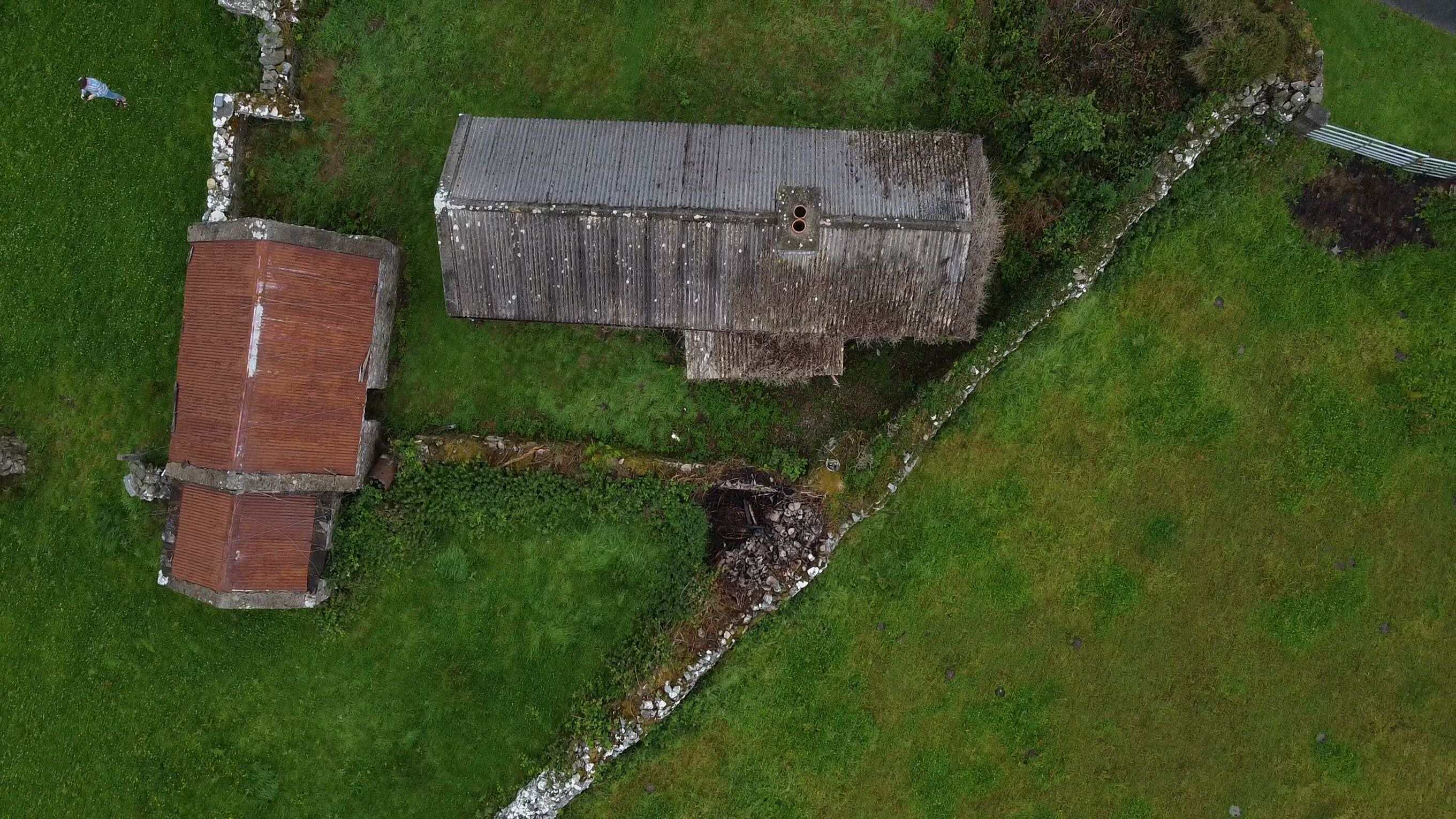

  12. Hello! My partner and I are just starting out on our project after buying a derelict cottage in Ireland. I hope it's ok to post questions about it here, I know the laws/codes can be quite different in Ireland, but there's not many resources like this forum. We're total novices at building, but want to do as much as we can ourselves and to learn while doing it. We've had a little input from architects and a builder who will hopefully be working with us. Obviously we'll be getting an engineer involved eventually. Our starting point is a mostly untouched vernacular 3 room Irish Cottage. With countless layers of lime plaster on the walls and no plumbing of any kind. Sometime in the 70s the outside was concrete rendered, a limited electrical install was added, and the remains of the old thatched roof was covered over with asbestos cement boards. Close to the house is a small traditional stone shed. The whole area is criss crossed with beautiful dry stone walls. Our current plan is to restore the cottage in an authentic traditional way, with breathable lime plaster. But have a new well insulated roof, door, and windows. Then link it to the barn with a flat roof extension. The stone barn will be fully enveloped in a new building which extends out the other side to create a spare bedroom and ensuite bathrooms. Here's a few photos. I'm sure I'll have lots of specific questions as we go!
