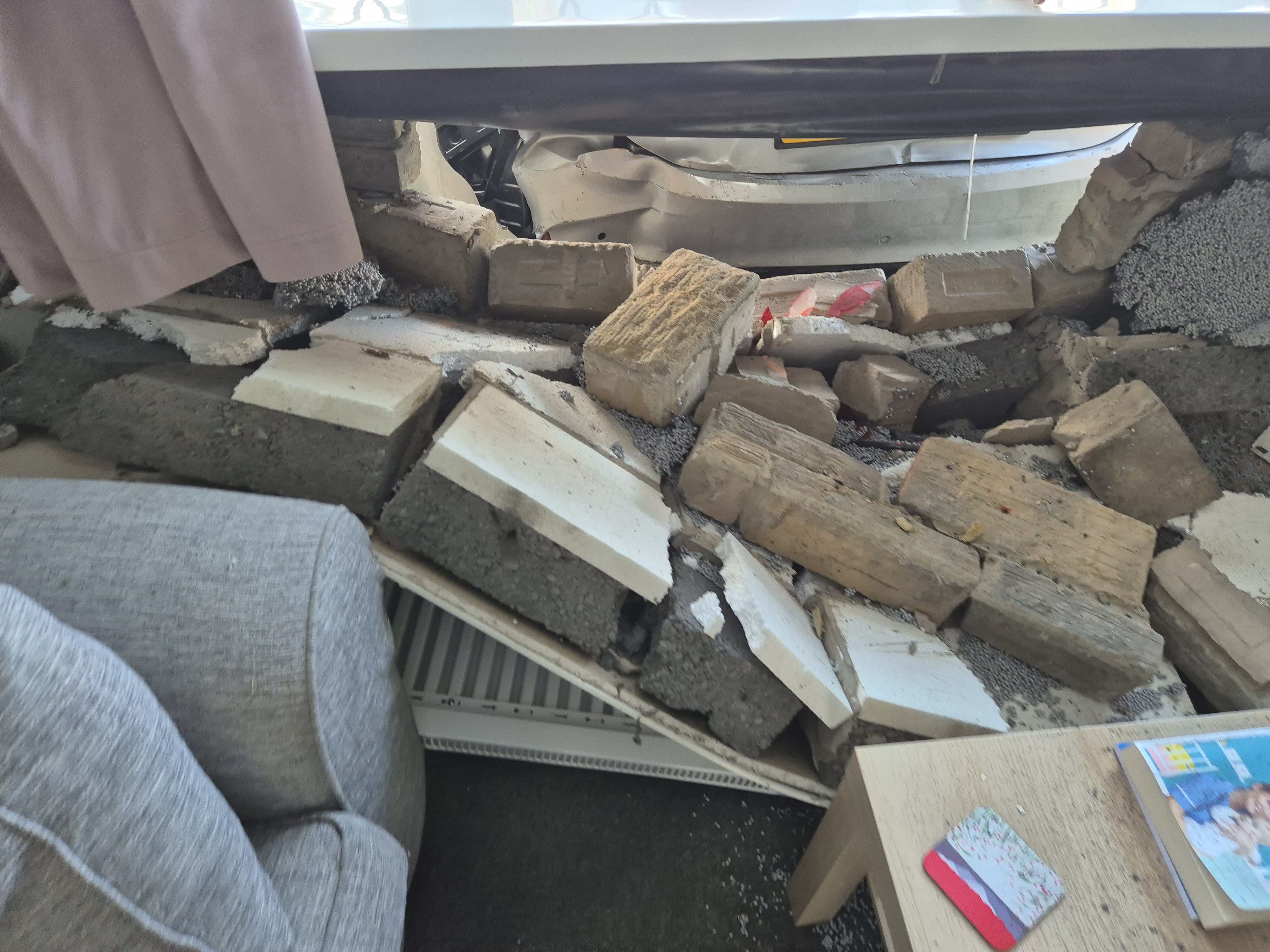

December 8, 2025Dec 8 Currently under going a home insurance claim due to impact. A neighbours brand new car was reversed into our front room. The insurance company are saying that the bricks of our house are unusual and hard to source? Can anyone confirm this is the case please?
December 8, 2025Dec 8 They’re ‘stones’ not bricks. But first you need to rule out whether they’re stone cladding or solid stone. Any loose enough to remove? As far as a claim, you should ask for a stone mason or very good Bricky to say if these can be picked out whole, cleaned and reinstated. A new area will likely stick out like a sore thumb.

December 8, 2025Dec 8 Author 1 hour ago, Nickfromwales said: They’re ‘stones’ not bricks. But first you need to rule out whether they’re stone cladding or solid stone. Any loose enough to remove? As far as a claim, you should ask for a stone mason or very good Bricky to say if these can be picked out whole, cleaned and reinstated. A new area will likely stick out like a sore thumb. See this pic. They are bricks come stones? Interesting you say that. Arguing on the repairs at the moment as they say they aren't able to replace them. And as for spec savers he has been charged with careless driving.... although he now has a Corsa on his drive. He managed to write off a 75 plate MG with less than 10 miles on the clock!
December 8, 2025Dec 8 They are most likely immitation stone bricks, often cast from concrete in a mould with colouring. Bradstone was a well known manufacturer about the time that house was likely built, I don't know if they still exist. As above, you will be far better off getting the builder appointed to rebuild this, to salvage as many as possible of the original bricks for the outer face as possible, any new ones should be interspersed rather than having a patch of new. But don't let anyone tell you they are not available, they will be from somewhere preferably any "new" ones needed will be reclaimed and similar age / weathering. It will be an insurance claim so make sure you have a loss adjuster / surveyor on your side to make sure it gets rebuilt to your satisfaction.

December 8, 2025Dec 8 Interesting to see they have used what looks like a mix of 30mm eps board and blown graphite eps beads to insulate the wall. I would guess the car is an auto or EV.
December 8, 2025Dec 8 4 minutes ago, Mr Punter said: Interesting to see they have used what looks like a mix of 30mm eps board and blown graphite eps beads to insulate the wall. I would guess the car is an auto or EV. House has prob been retrospectively blown in with beads on the external walls. Probably a cold room too, with that horizontal radiator …..
December 8, 2025Dec 8 1 hour ago, Nickfromwales said: Probably a cold room too, with that horizontal radiator ….. It is now with a big hole in the wall.
December 8, 2025Dec 8 2 minutes ago, ProDave said: It is now with a big hole in the wall. My apologies, I hadn’t noticed that Prob best to stop this before we get shouted at 👀

December 8, 2025Dec 8 9 hours ago, Nickfromwales said: A new area will likely stick out like a sore thumb. As @ProDaveI'd guess these are cast concrete in stone effect. And that your chance of rebuilding 'as was' is tiny because there will be some damage. Even if new or reclaimed were available as substitutes then they would not match as batching or age will make them different colours or textures. So unless these are inherent to the house design, or you love them, you will need a much greater area replaced in new masonry. The repaired house must look as if it was original or the value will plummet. You may have to be very firm on this because insurance companies like collecting, not paying. The Loss Adjuster for your own insurer is likely to be helpful and professional on your behalf, especially as the other party will be paying. You need to see a formal proposal and they should have it approved by an independent professional and by building control. You'll get more help on here I'm sure. It is best to remain anonymous so don't post pictures of the whole house, but anything from outside showing the context (adjacent areas of wall) would help. Meanwhile, only if you want to answer, are you still living there or been moved out for safety and comfort?

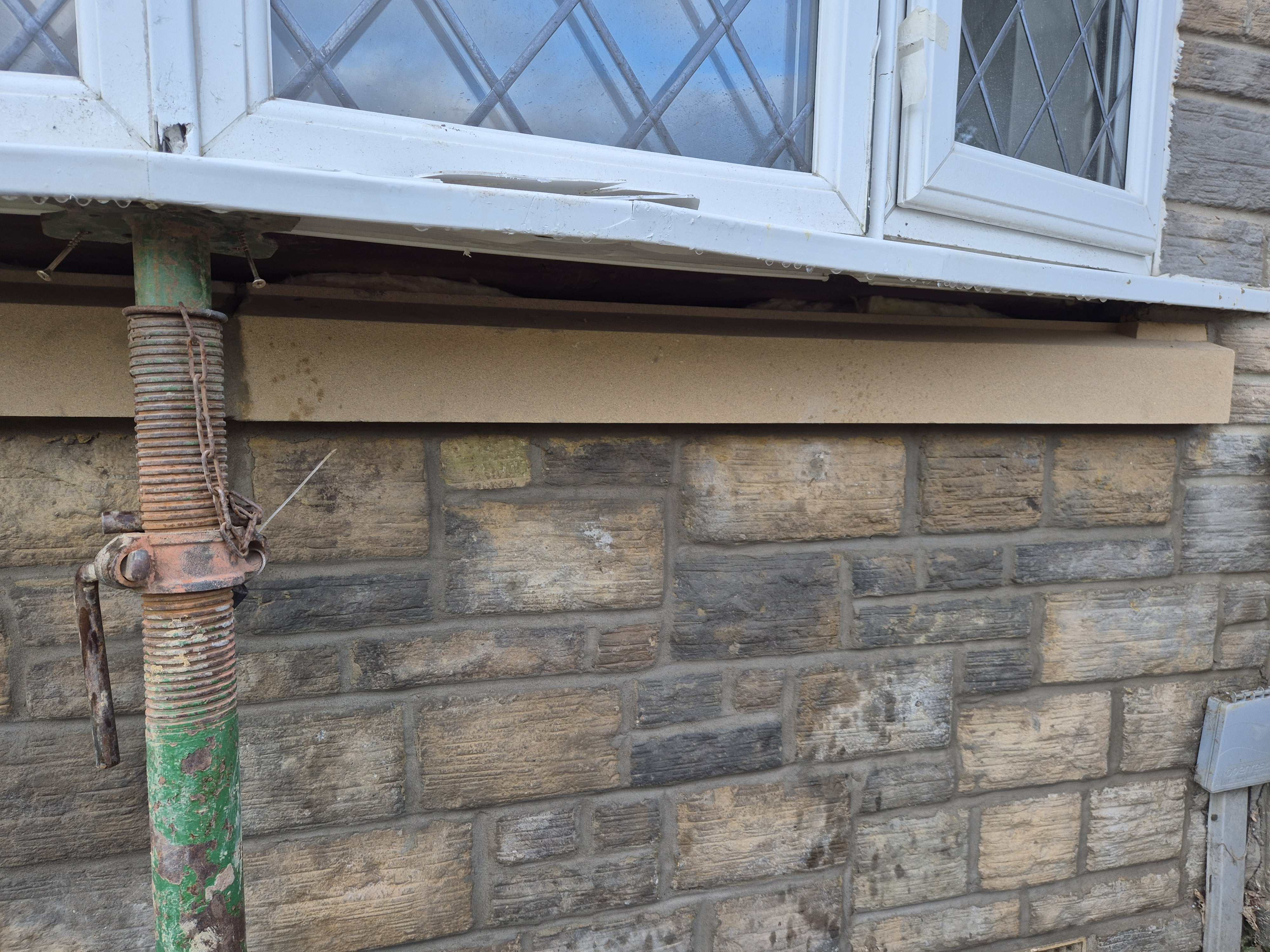

December 9, 2025Dec 9 Author Thanks for this reply. They have actually managed to re build most of the wall with the bricks that were already there. They have then used a company called brick doctor to match some other bricks. The above picture is actually it repaired. I just had never thought of the bricks as being unusual although I haven't seen another property like it. Yes we had to move out- thats a disaster as well as they only provided suggested flats miles away from where we currently live. All being well we should be back in next week. But minus a setee 😂
December 9, 2025Dec 9 20 hours ago, mills705 said: "They have then used a company called brick doctor to match some other bricks. The above picture is actually it repaired. " If you mean the picture I have re posted is the repair? If so the brickwork looks good, BUT before you agree to sign it off as complete, something needs doing to fill the huge gap between the (pretend) stone cill and the bottom of the UPVC bay window.
December 9, 2025Dec 9 Author 1 hour ago, ProDave said: "They have then used a company called brick doctor to match some other bricks. The above picture is actually it repaired. " If you mean the picture I have re posted is the repair? If so the brickwork looks good, BUT before you agree to sign it off as complete, something needs doing to fill the huge gap between the (pretend) stone cill and the bottom of the UPVC bay window. Thanks for the help. This was before the whole window was replaced with a new window and frame including the top bit as its a fake bay window. The reason for the ask was that one of the bricks not included in the picture attached had a hairline crack in it. They used a service called the brick doctor to repair the brick instead of replaced as they said their brickie couldn't source the bricks. I was surprised so wanted to ask
