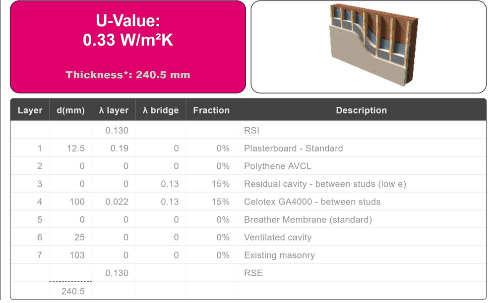

Detail of IWI on single skin / half brick wall for picky building control
We are insulating our conservatory to bring it into the heated envelope of the house and was going to use the SWIP system but our building control won't approve of it as SWIP have their BBA certification done on a double brick wall rather than just one brick. It is also rather expensive with not great insulating performance but I was prepared to take that hit but I just feel deflated by the retraction of approval from the BC.
So I am abandoning the idea of having a vapour open insulation and will go with a more traditional PIR insulated wall. But to make them happy, I need to submit a detail of what we are going to do. What I want is something similar to the one below from Kingspan but I want it to be PIR manufacturer agnostic or from a manufacturer that doesn't charge £350 for two sheets of insulation. I really like how simple it looks. Has anyone done this with Celotex GA4000, how do I do that and make BC happy?
Alternatively, we could do the stud system based on below Celotex system (but this one seem outdated and cannot find an updated version). But using a timber stud wall like that, how do you create the distances needed to create the cavity, just blocks on treated timber?
Any help appreciated.

We are going to suggest as change to the following celotex soolution + another 25mm insulated service void behind the plasterboard which adds a tad more insulation. We are excempt of the u-value due to the limited floor space so don't worry about the non compliant u-value.

We have submitted to the BCO now with the timber wall solution from Celotex with the following layers + a VCL between the service void and 90mm studs instead of relying on taped PIR joints. What I'm thinking is that perhaps the service void could be turned 90deg (i.e. lying down) to reduce cold bridges and even make it easier for cables as they will run horizontally rather than vertically. I bet there are good reasons not to do it, but it seems reasonable when thinking about the thermal bridges.
