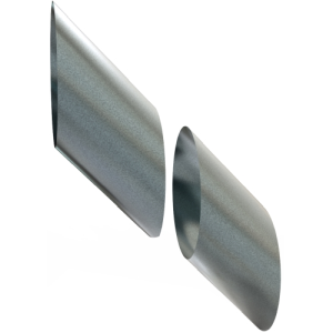

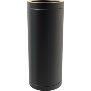

jimseng Posted December 7, 2025 Posted December 7, 2025 Hello. I have had a flue designed and I now have all the bits on site. The issue is the installer is now not available for some time and I really want to fit the flue through the wall to the outside before the insulation goes in. I haven't been able to get hold of the installer so I thought I would ask here. I have a timber frame building with 350mm Warmcell insulation. The installer has specified 2 45 degree bends and twin wall flue to pass through the bedroom wall to the outside of the house and then up. This means passing through plasterboard, intello membrane, Warmcell then through larch wood cladding. I have been supplied an expandable wall sleeve to surround the twin wall flue where it passes through the wall: This wall sleeve is barely wider internally to the twin wall flue which specifies a 50mm minimum distance to combustibles so I am confused as to how I maintain the minimum distance, unless I have mis-understood, or been supplied the wrong thing. Can someone advise? I'm trying to get all parts that pass through the wall installed before I seal up for the insulation.
