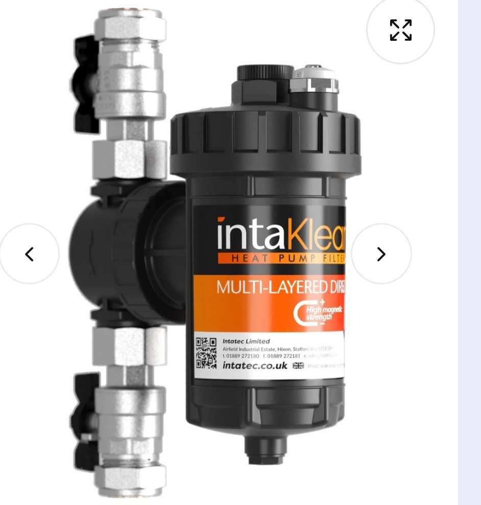

MikeSharp01 Posted November 29, 2025 Author Posted November 29, 2025 I think I have a full flow filter. It's this one: 1

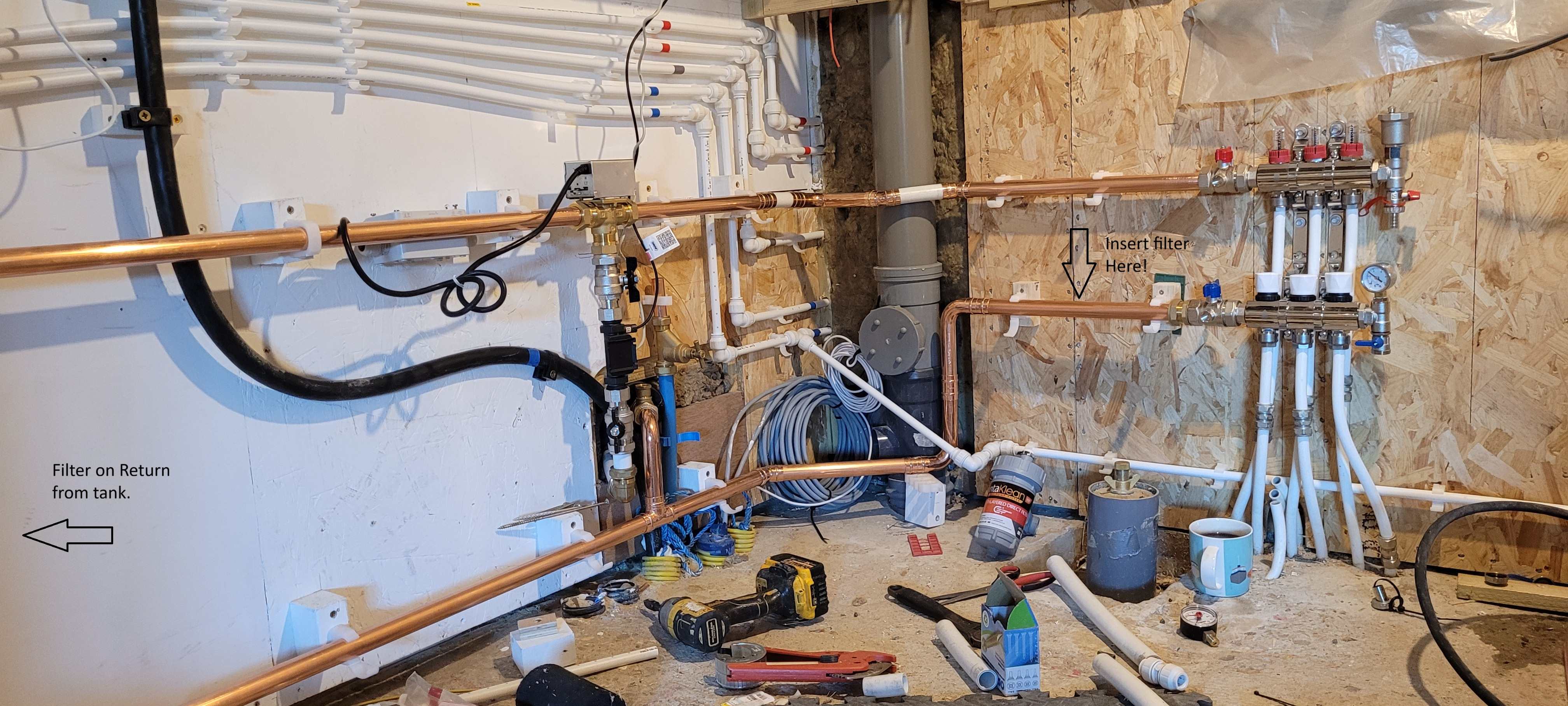

MikeSharp01 Posted November 30, 2025 Author Posted November 30, 2025 Here is the plant room mockup plumbing (used 28mm plastic segments to get lengths right and check scheme). I think I can get the filters into the utility room as indicated, I either do away with the fill flush or put it outside by the HP and work hard to insulate it.
JohnMo Posted November 30, 2025 Posted November 30, 2025 Can't you get a filter in the vertical on the return after the tee? Then you only need one filter/strainer. I would redo the tee before you go through the wall, to make space. Rotate tee horizontal, add filter, then loop up and out off wall or something like that. Your pipe is huge so no issue with pressure drops feeding 3 loops

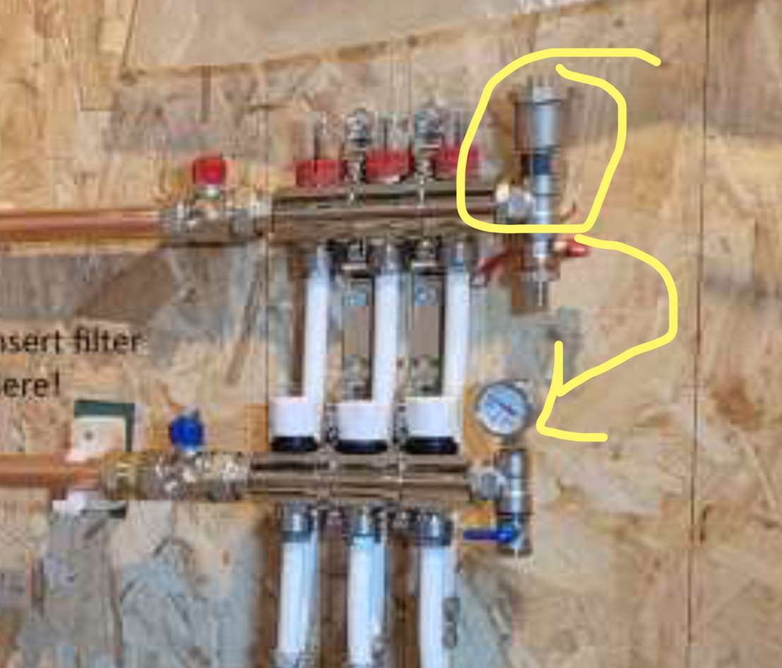

JohnMo Posted November 30, 2025 Posted November 30, 2025 (edited) You may have an issue with the UFH manifold return leg collecting air? You will need a method to bleed the lower manifold and the piping run going to it. Also the return line you need an expansion vessel and safety group, something like this, after the filter isolation valves https://www.unventedcomponentseurope.com/expansion-vessel-25-litre-heating-fixing-t-bar-system-kit.html/?utm_source=Google Shopping&utm_campaign=Copy Unvented Components Europe&utm_medium=cpc&utm_term=879559&gad_source=1&gad_campaignid=17178278874&gbraid=0AAAAADCTOYDo74Yo9HePQuEMKnbFqfg6s&gclid=CjwKCAiA86_JBhAIEiwA4i9JuybXCf4Z5_Ln7s1jNmeqsPnHSW3goCc-0aIt_EChTwzn0-N3iEqenxoC5xkQAvD_BwE Edited November 30, 2025 by JohnMo
MikeSharp01 Posted November 30, 2025 Author Posted November 30, 2025 1 hour ago, JohnMo said: I would redo the tee before you go through the wall, to make space. Rotate tee horizontal, add filter, then loop up and out off wall or something like that. Sadly that would require a complete redesign and there are loads of other pipes - mains water, water softener etc, running in those areas I have not installed yet so two filters is easier. 58 minutes ago, JohnMo said: You will need a method to bleed the lower manifold and the piping run going to it. I have the connections for that coming Monday to the far left of the straight run from the return manifold 1 hour ago, JohnMo said: Also the return line you need an expansion vessel and safety group, something like this, after the filter isolation valves That's already in the return line from the tank out of shot to the left. Its not 25l though it 8l which should more than cover the 70l of the system I worked out. 1

Nickfromwales Posted November 30, 2025 Posted November 30, 2025 Get another vent and swap the gauge out. You have one on the red expansion vessel control group where you fill / top up.
MikeSharp01 Posted November 30, 2025 Author Posted November 30, 2025 5 hours ago, Nickfromwales said: Get another vent and swap the gauge out. You have one on the red expansion vessel control group where you fill / top up. The thread on gauge does not appear to be standard, 1/8th BSP vent does not fit, I will talk to the suppliers and get a new end cap assembly as the flow head.
dpmiller Posted December 1, 2025 Posted December 1, 2025 does the adaptor not unscrew to leave a 1/2"?
Nickfromwales Posted December 1, 2025 Posted December 1, 2025 10 hours ago, MikeSharp01 said: The thread on gauge does not appear to be standard, 1/8th BSP vent does not fit, I will talk to the suppliers and get a new end cap assembly as the flow head. You just need to unscrew the bush too, which either leaves you with a 1/2 or 3/4” bsp thread. You then just buy the reducing bush for £2 and screw the vent into that. PTFE is your friend here.
SimonD Posted December 1, 2025 Posted December 1, 2025 On 30/11/2025 at 13:20, MikeSharp01 said: Here is the plant room mockup plumbing (used 28mm plastic segments to get lengths right and check scheme). I think I can get the filters into the utility room as indicated, I either do away with the fill flush or put it outside by the HP and work hard to insulate it. Ah, well. A picture says a thousand words! As @Nickfromwales suggests, you have no need for a fill and flush valve as you can use the filling ports on the ufh. I'd just suggest you add a valve on your mains for future filling and flushing maintenance of the primary circuit - you'll need to do this once you get the ashp in and running anyway. I know you say you're going with 2 filters as there isn't the space where the return goes through the wall. The only other suggestion I might give is to consider running the return from the cylinder back to the vertical return near the ufh manifold and then tee the return back to the HP from there, which would give you a longer horizontal run you fit just one filter. Not brilliant, but could work. 1
