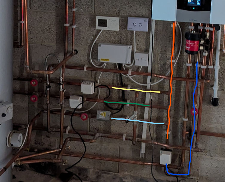

iMCaan Posted November 27, 2025 Posted November 27, 2025 Hi We have three heating zones of which groundfloor ufh is not heating up. All ufh components appear to be working fine. The boiler is working, it's heating up the water. The manifold side also appears to be working. However, the flow pipe to manifold/pump is always cold when the boiler has kicked in. So it appears the hot water is not reaching the manifold pump. The flow pipe from the boiler has 3 branches (one for each heating zones that are controlled by Danfoss motorised valves), attic (radiators), 1st floor ufh and groundfloor ufh. The motorised valves are close to the boiler. The attic and 1st floor zones work as they should. When they request the boiler comes on, the motorised valves open and the hot water starts flowing to those zones and the rooms warm up. The water is hot either side of those motorsied valves as it should be. Now the mind boggling bit. Whether the groundfloor heating zone (motorised valve) is open or closed, the flow pipe on both sides of the motorised valve are COLD but ONLY the branch part of the flow pipe, which is about a foot long. Nothing else is between motorised valve and the boiler just like other branches. The rest of the flow pipe from the boiler to the other motorised valves are hot (untouchable). The groundfloor ufh branch is the middle branch. How could it be that only the branch is cold but the rest of the flow pipe is hot? Thanks

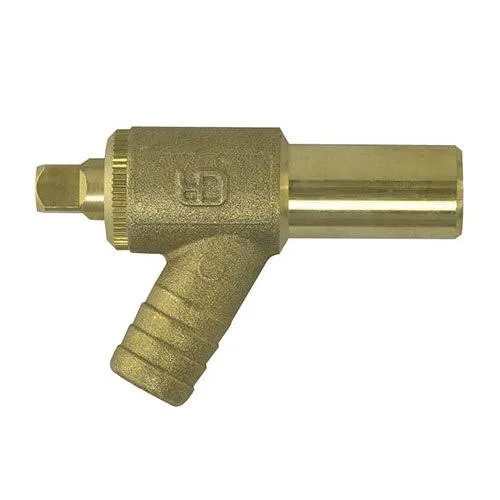

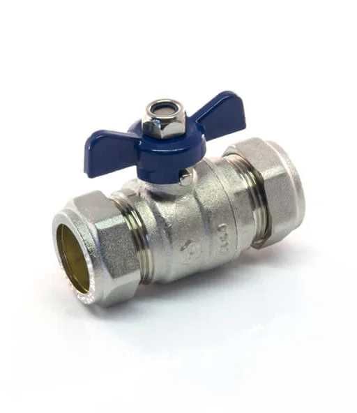

JohnMo Posted November 27, 2025 Posted November 27, 2025 1 hour ago, iMCaan said: motorised valve is in auto position and lever can be manually moved to auto or manual position Remove actuator from valve and truly to rotate the valve with your finger. It should be easy to move. Manual valve is an isolation valve, so likely to have a handle on it. May look similar to this Do you have any drain valves upstream of the UFH but after the motorised valve. Will look like this?

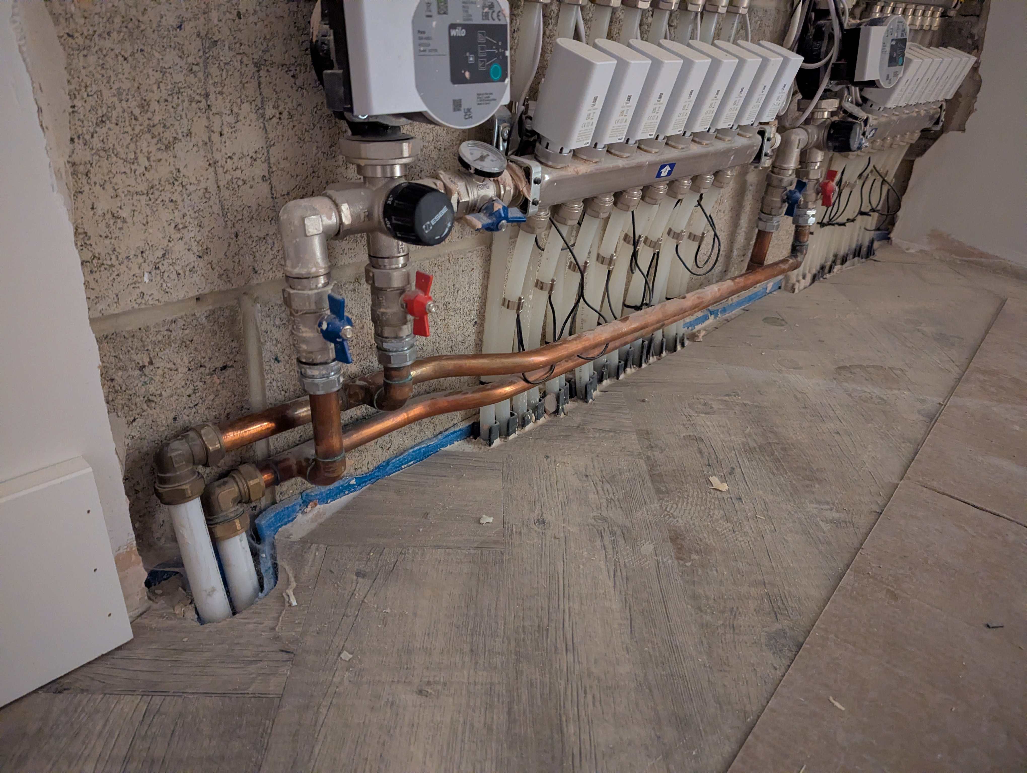

ProDave Posted November 28, 2025 Posted November 28, 2025 Question. Has the downstairs UFH ever worked properly? i.e. are we trying to solve a fault (it used to work but has stopped working) or is it a new install that has never yet worked on the ground floor? Post some pictures of the ground floor UFH manifold please.
iMCaan Posted November 28, 2025 Author Posted November 28, 2025 It's a Danfoss motorised valve with a manual and auto setting. It's set on auto. Yes, there's a drain valve. Orange - Flow pipe from boiler Yellow Radiators - branch 1 Green Groundfloor UFH - branch 2 Blue 1st floor UFH - branch 3 Light Blue hot Water

iMCaan Posted November 28, 2025 Author Posted November 28, 2025 3 minutes ago, ProDave said: Question. Has the downstairs UFH ever worked properly? i.e. are we trying to solve a fault (it used to work but has stopped working) or is it a new install that has never yet worked on the ground floor? Post some pictures of the ground floor UFH manifold please. It's a new UFH system. I would say it has never worked properly. Nothing has changed since it was commissioned. It has heated the rooms before but we never had it on continuously as we haven't moved in yet. The photo was taken a few months back but nothing has changed in this system.

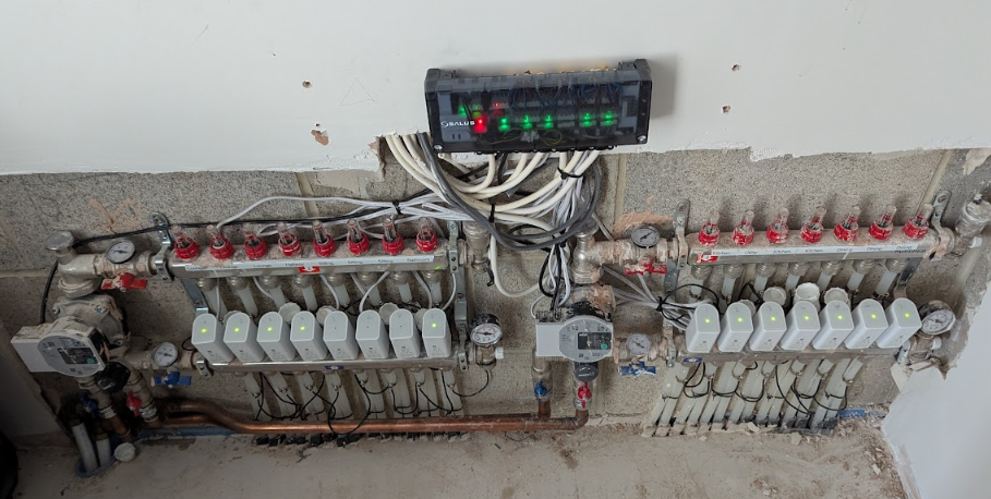

ProDave Posted November 28, 2025 Posted November 28, 2025 14 minutes ago, iMCaan said: Can we have a closer / clearer picture of the jumble of pipes coming out of the floor bottom left of the photo. Following the copper pipes between the 2 manifolds, the left manifold has the hot pipe connecting to the right hand manifold cold. These are the flow and return to / from the manifold. So either one is connected with flow and return swapped (which is wrong) or they are connected in series, which I have never seen before.

iMCaan Posted November 28, 2025 Author Posted November 28, 2025 (edited) Have loads of old installation photos but not of the finished installation. Will share the photo later. Edited November 28, 2025 by iMCaan

iMCaan Posted November 28, 2025 Author Posted November 28, 2025 Here is the clearer photo of the ground floor manifold
iMCaan Posted November 29, 2025 Author Posted November 29, 2025 I turned off the ufh and let the flow and return pipes to cool down. Then I turned the heating on in one of the rooms. The boiler kicked in. The return pipe became hot first. Did this three times and on all three occasions the return pipe became hot before the flow pipe. When I left it on for a while, the return pipe appeared hotter than the flow pipe. The thermal camera was not useful so used tmy hands to feel the heat in the pipes. So it's clear the return and flow need swapping. Will see what the heating company says next week.
ProDave Posted November 29, 2025 Posted November 29, 2025 Looks like you have identified the problem. Now lets hope they agree and swap the pipes over. Keep us posted how it goes.
