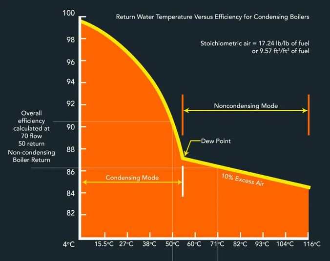

Seriously if a boiler is running more cycles than 3 per hour it's likely to be losing efficiency
I did once count my old boiler doing 10 cycle in 1 hour it's one of the reasons it's now recycled into bean cans...................
If a boiler is running on a 70 deg flow temp it very unlikely to be gaining much at all in condensing efficiency 88 or 89% at best
Get the flow temp down to below 55 Deg for CH and it's going to be condensing all the time and in the 90's from an efficiency point
