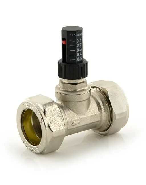

11 minutes ago, Munchincocopops said:
agree boiler pumping to dead end does not seem right...but
Your system will have either a valve like this, this is to prevent pump dead heading
Or you will have a radiator always open - bathroom or hall?
Resulting in a lot hotter water returning to the boiler if the bypass has opened due to system pressure being higher than the bypass is set to

4 minutes ago, Munchincocopops said:
Yes forgot....I have 2 ensuite bathrooms without Trv's and a main bathroom with cast iron radiator and trv.....all permanently on...i.e no motorized valve in circuit.
Bingo - so the heat is going somewhere
So if the boiler is firing and running for a short period of time you aren't going to get warm water back to the boiler very quickly the rads will take that without giving a higher return temp
If the boiler hits temp limit and shuts down then it's going to send "unheated" water round the circuit
What does surprise me is that the boiler doesn't shut down because the flow temp exceeds the return by a large margin - many boilers don't like to see difference between flow and return that exceeds 20 deg after a certain period of running.
Good example of this was my my old glow worm that faulted out if flow and return went above 20 deg after 5 mins - I had to run the downstairs toilet rad at a high flow to feed back return water to the boiler - the room quickly warmed up and the TRV shut down but by that time the boiler was getting a warmed return from all the other rads
