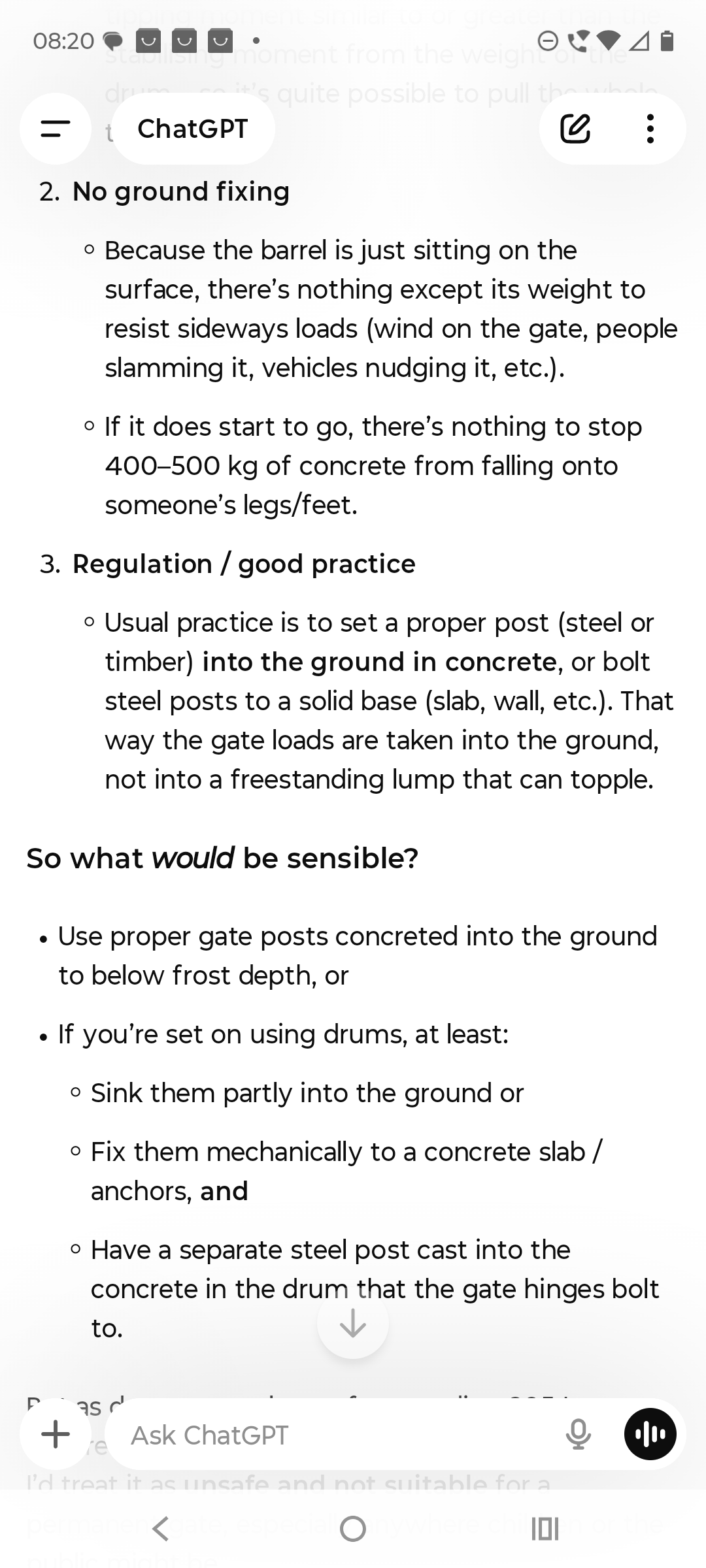

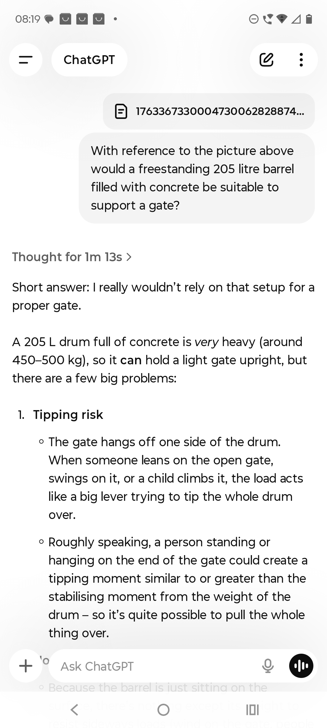

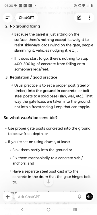

lord mud of the flyes Posted Sunday at 23:31 Author Posted Sunday at 23:31 38 minutes ago, markc said: Free standing gate? Rolling gate would be much easier than a swing gate in this case. as above, a 205l barrel filled with concrete will be around 500kgs, that doesn’t give you much unless it’s a light gate, quite narrow or end of gate runs on a support wheel. I dont understand what you mean; can you draw a diagram please
lord mud of the flyes Posted Sunday at 23:32 Author Posted Sunday at 23:32 43 minutes ago, JohnMo said: The steel of the barrel. Just throwing ideas out there, you have your plan I'll leave to get it done. you are not surgesting that the wall of the barrel is going to be strong enough are you?
saveasteading Posted Monday at 07:44 Posted Monday at 07:44 2 x half gates will be more stable Quick sum. All approximate. 45 gallons, 200 litres. Concrete is 2200kg/m3. so 440kg. A big bag of ballast is 800kg. So with cement and water one bag will do 2 barrels, approx. If not quite, then chuck in some rubble. Presumably you will cut the tops off the drums.
lord mud of the flyes Posted Monday at 23:40 Author Posted Monday at 23:40 15 hours ago, saveasteading said: 2 x half gates will be more stable Quick sum. All approximate. 45 gallons, 200 litres. Concrete is 2200kg/m3. so 440kg. A big bag of ballast is 800kg. So with cement and water one bag will do 2 barrels, approx. If not quite, then chuck in some rubble. Presumably you will cut the tops off the drums. So if i mix a 800kg bag of ballast with a bag of concreate and water; you think it will set? and hold the gate hinges?
Onoff Posted Tuesday at 06:50 Posted Tuesday at 06:50 7 hours ago, lord mud of the flyes said: So if i mix a 800kg bag of ballast with a bag of concreate and water; you think it will set? and hold the gate hinges? It won't set particularly well and be a very weak mix if you're talking about a standard bag of concrete. For an 800kg bag of ballast you'd need x5 20kg bags for an 8:1 concrete mix or x10 20 20kg bags for a 4:1 mix. You might achieve a circa 500kg barrel weight with a well vibrated mix, probably a bit under.
saveasteading Posted Tuesday at 07:25 Posted Tuesday at 07:25 7 hours ago, lord mud of the flyes said: you think it will set? and No and no. You don't need us here to tell you all these basic things. The Internet will tell you the cement to ballast mix, or look at rhe cement bag, or ask at the merchants when buying 8 bags for starters. Report back on completion please. You didn't say why you couldn't dig a hole for a post. What will the gate be an opening in? Fence/ between buildings?

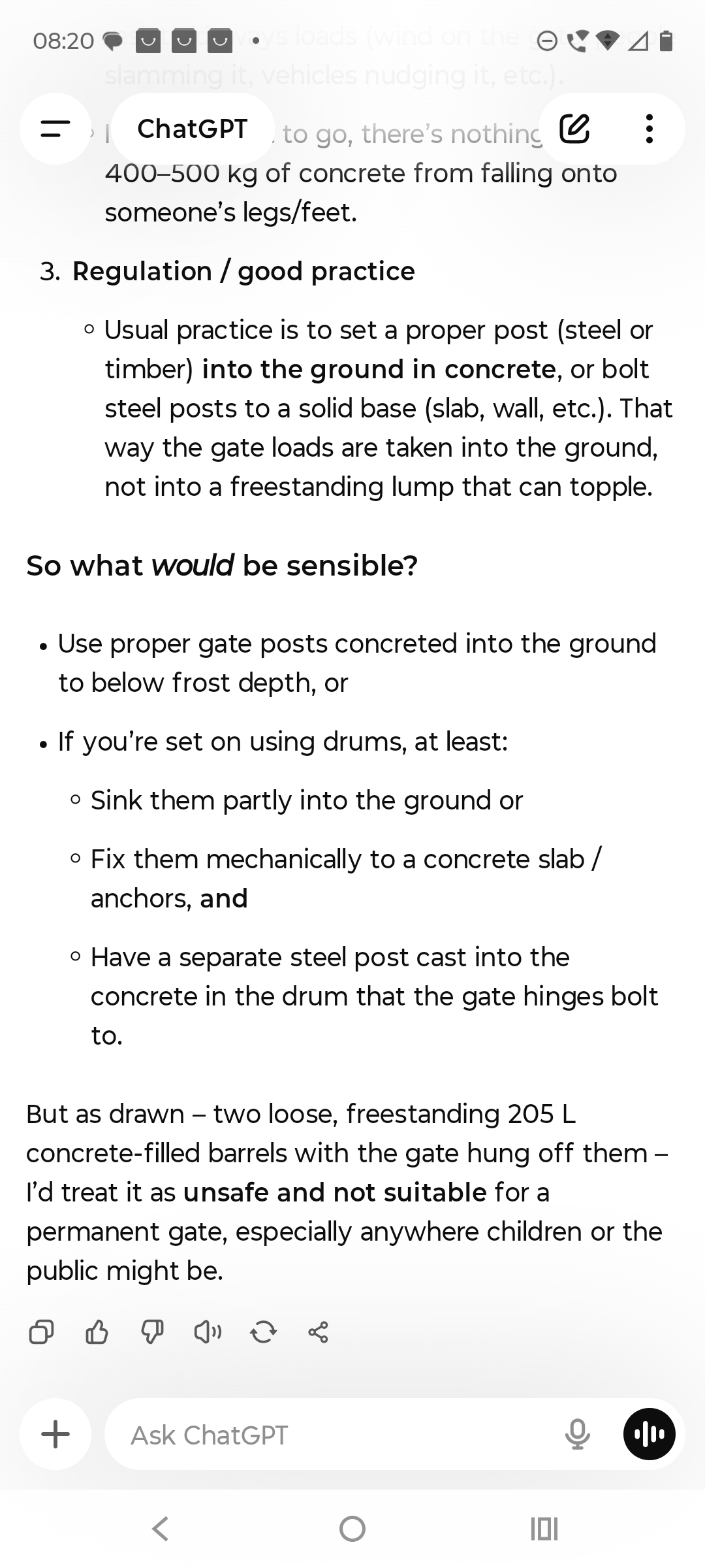

torre Posted Tuesday at 09:46 Posted Tuesday at 09:46 Posts set in the ground will be so much simpler and safer. Your drum will tip. If you really can't do that then for something temporary maybe drop a bulk bag of something cheap on each side and build a timber frame tight around it to support your gate. No need to mix concrete and you can reuse the MOT/sand etc later.
lord mud of the flyes Posted 18 hours ago Author Posted 18 hours ago On 18/11/2025 at 07:25, saveasteading said: On 18/11/2025 at 07:25, saveasteading said: No and no. You don't need us here to tell you all these basic things. Because it was you that said one bag of cement will do an 80KG ballas bag that is why
lord mud of the flyes Posted 18 hours ago Author Posted 18 hours ago On 18/11/2025 at 06:50, Onoff said: It won't set particularly well and be a very weak mix if you're talking about a standard bag of concrete. For an 800kg bag of ballast you'd need x5 20kg bags for an 8:1 concrete mix or x10 20 20kg bags for a 4:1 mix. You might achieve a circa 500kg barrel weight with a well vibrated mix, probably a bit under. So with the cement to ballest; what mix do I go for 8:1 or 4:1
lord mud of the flyes Posted 18 hours ago Author Posted 18 hours ago On 18/11/2025 at 09:46, torre said: Posts set in the ground will be so much simpler and safer. Your drum will tip. If you really can't do that then for something temporary maybe drop a bulk bag of something cheap on each side and build a timber frame tight around it to support your gate. No need to mix concrete and you can reuse the MOT/sand etc later. Digging not allowed! surly the weight of the motor should be enough to hold the gate
markc Posted 18 hours ago Posted 18 hours ago 6 minutes ago, lord mud of the flyes said: Digging not allowed! surly the weight of the motor should be enough to hold the gate Motor? 1
Onoff Posted 15 hours ago Posted 15 hours ago 3 hours ago, lord mud of the flyes said: Because it was you that said one bag of cement will do an 80KG ballas bag that is why No he didn't say that at all. No offence but you come to this with seemingly zero concept of what is to most a basic understanding of how you mix concrete and the ratios. You're being given good advice. I'd suggest you listen / take it. You risk people ignoring you. "2 x half gates will be more stable Quick sum. All approximate. 45 gallons, 200 litres. Concrete is 2200kg/m3. so 440kg. A big bag of ballast is 800kg. So with cement and water one bag will do 2 barrels, approx. If not quite, then chuck in some rubble. Presumably you will cut the tops off the drums". 1
