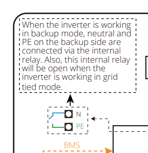

jimseng Posted Wednesday at 11:05 Posted Wednesday at 11:05 Hello. I think I will have my inverter up and running way before I get round to getting the grid hook up on my new build. I assume this means I need an earth neutral bond and a ground spike to start with. Is this correct? In the long term I see that Sunsynk inverters have an internal relay to achieve this but I can't find one mentioned in the Growatt manual. I just thought I would ask for any pointers when I get round to installing this. Once I have the grid connected how would I go about setting this up for grid power failure? Thanks

jimseng Posted Wednesday at 16:33 Author Posted Wednesday at 16:33 (edited) Quote In your first post you asked "Once I have the grid connected how would I go about setting this up for grid power failure?" That doesnt sound like a plan to me! What I am asking is what is needed in terms of earth neutral bonding as the Sunsynk manual states there is an internal relay to bond the earth and neutral when the grid shuts off in event of a power cut and the Growatt doesn't specifically mention this. There is a lot of talk about earth / neutral bonding but it is hard to distinguish what is for the American market and other countries and what is required for the UK. I'm not sure I understand how my first post suggests I don't have a plan. I think I am mis-understanding something. Can you explain? Edited Wednesday at 16:34 by jimseng

Mattg4321 Posted Wednesday at 21:30 Posted Wednesday at 21:30 The Sunsynk has an iirc 230v output that is triggered when the inverter is in islanding mode. This doesn't serve as the neutral-earth bond. You need to connect the output to the coil on a separate relay that will make the neutral-earth bond. An earth rod will also be needed if this is a grid connected system. Don't expect to find any explicit regulations in BS7671 as to how this should be done exactly, as they don't exist. Any circuits that you want to be able to use in islanding mode/off grid, need to be connected to the load terminals on the inverter. You really need someone who knows what they are doing to connect this up. 1

jimseng Posted Wednesday at 23:41 Author Posted Wednesday at 23:41 @Mattg4321 The Sunsynk has an internal relay, that was why I asked this question and you have confirmed what I was thinking, that many inverters don't, and I do need to fit my own system for this, probably if I go for the Growatt. I'll investigate.

jimseng Posted 21 hours ago Author Posted 21 hours ago Quote Is that to stop any chance of voltage leaking back down the grid when there is a fault? I'm actually struggling to get to the truth! It seems from what I have read that professional installers don't get this right either. In the Sunsynk manual I read this to mean that the Sunsynk inverter internally bonds the earth and neutral on the load side when the gird fails as the DNO bond is lost. Although in the same manual it states (as Mattg4321 has pointed out) that the inverter provides a 240v connection to drive an external relay to achieve this...So which is it Sunsyk? Growatt do the same but the 240v signal is present when on grid and goes to zero on grid failure. (So one has to choose a NO or NC contactor accordingly.) It seems that one can link the grid DB and backup load DB neutral together and use the permanent DNO bond. This is fine until the DNO earth neutral bond fails and any local bonding inadvertently serves as the bond for the entire local infrastructure. Although it seems this is only a problem in countries where people steal the cabling. I'm still working through it but it seems I will likely go with the Growatt due to budget and fit an external contactor to provide the E/N bond in the event of grid power failure.
Alan Ambrose Posted 15 hours ago Posted 15 hours ago >>> a ground spike You should have one anyway while you're building and in some instances (car chargers etc) afterwards too. My DNO put a label on their feed to that effect and refused to connect up their own earth. >>> Is that to stop any chance of voltage leaking back down the grid when there is a fault? No, it's so you have an earth/neutral bond in both cases and never two bonds. It's not totally clear to me why two bonds would be a problem, but it's just possible that would risk some extra leakage current. >>> AC coupled will provide whole house with power. I guess it's possible to only power some circuits if you like - and that strikes me that's a useful option e.g. power to the whole house except the really heavy users: HP, car charger, oven etc.
Mattg4321 Posted 12 hours ago Posted 12 hours ago You won't necessarily have an earth rod anyway as it's not mandatory. Not even for EV chargers now as most have built in PEN fault protection, meaning earth rods are not required as long as you meet other regulations. Neutral - earth bond is necessary for the proper operation of RCD protection. Stopping the voltage going back into the grid is a separate issue. Hybrid inverter can do as many circuits as the power of the inverter will be able to run. Nothing to say it can only operate a single circuit. I wouldn't take what Sunsynk say as gospel. They are certainly not experts when it comes to electrical installation - I've seen that Keith on their videos do some fairly dodgy things! Also, I seem to remember that some of their inverters will require NO and some NC relays!! FYI Sunsynk are rebranded Deye inverters.
