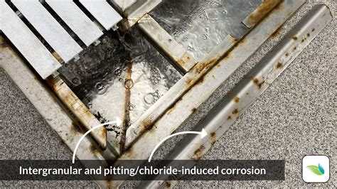

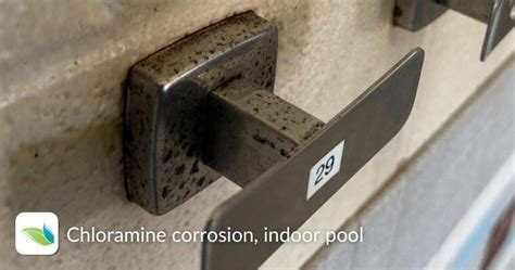

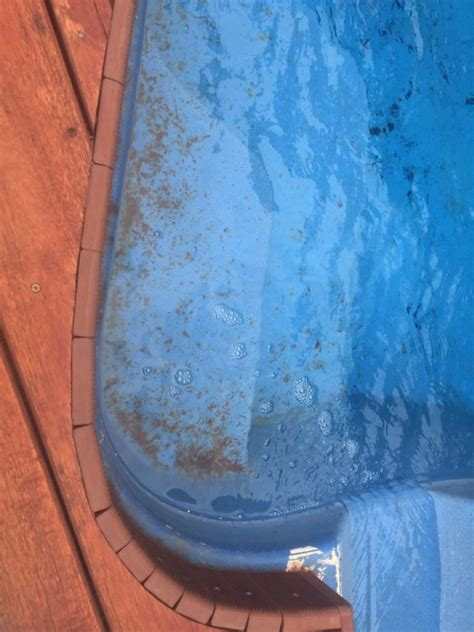

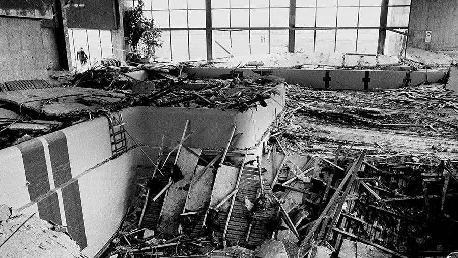

SteamyTea Posted November 10, 2025 Posted November 10, 2025 10 minutes ago, Nickfromwales said: Levels of chlorine for a domestic pool are only a few notches up from drinking water tbh. Were you on the material spec team for Pellikaan when they built St. Albans Leisure Centre, within a few weeks they had to rebuild the place. Not sure what pools you go in, possibly brominated ones that smell a little less, but still corrosive, or ones where the pH is too low and it is converting the chlorine to Hypochlorite. People think swimming pools are easy to look after. Some random pictures. And the classic.
