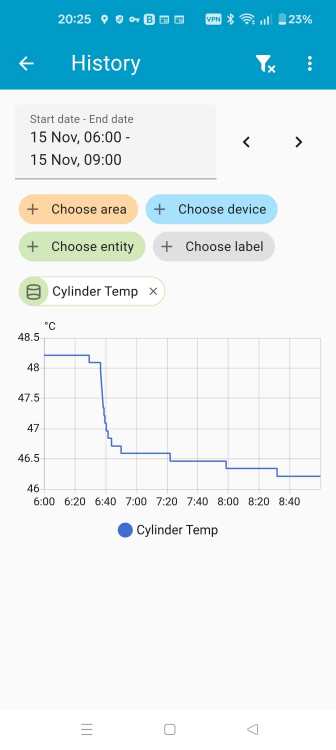

You can when building a house put pipes with in insulation etc. you can also use thermostatic and timer control so little or no impact on house temperature, any time of the year. Ours runs for 2 hours in the morning only and the pump only runs until the return temp hits about 35 degs. This is the impact on cylinder temp over a 3 hour period including two people using the sinks etc.
Switching on the tap and having immediate warm water is great, no waiting and endless water draw off.
Screenshot_2025-11-15-20-25-42-75_c3a231c25ed346e59462e84656a70e50.thumb.jpg.f0c15efdab962f348e9acd6f58bab857.jpg
