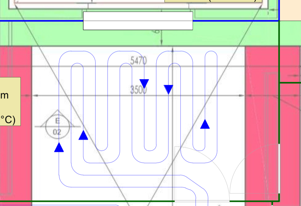

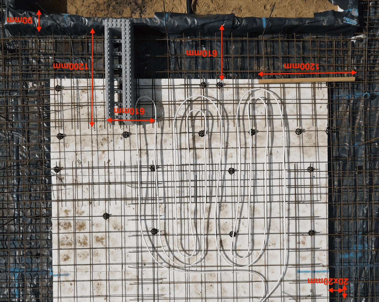

Nick Laslett Posted November 8, 2025 Posted November 8, 2025 (edited) 11 hours ago, Gus Potter said: The reason I often challenge is that folk are desinging the pipes in the floor with no redundancy, or recognising that what gets built on site may not actually be what is shown on loop cad for example. I’ve mentioned this before, but my ground floor UFH was installed with every pipe run being about 10m shorter than the loopCAD design, essentially missing at least one loop in each room. Unfortunately, even though I diligently took many photos of the install, I didn’t actually notice the shorter runs until many years after the foundation had been poured. One room is particularly bad. Don’t know what the installer was thinking. If you compare the picture to the design it makes no sense. Wrong loop pattern too. I was still very green at this stage of the build. Edited November 8, 2025 by Nick Laslett 1
saveasteading Posted November 8, 2025 Posted November 8, 2025 57 minutes ago, Nick Laslett said: I was still very green at this stage of the Such a good example of incompetence. I get your point. As a newbie you don't contemplate for a moment that supposed experts can be so incompetent. Can't read a drawing. Don't understand what they are doing or why it matters. Don't know how little they know. You don't dare question them or you get abuse, condescension or simply ignored. And now you deal with it how? 1
