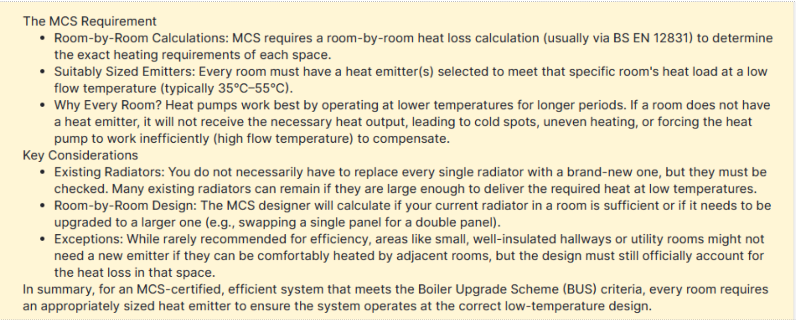

  2. Thanks @SimonD - appreciated. I have spent part of the afternoon reading the standard and yeah - it seems to me that you need to be able to heat all the rooms to the figures in Table 1 (18C for bedrooms and hallways). It does not require a heat emitter in every room.
  3. Tempting, but if I've learned anything in my self build adventure so far, it's not to be too ambitious about what I take on myself vs what I ask a responsible adult to help with.
  4. @SimonD That's a really helpful response - thank you. Unfortunately my installers have responded with this: "As with regard to the heating on the first floor have your acquaintances any further details of the library of standards as I have spoken to Ofgem and MCS as well as our umbrella scheme and they are all saying each habitable room needs to have a heat emitter. Happy to get our umbrella scheme manager to give you a call to discuss further and she is also happy to speak to your acquaintance if necessary. This is what I have been given:" ..see attached.

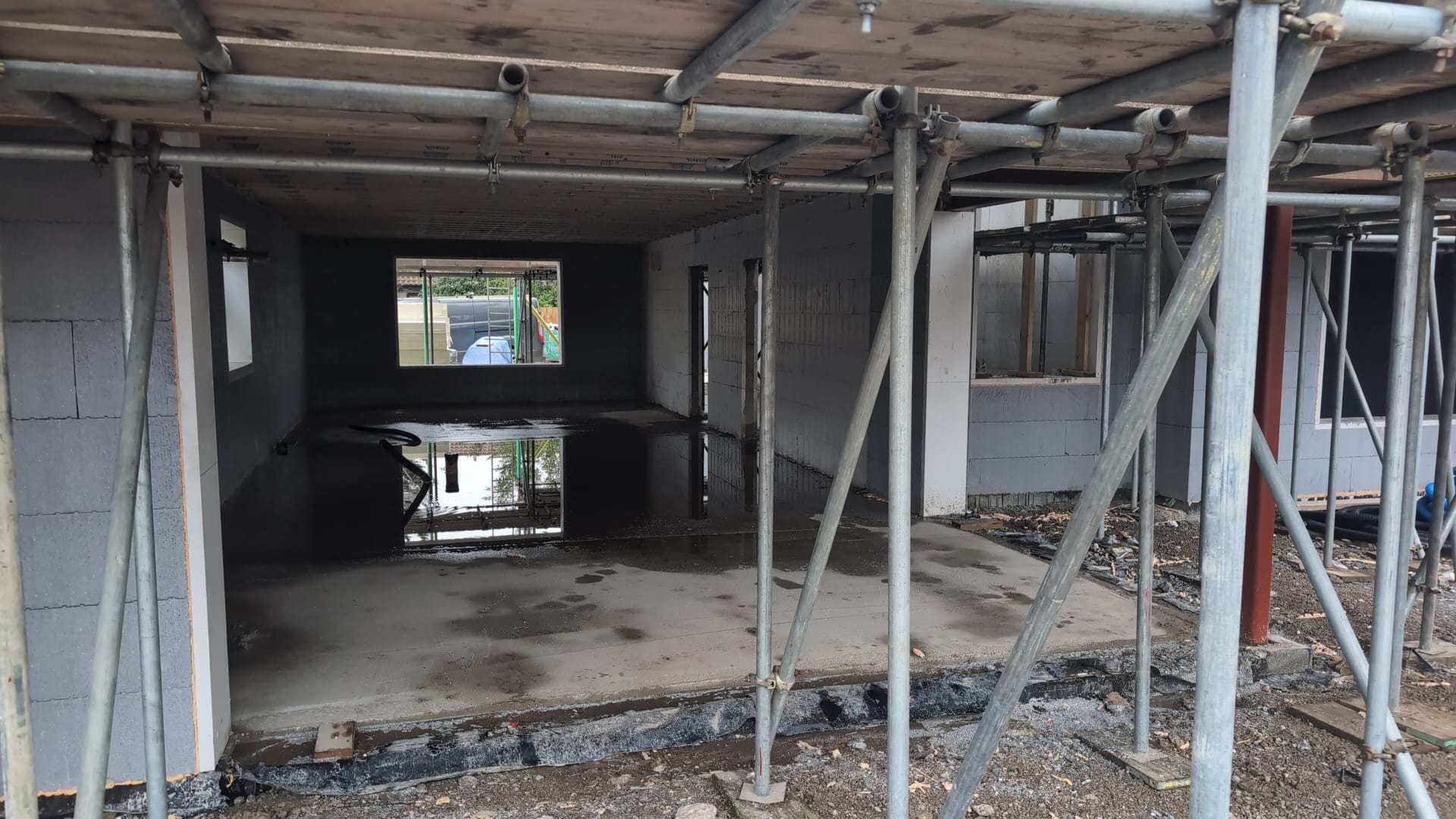

  5. Thanks - 4 weeks sounds like no problem. As soon as we have the temporary felt+batten on, I can pump/brush out the puddle. A 4 week lead time from getting the slab dry to having the screed in sounds much more reasonable than 250 days!
  6. This is the kitchen/diner, with the snug beyond. A stud wall will eventually separate the two rooms between the two doorways you can see on the right. The other half of the building is similar. Although the first floor is in, the roof is still under construction so that puddle isn't going anywhere, but it does show the dip rather well. Slab was poured 9th December so it's about 2 months old. Finish is currently tamped concrete, target finished floor is 25mm higher than the high spot with a premium vinyl tile.
  7. I have a 250mm thick RC35 fibre-reinforced, waterproof-admixed concrete slab that has a ~30mm dip in the middle so it will need a screed before a finished floor can go in. It has the underfloor heating already installed at the bottom of the slab, with a further 225mm of insulation underneath that. At some point soon I'll have a roof on and will be able to start drying the place out with a couple of rented dehumidifiers, and once the glazing is in and the plumbing is connected up I'll be able to fire up the UFH too. My question is - How can I know when slab will be dry enough to screed? I can get a cheap surface tested from screwfix, but that's not going to tell me the moisture content of the core of the slab. One screeding specialist was recommending simply waiting 1 day per mm, but I have 250mm!

  10. Ok, so in my 4 bed, 2-storey self build I'm having wet UFH installed at the bottom of the concrete slab, which sits on top of an isoquick passive slab. Walls are passive spec, roof is almost passive spec, ICF construction so airtightness will hopefully be <1. UFH and DHW all powered by an ASHP. Yay for acronyms! I was planning to put aircon in the upstairs bedrooms, electric UFH / towel rads in the upstairs bathrooms, and leave it at that. MCS are saying that in order to qualify for the £7500 grant the UFH needs to be in every room. Is this really the case? the aircon will be able to provide a small amount of top-up heating if required.
