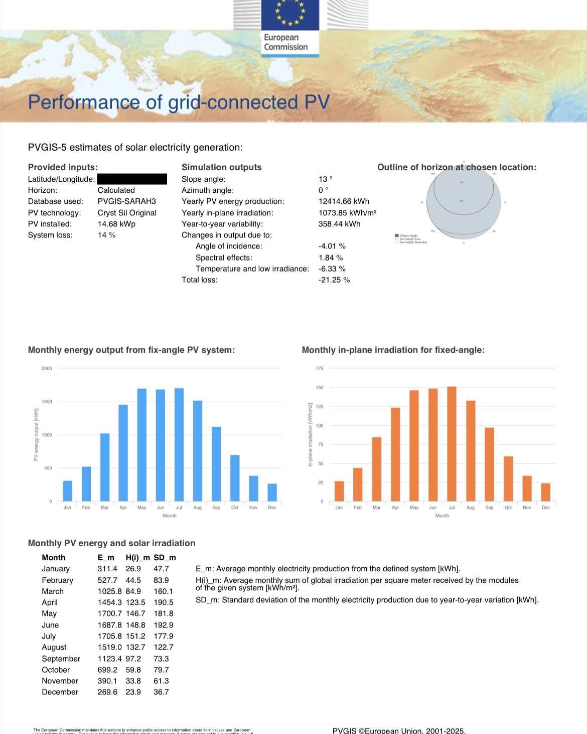

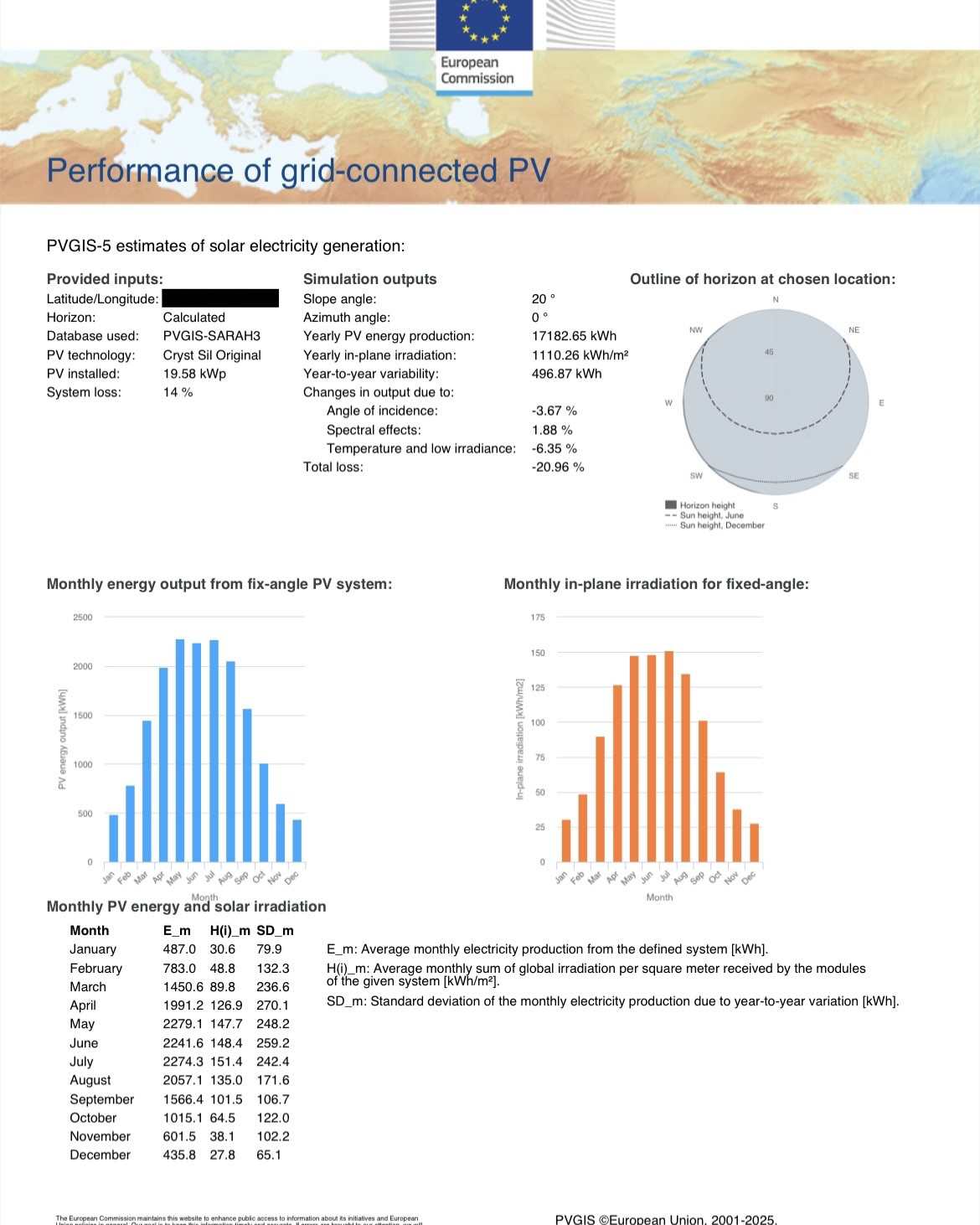

Maximising a 30kW array
Hello.
Part of my house plans is to construct whole new roofs. The back of the house faces almost directly south. I am at the edge of town. No shading anywhere in sight and most likely never will be. The solar potential is huge I’m told and don’t need any micro inverters, and can probably get away with installing one array on a single string reducing cable runs.
Winter sees the sun covering the entire rear of the house moving across the horizon nicely left to right.
Summer sees the sun rising at front left, moving around to the back and almost directly over the house, all way round to the front right as it starts to set.
I’d much rather cover my new roofs in PV panels than tiles.
Main roof facing south slope is 20 degrees.
Extension roof facing south slope is 12.5 degrees.
The other side of the main roof slope facing north is 35 degrees but I intend to keep that panel free for street appearance and it isn’t as large area wise.
I can comfortably fit 44 Viridian panels on the main, and 33 Viridian panels on the extension. This is as a starting point using 445W panels, can shop around but I do want an inline system.
I have prior DNO approval to have a 55kV 3 phase upgrade of incoming supply.
I am with Octopus on a basic tariff, can’t remember which, but told I can change later after I move in to the house as the property is currently vacant pending works so just standing charges at the minute.
I have mains gas. I want a system boiler setup to heat via wet UFH and provide DHW. No electric showers, they will run off cylinder/s.
I have a dedicated plant room to accommodate everything at ground floor level. Size approx 4x5m.
I do not want an ASHP.
I want some sort of battery. Can’t decide what size.
Most likely won’t go MCS certified route to install due to costs. And due to Octopus giving increased payments non MCS.
I will probably install 1 or 2 22kW EV chargers too. No EV yet, but post moving in I plan on upgrading the daily’s.
I’ve attached my PVGIS data, but I don’t know what to make of it.
I’m being advised the DNO will most likely allow a higher export limit beyond the 11.04kW of 3 phase I believe.
I’m being told I should oversize my water cylinder, dump excess solar into that. Forget batteries.
Im also being told I should simply export everything that’s not being used, and only have a small battery to keep power to run for 24 hours usage. It’s a waste to go any bigger.
I’m also advised I should forget getting 2 arrays, and focus on the main larger one only.
How would you make the most of this situation?
Blue graph is a monthly output average to expect in kWh. So some days will get very good output, wet rainy day almost nothing. Peak generation is in summer when you can use almost nothing you produce, so you export it, zero justification to have that many panels if you have no export agreement.
Yes I agree, which is why the size of arrays would be finalised once I get DNO confirmation of what I can export.

Before you do anything, check with your DNO what your max export is going to be. No point in having a big array but having to throttle it because you can't export it.
Thanks. That sounds like the plan of action. Confirm max export. Then based on that size arrays accordingly. Use what I need, charge cars etc, then export at max rate. Import overnight for DHW and batteries, and gas on demand for CH during the colder days.
