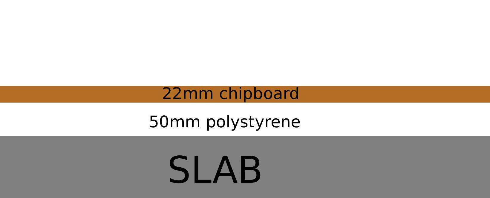

Nickfromwales Posted October 31, 2025 Posted October 31, 2025 OK!! Give us the depth you have to play with, from slab up to FFL please, as there's a lot of info but it's all a bit tricky to correlate. And why electric UFH? It's the most expensive thing you can run, and is this for supplemental heating or full-on space heating? 2
Gus Potter Posted October 31, 2025 Posted October 31, 2025 37 minutes ago, Nickfromwales said: Give us the depth you have to play with, from slab up to FFL please, as there's a lot of info but it's all a bit tricky to correlate. Agree with @Nickfromwales Is the floor separating two different dwellings? If you are adding load to the floor have you checked that is ok? A drawing would help a lot. You need to start with the basics and develop from there. You can maybe see it but for us it's difficult to comprehend as a complete floor design. If we can't understand it then little chance your builder will and the prices you get will reflect that. 1
Workerbee Posted November 2, 2025 Author Posted November 2, 2025 (edited) Thank you for the replies, and sorry for my poor explanation! It's a bungalow, and in terms of compressive strength I think any of polystyrene, PIR or XPS should be fine. I've done a crude drawing of what's currently there: The finish is currently carpet or tile. I'm basically just thinking of replacing the polystyrene with either PIR or XPS (ravatherm seems to have a decent lambda value), and replacing the chipboard with insulated tile backer board. This will mean I can bond everything together with suitable adhesive so that it's technically no longer floating, because the finish will be natural stone, which can obviously cause issues on a floating floor otherwise. I wondered if the ravatherm might have two benefits over PIR: would the fact it's not foil faced mean it bonds better? And more importantly does the higher compressive strength equate to lower vibration, or is that a separate characteristic? It's an all-electric house, so that's why I'm thinking of electric ufh. It'll probably be secondary heating, but given I'll be installing oil filled radiators it'll end up being just as expensive! Thanks again. Edited November 2, 2025 by Workerbee

JohnMo Posted November 12, 2025 Posted November 12, 2025 On 31/10/2025 at 22:09, Workerbee said: heat pumps aren't currently suitable for my property, What is the reasoning behind this statement. From what you describe you are going to need a big pay check to pay the heating costs. I would step back, post some details about your house and ask for suggestions Your proposal is going to end up a very poor performer and super expensive to run. Poor insulation in the floor (this is what you currently propose) when heating the floor is actually worse than no insulation in many situations. My solution would be ASHP, remove current floor to the concrete, egg crate panels (no insulation) and then 16mm UFH pipe at appropriate centre spacing. Screed. Then your stone floor finish. But do over whole ground floor. If you don't want that, dump the whole UFH project. And do your proposed plan for electric UFH only in bathroom on a timer. Then install modern storage heaters on E7 or better Octopus storage heater tariff.
