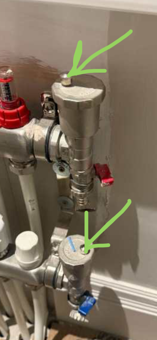

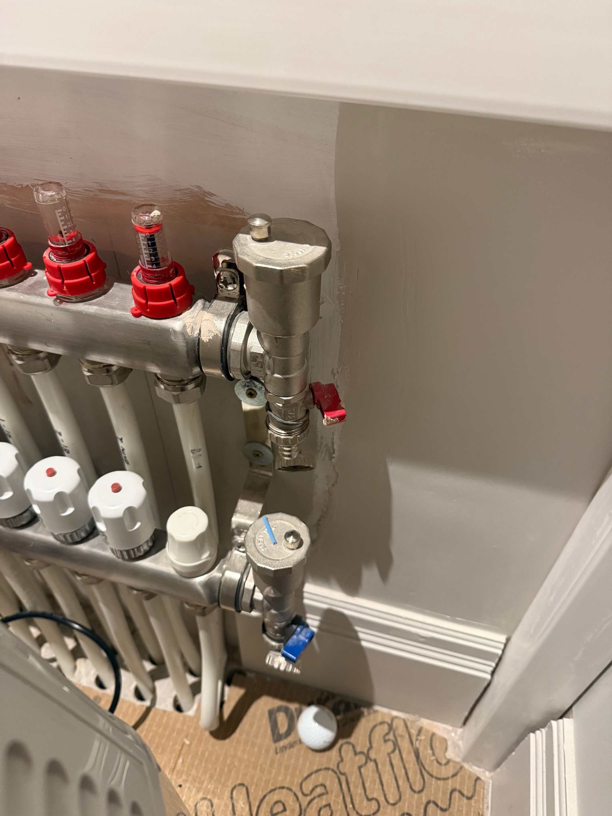

Nickfromwales Posted October 27 Posted October 27 2 minutes ago, richo106 said: I am not sure regarding the flow/return temps before any heat hit it sorry I have just check the flow temps again and no change just the 1 deg diff Please find attached pic of the air vent, to be honest i have to google to see what you meant by that! I have not touched it so any advice what to try I am all ears Those caps are like the ones on your car tires. They need to be ‘loose’ to work, so give them a ‘twiddle’ and see what the situation is there plz. Close them finger tight, and then open 2 full turns 720°, if unsure. Then they’ll be able to function properly and let ‘air’ out.
richo106 Posted October 27 Author Posted October 27 (edited) 9 minutes ago, Nickfromwales said: Those caps are like the ones on your car tires. They need to be ‘loose’ to work, so give them a ‘twiddle’ and see what the situation is there plz. Close them finger tight, and then open 2 full turns 720°, if unsure. Then they’ll be able to function properly and let ‘air’ out. They were both quite tight I have done that, tightened them and then I have backed them off 720 deg Edited October 27 by richo106
Nickfromwales Posted October 27 Posted October 27 4 minutes ago, richo106 said: They were both quite tight I have done that, tightened them and then I have backed them off 720 deg If they were tight, then they weren’t doing any venting. A box has been ticked. ✅
richo106 Posted October 27 Author Posted October 27 4 minutes ago, Nickfromwales said: If they were tight, then they weren’t doing any venting. A box has been ticked. ✅ Are these ok to leave ‘open’ then I am guessing. Do I need to manually purge each loop or if I have air locks will the auto air vents clear it all over a period of time?
Nickfromwales Posted October 27 Posted October 27 1 minute ago, richo106 said: Are these ok to leave ‘open’ then I am guessing. Do I need to manually purge each loop or if I have air locks will the auto air vents clear it all over a period of time? These should have been left open by the installer. They stay ‘open for life’ so they can look after you and let any ‘air’ out. 1

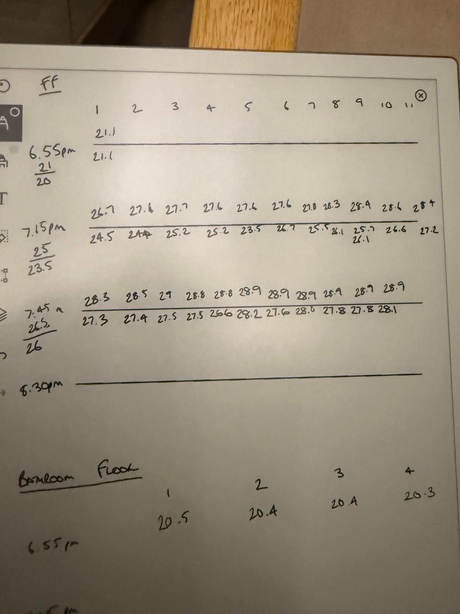

richo106 Posted October 29 Author Posted October 29 Update I have borrowed an IR camera to check flow and return temps of the FF manifold The heating turned on at 7pm I have recorded the temps at 7.15pm and 7.45pm, please see attached picture to show my findings There is definitely heat loss but not much I have also IR camera'd the carpeted floor and can see the heat lines, this was around 8pm and the temp of the heat was around 20.2 deg and the 'cold bit' was 19.6 deg There was no of any heat lines on the tiled floor in the bathrooms yet (there is downstairs but appreciate the floor make up is different) For this shows the water is getting round the loops at least One thought i have now is to take it off weather compensation curve and set the water temp to 35 deg, this will make the GF 'bounce off' the thermostats though. I am not sure this will make enough difference on the freezing cold days upstairs though Any other thoughts/ideas on my findings today would be grateful, many thanks
richo106 Posted October 29 Author Posted October 29 At 9pm I upped my water temp to 35 deg At 11pm I checked the flow and return temps on my FF manifold, average in was 32deg and return 31deg. So averaging around 1 deg heat loss My bathroom tiled floor has increased from 20.5deg to 21 deg from 7pm to 11pm I am not sure where to go next

richo106 Posted October 30 Author Posted October 30 7 hours ago, John Carroll said: 22LPM at a dT of 1C gives a UFH output of, 22*60*1/860, 1.54kW, pretty hopeless for a 11 loop system. Normally one might expect a dT of at least 4C/5C at a flow rate of 2.5LPM/loop even with a low flow temperature, this then gives, 2.5*60*(say) 4.5/860, 0.785kW per loop, in your case, ~ 8.6kW. Increasing the flow rate decreases the dT but should result in a greater output, but something definitely wrong when you are only getting a dT of only 1C. You also posted that when you shut down the GF that the FF flowrates almost doubled with the same dT, this, theoretically doubles the UFH output, can you post the total flow through the GF, can then look at the pump curve, if available, for that 8M ST pump, you might be able to get a suitable circ pump to give you 3.5/4.0LPM. How is the ASHP supplying the UFH, has it got its own pump? Yes I can understand the low dT, I checked the temps again this morning and loops ranged between 1-1.8 deg loss, but IR camera was bouncing around a little so hard to be super accurate I will turn off the GF manifold again so the the pump just feeds the FF to see what flow rates I can achieve per loop. currently the ASHP feeds a buffer tank and then pumped from there to both manifolds using a single pump. one thing that I want to try is not shutting my heating off during 4-7 during the expensive period to see if this makes any difference at all. I’ll just run my heating 24/7 on weather comp with thermostats set at 23.5 to stop overheating. do you think this will make much difference cost wise? It takes a large amount of energy to reheat the floors and buffer tank when it heats back up at 7 so hopefully it won’t be too much difference any thoughts on this would be helpful
