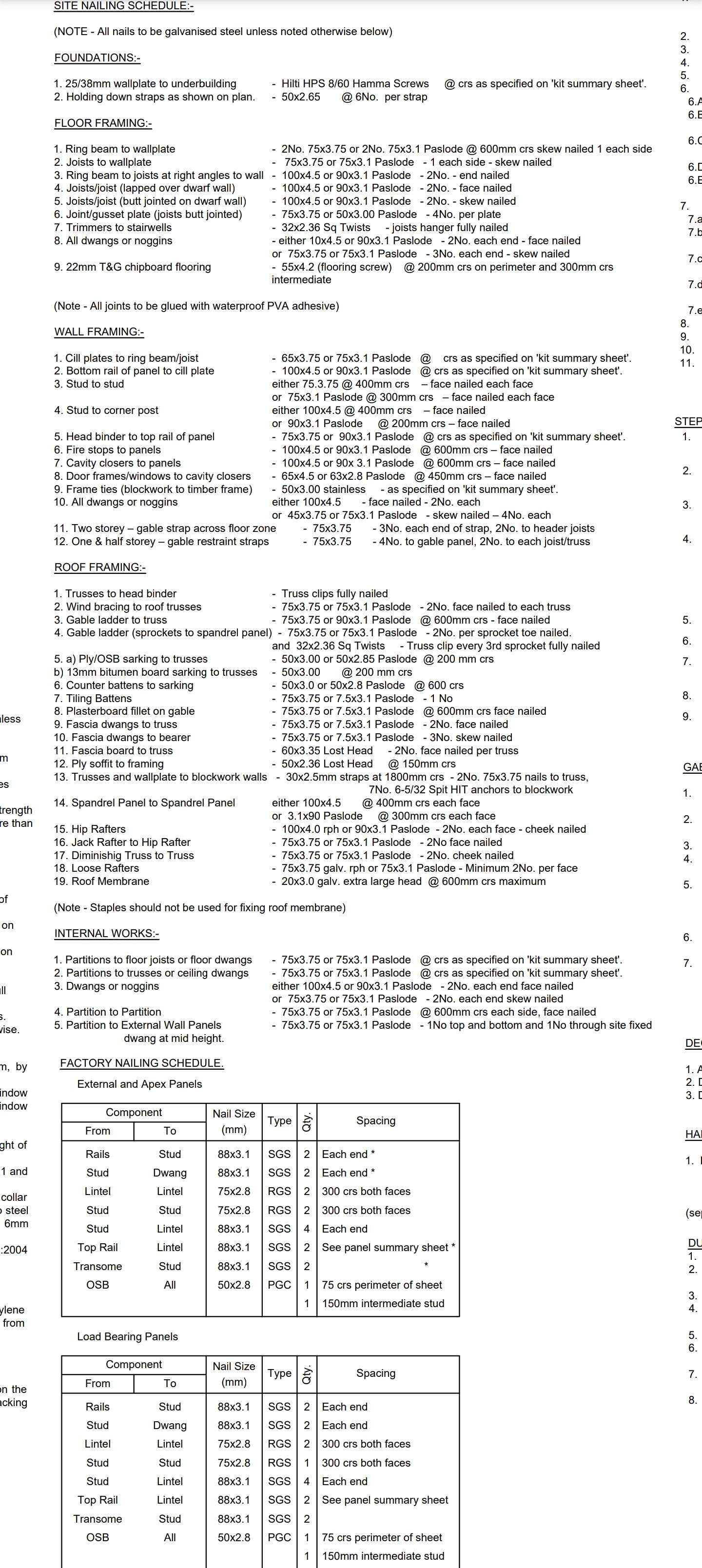

JohnMo Posted October 23, 2025 Posted October 23, 2025 If it's for anything structural stuff, your structural drawings notes, should set out the requirements explicitly. How many nails at each junction, type surface finish and length. Your structural notes should have something similar this - if they don't go back to your structural engineer and ask why not! 1

flanagaj Posted October 23, 2025 Author Posted October 23, 2025 14 minutes ago, JohnMo said: If it's for anything structural stuff, your structural drawings notes, should set out the requirements explicitly. How many nails at each junction, type surface finish and length. Your structural notes should have something similar this - if they don't go back to your structural engineer and ask why not! I chose the wrong SE (Barrat Associates). When I send full plans to a SE and request a quote for structural design, should I expect them to just provide structural calcs for the steels. That's all I received. There was nothing like the detail you have there.
JohnMo Posted October 23, 2025 Posted October 23, 2025 1 hour ago, flanagaj said: quote for structural design, should I expect them to just provide structural calcs for the steels We got a full structural design for whole house including the steel, walls internal and external, foundations, all house structural components and review and final approvals of any third party supplied equipment, including windows, roof, glass balustrade. Without the above you don't have a structural design for the house, just a lump of steel.
