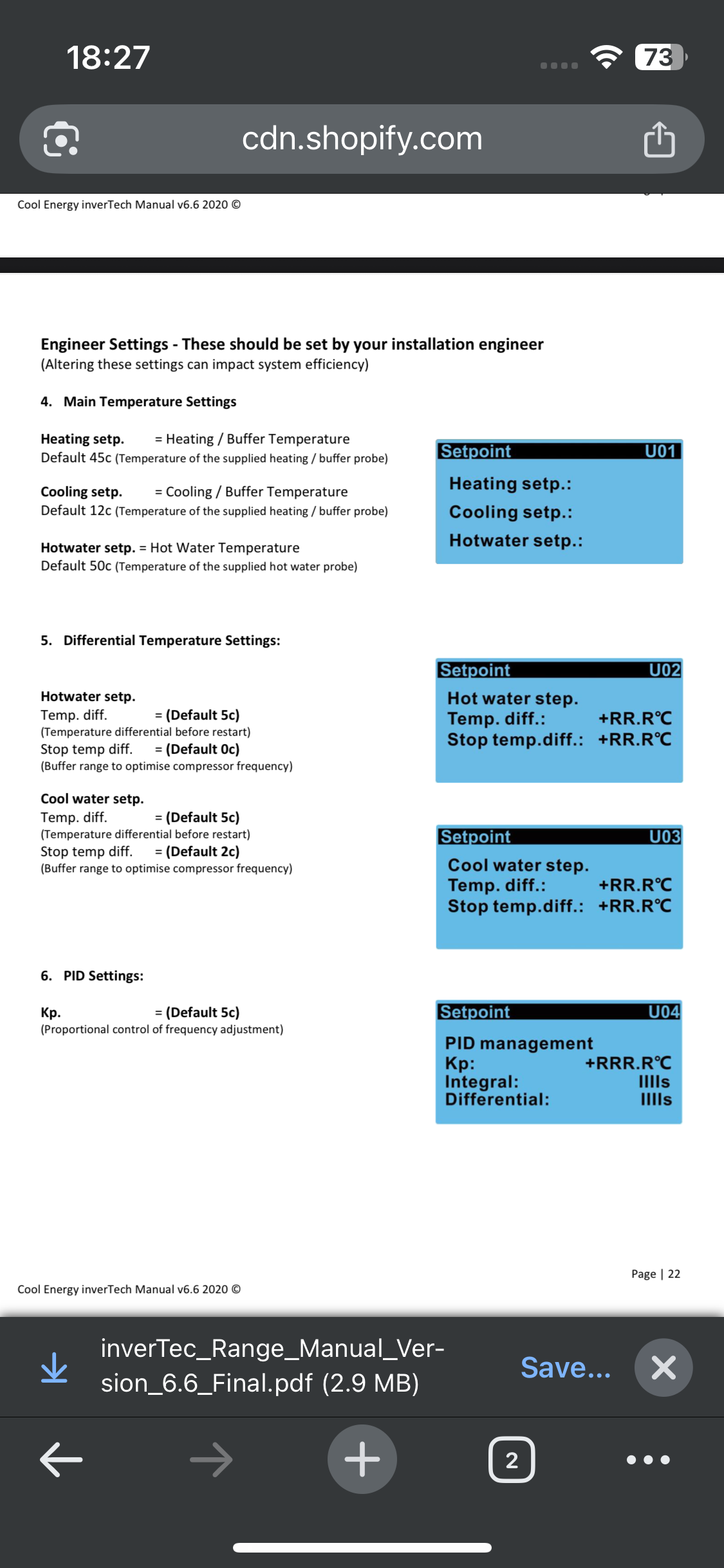

Marvin Posted October 12, 2025 Author Posted October 12, 2025 Hi @dpmiller I think I have worked it out. I use weather compensation so the hot water temperature is defined there. 1
Marvin Posted October 12, 2025 Author Posted October 12, 2025 My problem has been that the hot water temperature has been set at 40 but it doesn't actually kick in until about 36 which is too low. So on the odd occasions when the temperature is below 40 and there is shower demand the water is not hot enough. However because I have the system running on low speed mode it takes a while to reach 40 so rather than enter the weather compensation part I will alter the hot water temp diff to 2 and the stop to 2 and see how that works out. Unless anyone has a better idea.... Thanks Marvin

HughF Posted October 12, 2025 Posted October 12, 2025 Sorry, not in front of mine at the moment. I can upload the manual when I’m home later though.
HughF Posted October 12, 2025 Posted October 12, 2025 It should be on page 2 of the user mask settings. I run weather comp (fan mode = eco) but not for hot water and the settings in user mask take precedence. 1
JohnMo Posted October 12, 2025 Posted October 12, 2025 Just looked on Cool Energy website full manual is available to download. 2
dpmiller Posted October 12, 2025 Posted October 12, 2025 temp difference= hysteresis. reduce that a bit it'll cut back in sooner stop temp difference is an allowed overshoot, more useful for heating as gives more time for the unit to ramp down without shutting off immediately 2
