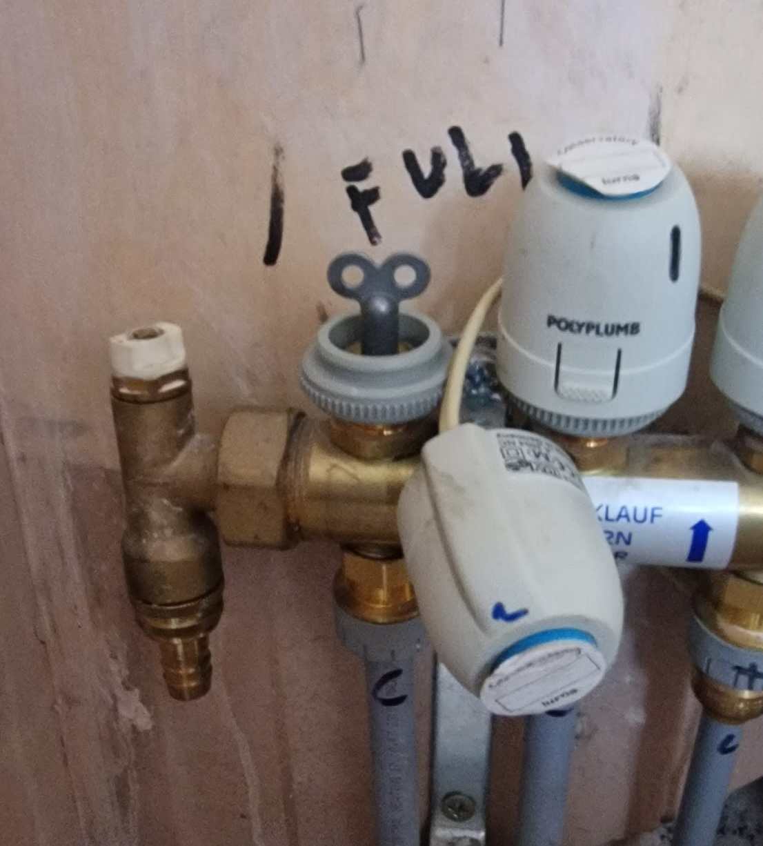

MorganP Posted Sunday at 08:55 Posted Sunday at 08:55 This is my first time posting and a massive thank you to all those on here who have helped me on this and other topics 🙏  We had an Air Source Heat Pump fitted to replace our old oil boiler. Since the installation, the downstairs underfloor heating hasn't worked properly. Upstairs - running on rads - is lovely and toasty.  The issue is a lack of heat going into the UFH circuit - especially around the mixing valve in the picture. The temperature of the pipe going in at the top of the value - coming from the ASHP - is lovely and hot. But what’s coming out at the bottom is quite a bit colder. Even fully open, the mixing valve is bleeding cold water into the circuit and lowering the temp way too much.  The original installers suggested that it can be removed completely but I'd like some advice please. I have a really sound heating engineer who can probably remove and re-pipe it but he's not an ASHP or UFH professional. Can we remove the mixing valve completely? Do we need to add in something like a TMV? I've search on here but not quite found definite answers. Help would be greatly appreciated!  Â
JohnMo Posted Sunday at 10:20 Posted Sunday at 10:20  1 hour ago, MorganP said: lovely and hot That's the first alarm bell - at this time of year even with radiators, the water should be cool certainly not hot.  Are you running fixed flow temp or weather compensation or anything else?  What is your design flow temp at -3 the installer should have given you heat loss and design calculations?  Looks a pretty basic mixer, they normally want to see quite a large dT between flow in and UFH return temperature to operate. But you have hot water on the bottom rail cannot read it very well but it looks about 40 degs.  You seem to lots of zones looking at you manifold and the number of actuators.  Do you have a buffer vessel as well? (Small vessel sitting between ASHP and heating system normally with 4 pipes).  What heat pump are you using?

Nickfromwales Posted Sunday at 10:50 Posted Sunday at 10:50 10mm pipes, and suspended / floating wooden floors?  Have you any idea how the UFH was installed? In a pug / biscuit mix of sand & cement, or in aluminium spreader plates, or an overlay system (a-la Wunda)?  Temp looks high, on the red (flow) side, so assume that the flow pipes are hot?  Looks like 10-15 degrees differential, so you’re inputting heat into the floor, so more info please!Â
MorganP Posted Sunday at 13:32 Author Posted Sunday at 13:32 Thank you @JohnMo / @Nickfromwales - already really helpful and I'm thinking it's a different issue. Just to mention, with the recent warm weather it's not really an issue yet. It was a big headache all last winter though so I'm desperate to get it sorted before the weather sets in (and before my wife emigrates to Italy, leaving me with the kids).  Quote "Are you running fixed flow temp or weather compensation or anything else?"  Fixed flow of 50 degrees at the mo. Tried everything last winter and that was the best setting. Weather compensation wasn't effective. The current performance is like this:  - around 12 degrees outside and it'll struggle to hit room temp (20 degrees). Most rooms get to about 18 / 19. - 5-10 degrees outside and we'll be lucky to get 17 degrees room temp - anywhere near freezing and it's useless - 15 to 16 degrees at best.  Quote "What is your design flow temp at -3 the installer should have given you heat loss and design calculations? " I'm afraid I don't know. Is that for the UFH or ASHP? The UFH was installed in the 00s long before we moved - based on an oil boiler. We installed the ASHP end of in 2023.  Quote "Looks a pretty basic mixer, they normally want to see quite a large dT between flow in and UFH return temperature to operate. But you have hot water on the bottom rail cannot read it very well but it looks about 40 degs."  Seems to be 34 degree flow - photo attached. Return is 30. Should that be enough?  Quote "Do you have a buffer vessel as well?" Is it one of these in the photo below?  Quote "What heat pump are you using? "  Mitsubishi Ecodan R32 / 11kw  Quote "10mm pipes, and suspended / floating wooden floors? "  Pipes: Strange but there are two sizes. My best guess is 12mm and 15mm but see what you think from the photos. Floors: Two types - mostly wooden but two tiled. The tiled floors perform a lot better  Quote "Have you any idea how the UFH was installed? In a pug / biscuit mix of sand & cement, or in aluminium spreader plates, or an overlay system (a-la Wunda)? "  It's an overlay system using an insulation board - installed circa 2004 I think.  Quote  "Temp looks high, on the red (flow) side, so assume that the flow pipes are hot? Looks like 10-15 degrees differential, so you’re inputting heat into the floor, so more info please!"   Yeah this has me thinking now - photos attached and notes above. Should 34 degrees be enough to heat the house? And is the 4 degree difference between flow too little? The floor barely gets warm - especially the wooden one. We've insulated more, put up curtains over doors, draft proofed everywhere etc. No more options on that front now 🤷‍♂️  The pump is set to max at the mo - 2 instead of 1. But I've tried both settings and it doesn't make much difference.  Thanks again
John Carroll Posted Sunday at 13:55 Posted Sunday at 13:55 If its the top of the flow meter(s) is the flowrate then you only appear to be circulating ~ 1.0LPM/loop, 4C seems a very low dT for that very low flowrate. Every 1.0LPM at a dT of 4C will give a output of, 1.0*60*4/860, 0.28kW, 11 loops equals 11*0.28, 3.1kW.
JohnMo Posted Sunday at 15:00 Posted Sunday at 15:00 12mm is the best at carrying heat. An overlay system could be leaking heat downwards as much as to the house. I had an overlay system and 34 flow did exactly what you describe for room temperatures. I bypassed in the end not saying you will need to. Â What are your floor coverings? That makes a huge difference to how UFH performs. Â How do you actually run the heating? What is a typical daily pattern? Â Have you tried to measure actual floor temperature? Â When you operated the oil boiler how was the house temperatures and UFH flow temps? Â Â Â Â

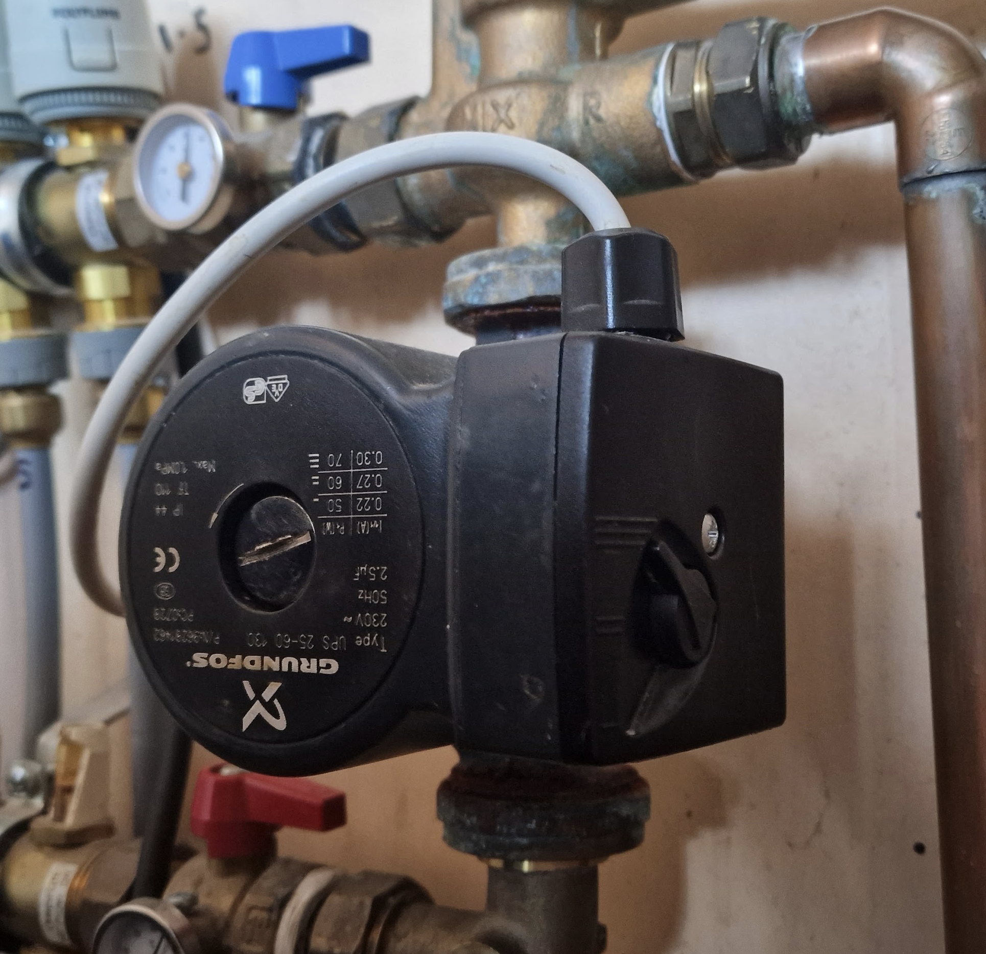

JohnMo Posted Sunday at 15:07 Posted Sunday at 15:07 1 hour ago, MorganP said: The pump is set to max at the mo - 2 instead of 1. Pump speed will not make much difference, if the flow meters are already limiting flow rate. Increase loop flow will make the loop out more heat into the room. Â I would leave the pump on its high setting and open the loop flow meters to double the current flow rate before I did anything else. Then once settled back the pump speed down until you see a change in the flow meters. Then leave it alone for 24 hrs. Ideally measure floor temp before and after.
