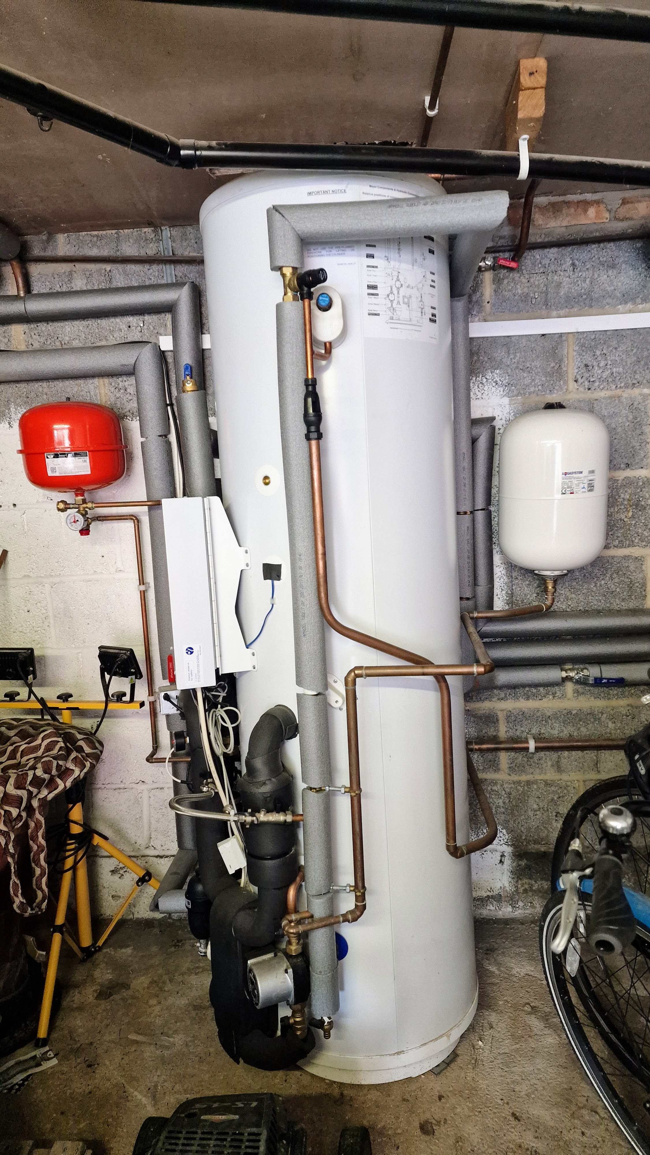

Yeah, the house has UFH, zoned with stats connected to a wireless UH8-RF V2 unit (attached). When the HP isn't tripped into immersion mode, the heating is fine. Zones call for heat, the HP kicks in etc. I have the Heating switched off at the mo, and it hasn't cut out in a few days. I wonder if it's an issue specifically to do with the heating. Maybe the HP can't generate enough heat so calls for the immersion to kick in, and then everything cuts out. Does that sound likely? Water temp is set to 50° / auto adaptive. Regarding original Installers. Hmm. Competent installers but abysmal aftercare. Very quick to charge (whether they fix your problem or not). -

Thanks again for the feedback. There's no fault showing but your point does flag two things that aren't necessarily related. Firstly: I think the immersion may be faulty as it doesn't get over 20 degrees. I can't see a specific immersion temperature setting. I assume the Ecodan controller would try and use the immersion heater to get to the regular tank temp of 50°. If so then it's not working properly. If anyone knows how it's meant to work I'm all ears! Secondly: Even if true, I can't see how the above issue wouldn't be the reason it trips into immersion mode in the first place. @Dillsue - following this comment I'm trying to isolate the issue. For now I've switched off the heating all together on the controller. I did think that auto adaptive mode would use the stats though. There are three modes - fixed flow, compensation curve and auto adaptive. I assumed all three would still need the stats to call no? -

This is correct, thanks Rick. The heating and hot water work well when the ASHP is running. The issue is that the ASHP randomly cuts out and flips into immersion mode. Given that immersion mode never gets above 20 degrees, it's effectively useless at that point. It kicks back in after I restart the system. The installer annoyingly put the main controller in the garage next to the tank - always fun being out in my dressing gown first thing in the morning So my Ecodan set up should (I think) have the water on permanently. It's set to heat to 50°. It then has a 10° drop off before kicking back in, and presumably going back up to 50. That seems correct because when it's working, the water is rarely below 40° according to the MelCloud (Mitsubishi) app. I'm not sure how to manually check the diverter valve but I'm pretty sure that's fine too as the heating works well when the ASHP is running. Hmm, so very frustrating. -

Morning hive mind - really hope you can help. We have a Ecodan r32 installed about 3 years ago. Not long after, it would occasionally flip into immersion mode and need restarting. Since then it has gradually got worse and is now happening every day or two. Some details - no faults showing - legionella mode set to 30 days - Heating is auto adaptive mode - House has rads upstairs, UFH down - Stats run through wireless UH8-RF V2 - Seems worse when stats are calling for heat. When all stats are off then it doesn't happen so often - immersion mode doesn't seem to heat the water either - only around 18 degrees We've spent hundreds on not getting it fixed so need a different route! Original installers not very helpful; charge for call out but don't fix issues. We have a decent freelancer who does the annual service but he doesn't seem able to fix it either. My wife is now threatening to take the kids to live in a hotter country (again).

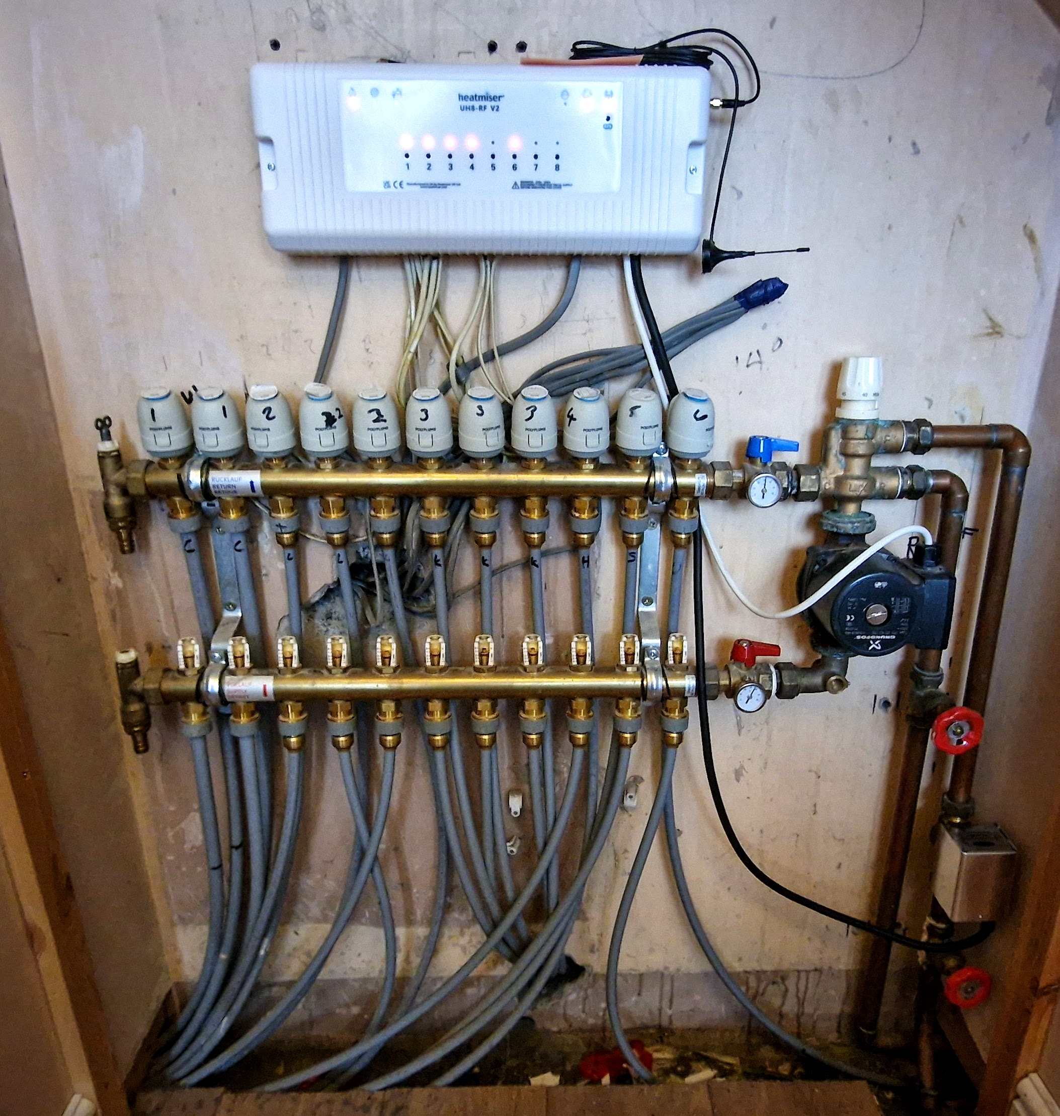

This is invaluable, thank you @Nickfromwales - there is a beer and a giant Toblerone waiting for you all if we should ever meet 👍 I do have one last question if I may. Would it be worth getting the whole setup repiped with a new manifold? Something like this which already has the pump and AAV included >> It also has a better looking mixing valve set up (mine is dropping 5+ degrees even when fully opened). -

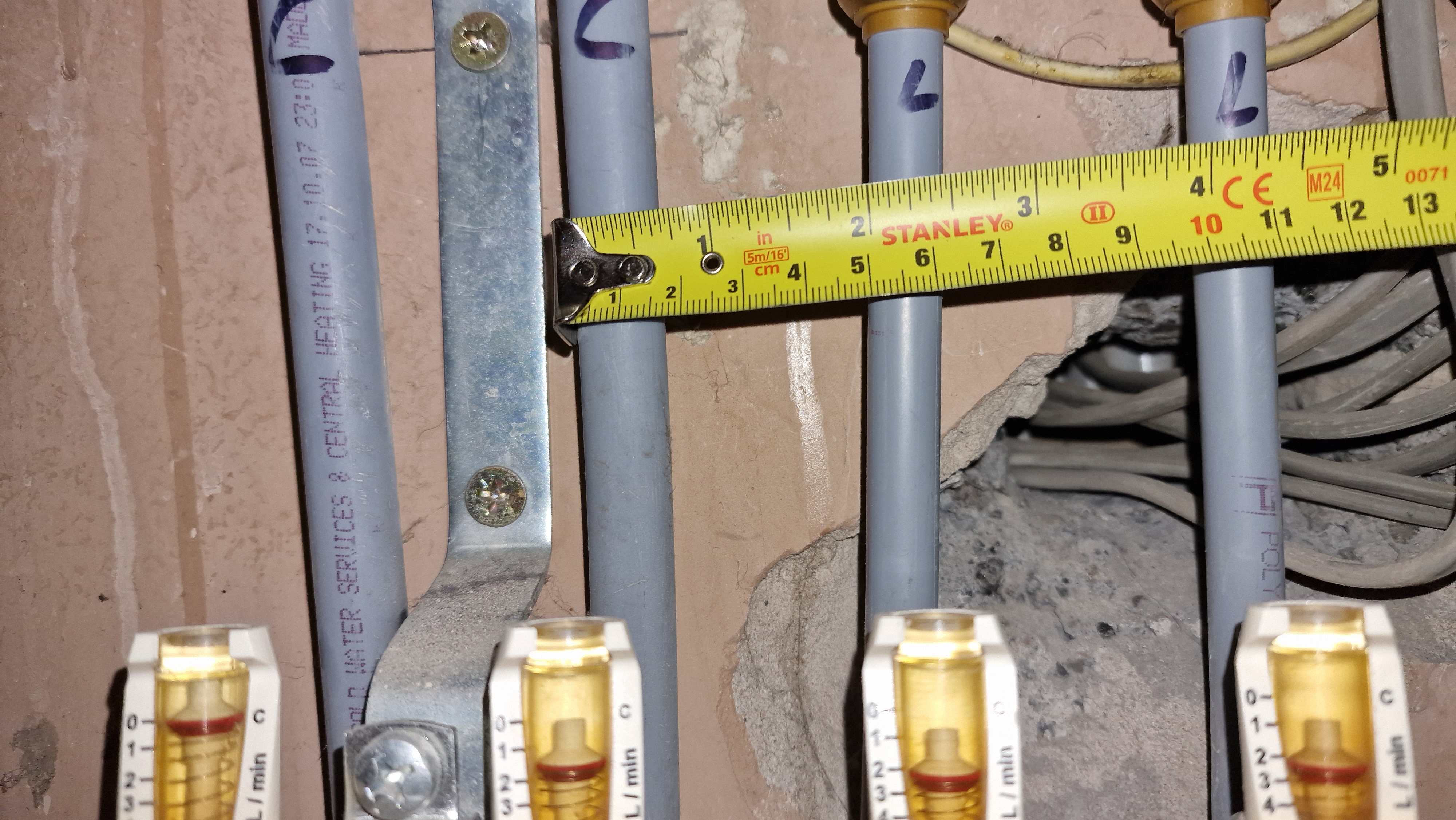

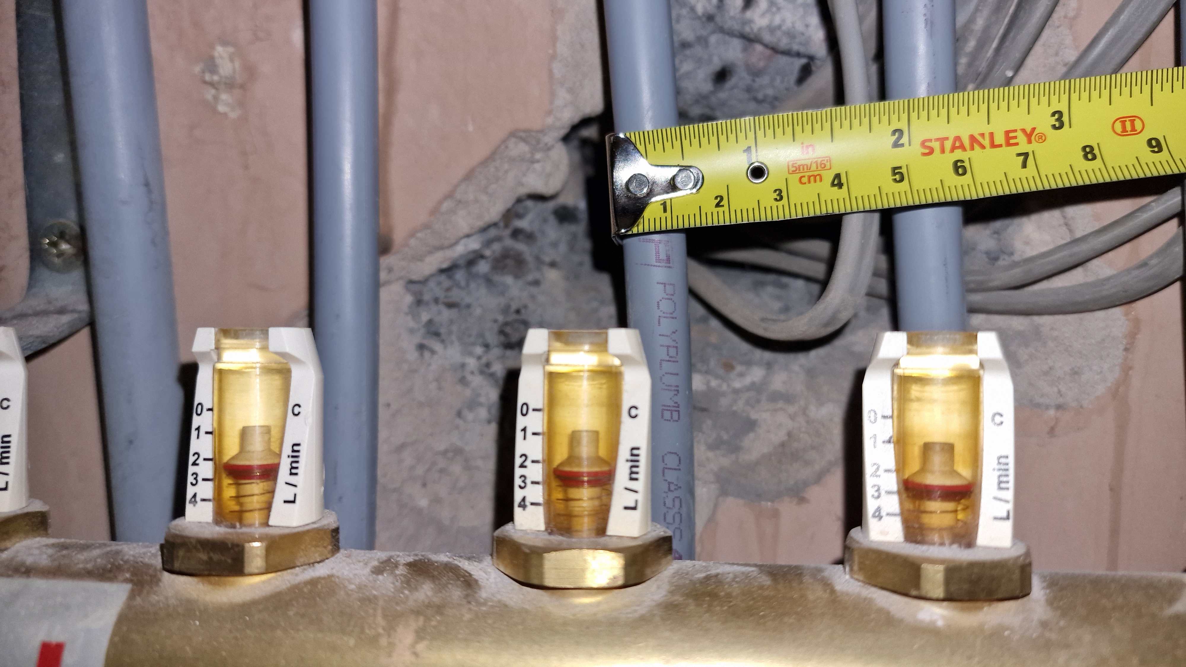

Re. AAVs - does the system need to be drained first? And can any heating engineer do it? I'm near Newark, Notts and failing to get a good, local UFH engineer. Re. this: "3 lpm flow rate on the 12mm pipe is not too shabby tbh, and if the pump was zooted you’d not even have that. How old is the pump? Is it noisy?" I'm trying to get 3 lpm but failing! Two are slightly over 2 lpm but the rest are 2 or under. The pump is likely as old as the system - circa 2004. It's not noisy. Would it be worth changing at the same time as fitting the AAVs? -
UFH Mixing Valve advice on Air Source Heat Pump set up
MorganP replied to MorganP's topic in Underfloor Heating
My best guess is 12mm and 15mm - there are two different sizes. There are photos in this earlier post: -

Hello all - @Nickfromwales @JohnMo @John Carroll Now the temperature is finally dropping outside, I've been able to do some proper testing. I've hit two issues which I'm hoping you can help with. Firstly, my system doesn't have an option to turn the flow gauges. It seems I have to use a key to adjust under the actuators - see image. Let me know if I'm missing something. Secondly, I've adjusted under each actuator - turning counter clockwise - but it wont go much above 2 LPM for most loops. From John Carroll's earlier post I was hoping to get about 3. Is that a water pressure issue or something? The system was flushed of air last winter. -

Thanks again @JohnMo - and @John Carroll This is very true. The flooring is 12mm oak laminate but we have a tiled utility room which is the warmest room downstairs! All zone stats are set at 20º during day / 17º at night. As the rooms rarely hit temp when it's cold, the ASHP runs all day - and often all night (racking up the leccy cost!). Not tried to measure temp but will have a go 👍 We had no issues at all when on oil - lovely and toasty with the kids frequently basking around on the floor enjoying the heat - good times! I never clocked the flow temp when on oil but I suspect they were a good deal higher - the mixing valve seem near fully open so I'm guessing around 40º - 45º. The setting on each flow meter hasn't changed since we installed the ASHP so I'll try increasing the loop flow to see if that helps - that seems the conclusion from @John Carroll post I'm assuming. May I ask how you bypassed it? Back to my original question - could I do this by removing the mixing valve? -

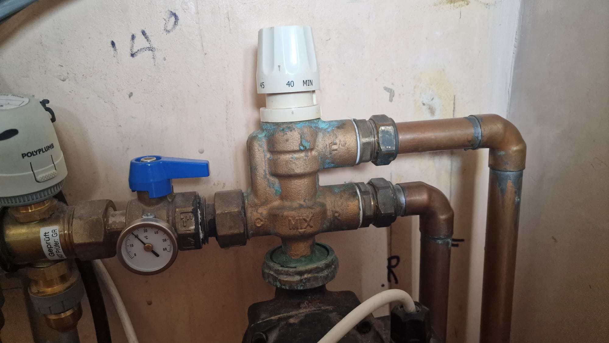

Thank you @JohnMo / @Nickfromwales - already really helpful and I'm thinking it's a different issue. Just to mention, with the recent warm weather it's not really an issue yet. It was a big headache all last winter though so I'm desperate to get it sorted before the weather sets in (and before my wife emigrates to Italy, leaving me with the kids). Fixed flow of 50 degrees at the mo. Tried everything last winter and that was the best setting. Weather compensation wasn't effective. The current performance is like this: - around 12 degrees outside and it'll struggle to hit room temp (20 degrees). Most rooms get to about 18 / 19. - 5-10 degrees outside and we'll be lucky to get 17 degrees room temp - anywhere near freezing and it's useless - 15 to 16 degrees at best. I'm afraid I don't know. Is that for the UFH or ASHP? The UFH was installed in the 00s long before we moved - based on an oil boiler. We installed the ASHP end of in 2023. Seems to be 34 degree flow - photo attached. Return is 30. Should that be enough? Is it one of these in the photo below? Mitsubishi Ecodan R32 / 11kw Pipes: Strange but there are two sizes. My best guess is 12mm and 15mm but see what you think from the photos. Floors: Two types - mostly wooden but two tiled. The tiled floors perform a lot better It's an overlay system using an insulation board - installed circa 2004 I think. Yeah this has me thinking now - photos attached and notes above. Should 34 degrees be enough to heat the house? And is the 4 degree difference between flow too little? The floor barely gets warm - especially the wooden one. We've insulated more, put up curtains over doors, draft proofed everywhere etc. No more options on that front now 🤷♂️ The pump is set to max at the mo - 2 instead of 1. But I've tried both settings and it doesn't make much difference. Thanks again -

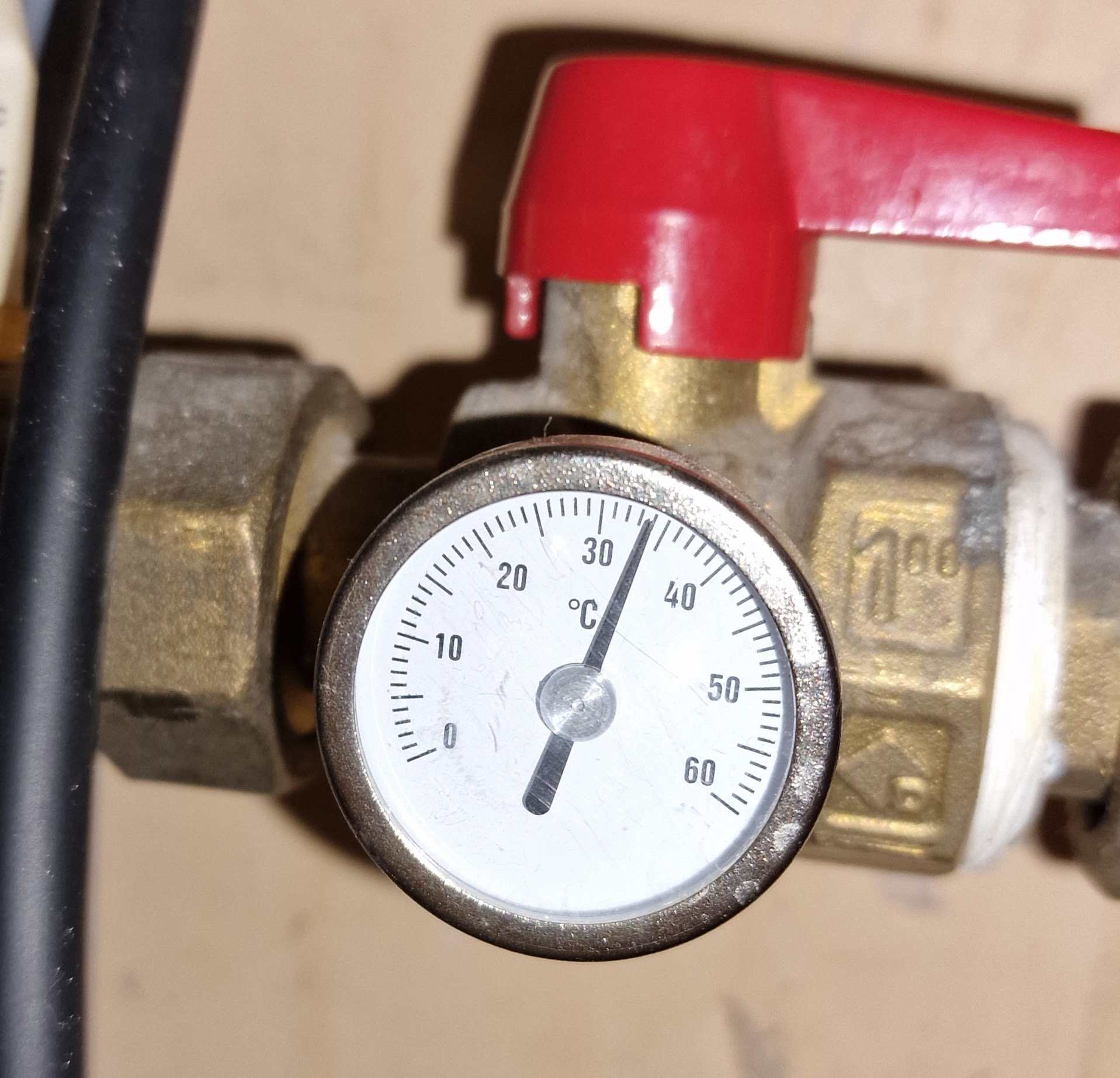

This is my first time posting and a massive thank you to all those on here who have helped me on this and other topics 🙏 We had an Air Source Heat Pump fitted to replace our old oil boiler. Since the installation, the downstairs underfloor heating hasn't worked properly. Upstairs - running on rads - is lovely and toasty. The issue is a lack of heat going into the UFH circuit - especially around the mixing valve in the picture. The temperature of the pipe going in at the top of the value - coming from the ASHP - is lovely and hot. But what’s coming out at the bottom is quite a bit colder. Even fully open, the mixing valve is bleeding cold water into the circuit and lowering the temp way too much. The original installers suggested that it can be removed completely but I'd like some advice please. I have a really sound heating engineer who can probably remove and re-pipe it but he's not an ASHP or UFH professional. Can we remove the mixing valve completely? Do we need to add in something like a TMV? I've search on here but not quite found definite answers. Help would be greatly appreciated!
