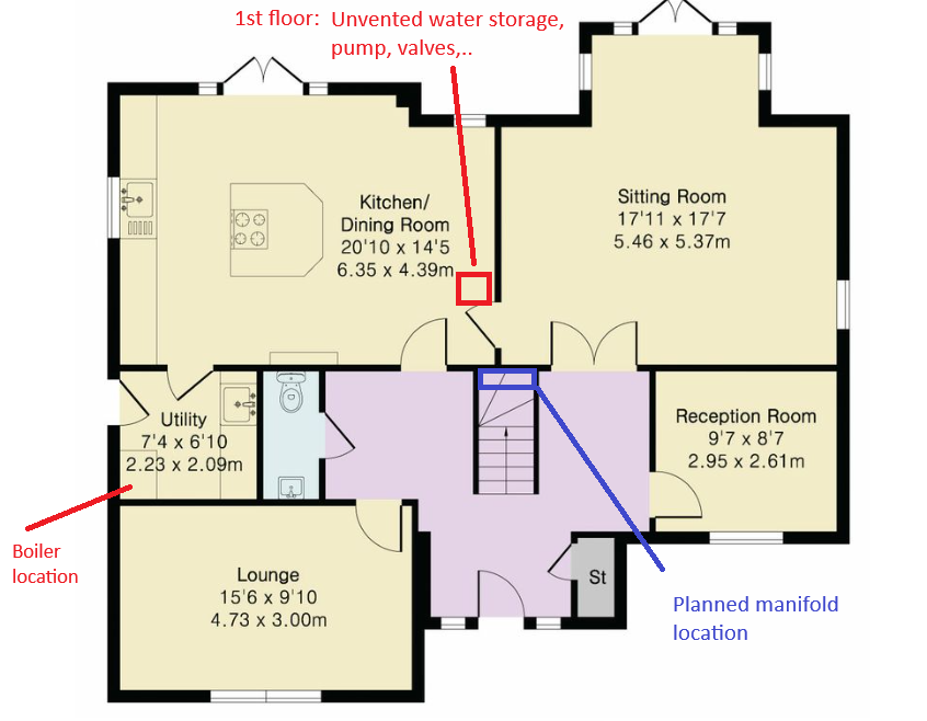

Bought a house recently in the middle UK.
5 bedroom, detached, ground floor and first floor, built in 2009.
I plan underfloor water based heating on the ground floor, but so far I only got generic system quote (without plan) from Wunda.
Currently there are radiators everywhere, and in general they heat up nicely, so don't think I have much issue with heat loss, but I do not know exactly the heat loss.
Floorplan is attached.

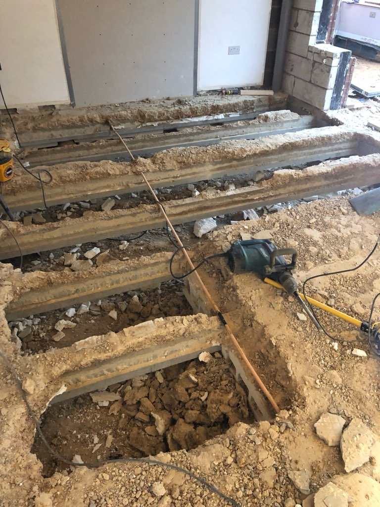

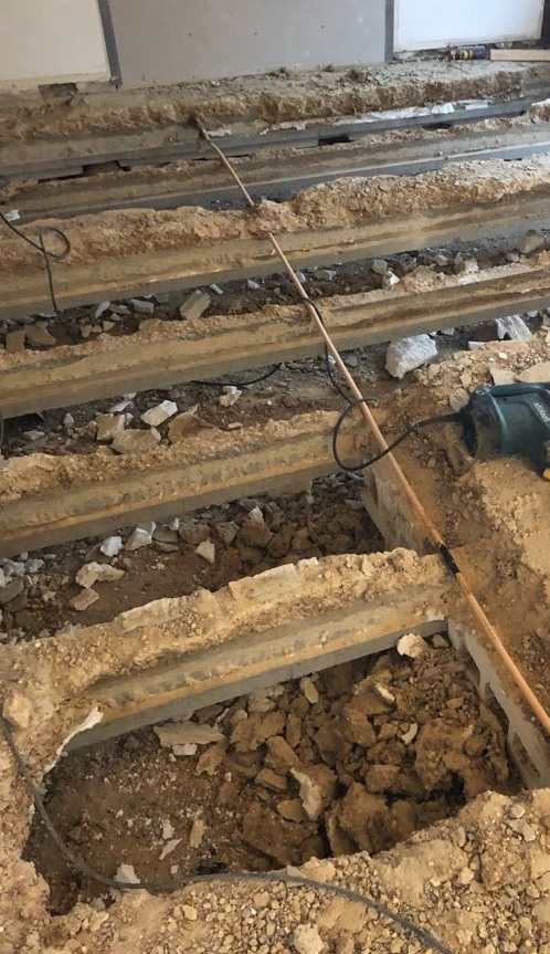

-Floor: as I know it is beam and block, the closest I could get is an old photo from one of the neighbour who dug it up for extension, it is insulated as I know. Top of the floor is concrete with some self levelling and probably damp proof layer (photos attached)
-have wooden windows, double glazed
-planned floor type: kitchen/diner/utility and toilet would be tiles, everywhere else laminate

What about the zoning? Most of the time the door between kitchen and sitting room is open, as well as the door between kitchen and hallway, and most of the time the sitting room and hallway.
I would not mind have all on only one zone, or two, maybe the Lounge on a separate zone as that will be my workplace and I would enjoy 1-2 degree less heat.
If no zoning, how the system will make sure that the laminate do not go above 27 degrees C?
What about the boiler? Overall I think it is overkill for heating, but that's what I have.
Is it worth to consider ASHP? Or a more modern weather compensated boiler?
Or just leave all as is, and use the rads and don't install UFH? My partner would enjoy warm feet though...

You need to be SURE of the block and beam make up.  If it is NOT well insulated then 20mm of insulation with the UFH will NOT be any good.
We can't form much of an opinion from the picture as the "blocks" are missing and all that is there is the beams over a presumably cold ventilated void.
You need to solve that one before spending any more effort on this, it might not be viable without a LOT of work.

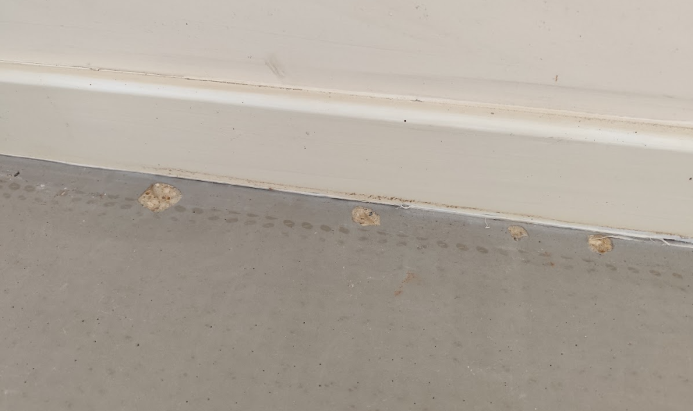

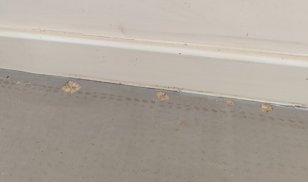

In one of the room downstairs I removed the carpet and the underlay, and checked with a thermal camera after a colder night (maybe 6-8deg), and in general the floor temperature was similar to the walls and did not see cold spots, only a small bit around the window. Room did not feel cold. That is is why I think it is "well" insulated, but I do understand that I can drain money to heat the void.

Is there a way to know construction? Do they drill and check?
The house ground floor is level with the ground. the only ventilation I could see to the void below the beams are the vent bricks. But I am not sure they are connected to the void below.
So if the void below the floor is not open void, then it is a on it's own insulating as a trapped air, isn't it?

Sorry just seen this, yes pretty basic boiler. Maybe better spending your money on a better boiler.
Can you estimate it's thickness?
Your B&B plus screed say 250 to 300mm. If it's suitably insulated it will be closer to 450 to 500mm thick.

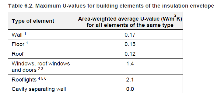

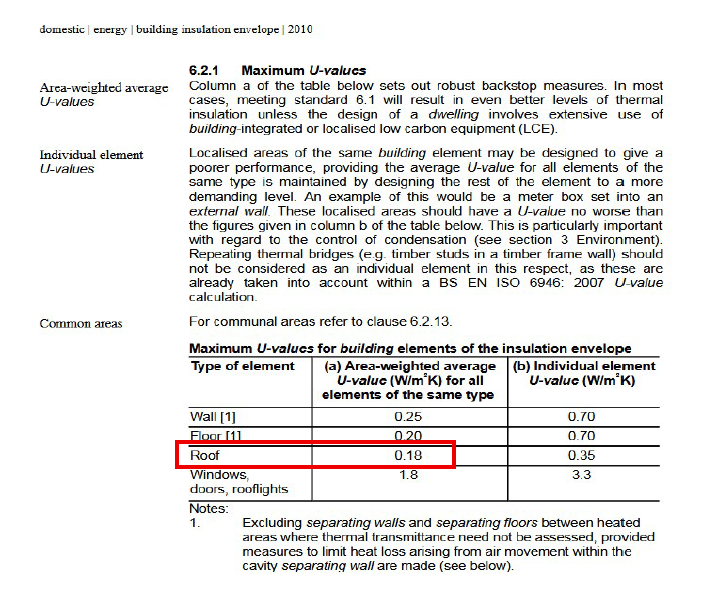

Posted
17 minutes ago, saveasteading said:
16 years ago what was the required floor U value?
In Scotland the U value for a floor in 2010 was 0.2 W/m^2K. See below for the value above the red box. This is an extract from a energy calc I was doing on a retrofit, looking at the roof, so had to dig out past regs.
Current Scottish Standards are for individual elements on say an extension, but a good starting guide for new build.
As it's a bit baltic up in the north of the UK the English regs, I guess, at that time were using a value of maybe 0.25 W/m^2K as traditionally the English regs are slacker than the Scottish regs.
Current basic Scottish regs are below.
One thing to take away from this is that the Scottish Standards are more onerous than in England, have not look at NI yet in detail.

You are right, image is cropped, but on the full one I referenced to a wall socket size and the total floor thickness is around 200mm

My main point is to check that you have floor insulation, thickness and what material: don't assume.
Is there somewhere you can easily check eg at a  hatch you could assess the thickness.
OR somehow get an accurate report on the neighbour's floor. That looks just uninsulated to me, but hollow blocks helping a bit.  There are ways of playing with the numbers to get building regs especially back then.  The actual number could be dreadful. It would not suit ufh.
Air in a large void is a very poor insulator. Ground is better.

Sort of. In a narrow box such as double glazed units, a tiny air gap creates a large improvement, very much more than with secondary glazing, because the air circulates.
In a floor void It will heat up and circulate too. There should be air bricks and they will suck the heat away too. Even if there aren't, there will be draughts.
I can't see insulation. The blocks are about 150mm, then a slab on top, but I don't see insulation.
The white bits in the image are the insulation I guess, it's broken in pieces, but visible on some part of the floor closer to the wall, also closer to the bottom of the picture, pieces fall into the void also.
I upload the full image, what shows a bit more.
Unfortunately no access to the void, and you are right, the air bricks are likely vents for the void (as per this video: https://youtu.be/nuqlgDe33Gc?si=wfu0XLxeBOkZR0rq&t=22 )
Adding insulation to the floor, lets forget that it adds height, but a 100mm PIR would reduce heat loss by about £140 per year, but material cost is £1200 plus put it down, so it would take like at least 10-15 years to break even.
