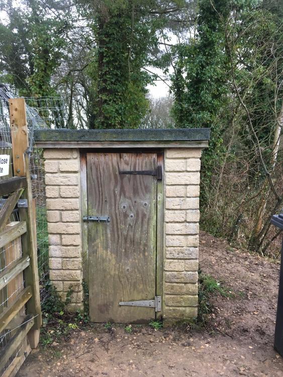

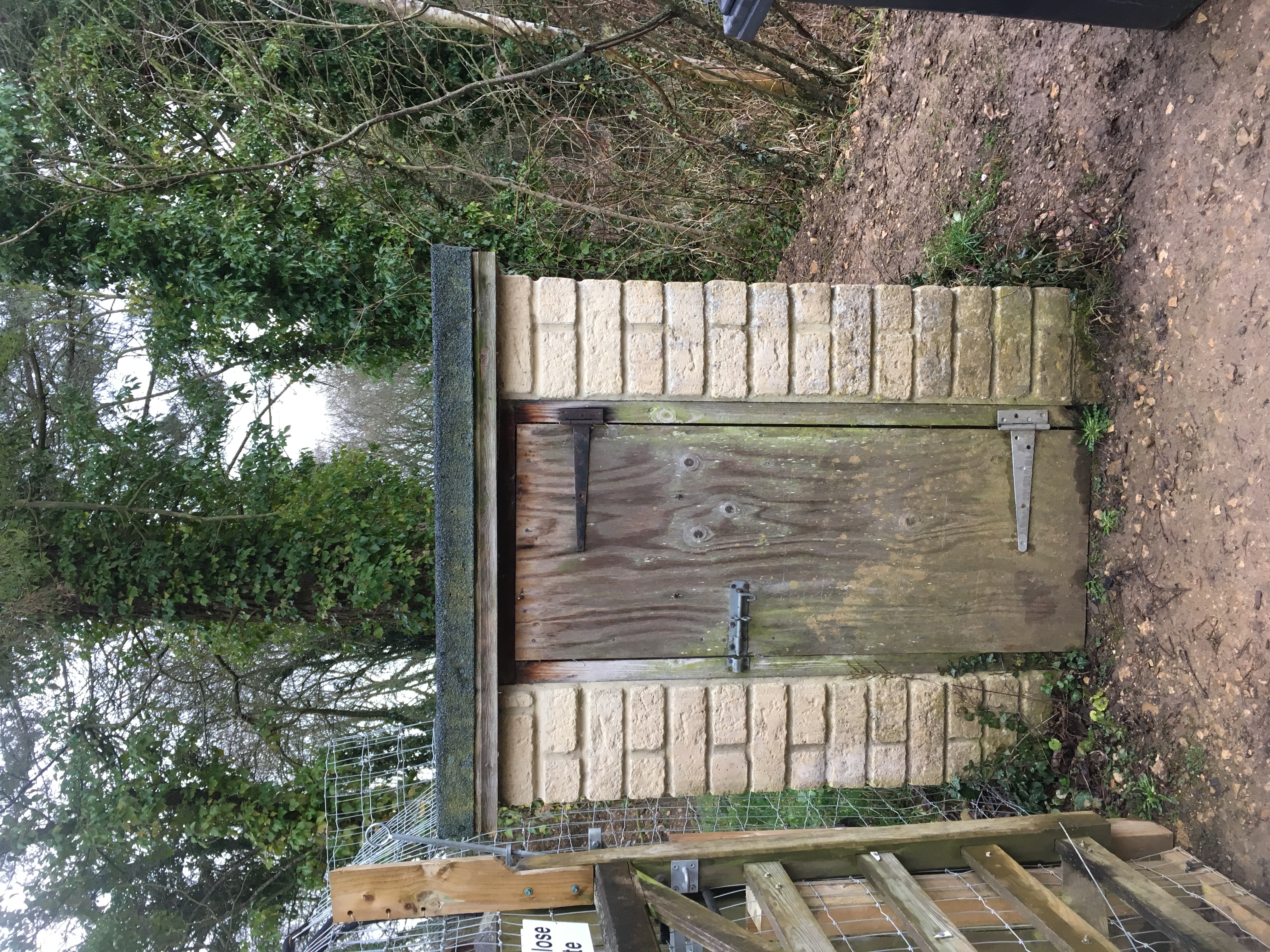

We have this in our garden, it would be more costly to build than the pre formed version but has loads of space in it for future equipment.
Just an idea if you have the space.
