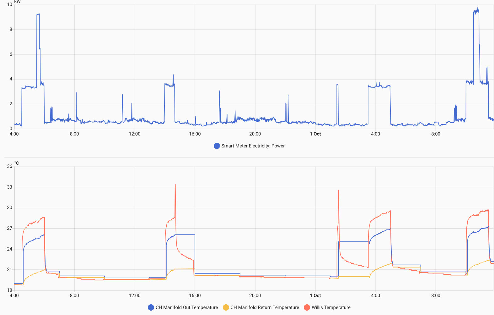

Short version: We have an 8 year old passive-class all-electric house running on and optimised for the Octopus Agile tariff with electrically heated wet UFH. We made the house ASHP ready, but didn't install one during the build, instead using an inline Willis heater as a "temporary" solution to allow us to size the ASHP on actual house performance.  In practice the running costs are low enough that we've never made the RoI case to install an ASHP so here we are 8 years later and still using the Willis.  One of the major advantages of my design is that it has very few moving parts so pretty much no servicing maintenance is needed: some CU mounted contactors, some commercial ESP based modules, the Willis and the UFH pump. I keep cold-swap spares for the relays, modules and the Willis.  But now the pump has occasionally stalled.  Is it time to get a cold-swap spare or should I just have done and replace it?  @Nickfromwales   you are the oracle on such matters.
Longer supplementary.   My CH control system is a NodeRED based app comprising about 1K lines of JavaScript and some NodeRED flow including maybe 50-100 other NodeRED nodes -- a fairly small app by NodeRED standards. This uses MQTT to talk to the ESP modules and to share data with a Home Assistant instance which I use as a general Home automation interface. My basic strategy is to move any time-shiftable electricity loads to the cheapest Agile tariff time slots: white-goods, EV, HW and CH heating.   This is workable because the thermal capacity of the house is so high that it doesn't really matter when I schedule heating so long as I top up enough each day overall.  Each day just before tariff roll-over, the system calculates the heating required for the day ahead and allocates a heating schedule so that we do this at the cheapest price. So our typical electricity use is a base ripple of stuff that can't easily be time shifted, plus big blocks of power draw at the cheapest prices that day.  See the graph below which is an extract for 32 hours starting 4 AM yesterday.  The top plot is our spot energy use taken from our smart meter; the bottom plot is the Willis temp, plus the average out and return flow temps from the UFH loops.
The cheapest price slot was 04:30 - 06:00 so that was when the main UFH heating slot was scheduled (the spike to 9kW spike was when the HW immersions also kicked in) )  You can see the typical UFH heating curve: The Willis quickly heats to ~27°C with the average out flow to the UFH a couple of degrees cooler and the return at 19°C (the overall slab temp); these all slowly rise together by about 2½°C over the next 90 mins as the heat transferred  warms the slab around the UFH pipe.  This pattern happens on four heating cycles during this period.
BTW, the out & return flow temperature readings are steppy because these thermometers are only read if the circulation pump has been running for at least 5 mins, because  these rapidly settle to the ground-floor ambient temperatures without circulation.  The pump is  cycled for 6 mins every 3 hours to enable the slab temp to be tracked.
Note that some went wrong at 14:41  and the following 01:31. Here the Willis suddenly started heating rapidly until the 35 °C safety trip was exceeded and the CH system turned off the Willis.  The system log shows that the pump relay was still on but the water wasn't circulating: it had stalled at 14:41 and was still stalled when it came on again at 01:30.  What is odd is that it started correctly at the 3:30 heating slot, so the stall is intermittent .  Very odd.
UFH Temps, 04:00 30 Sep - 12:00 1 Oct

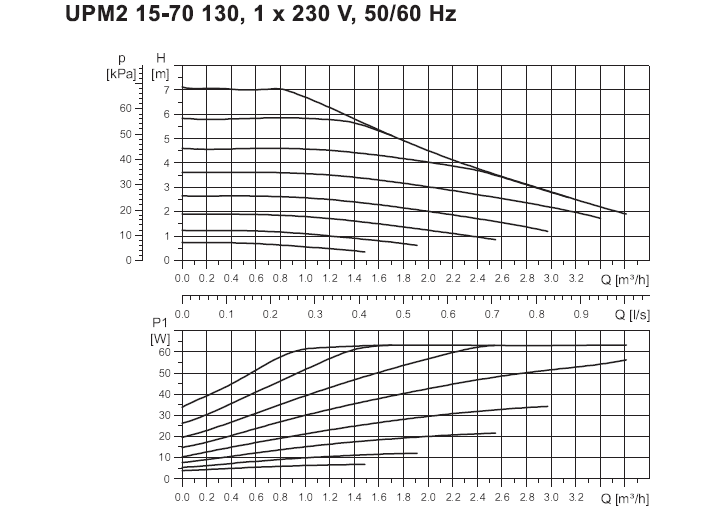

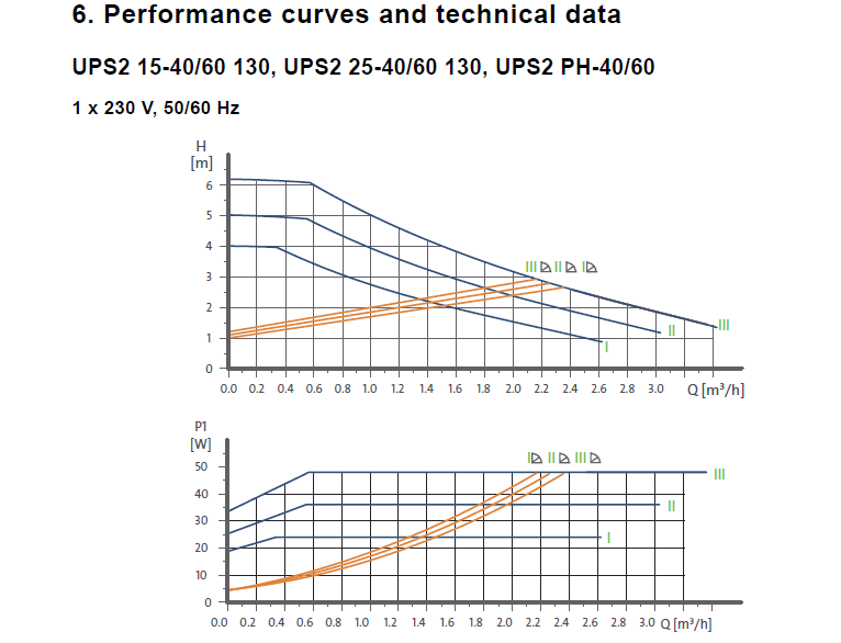

5 hours ago, John Carroll said:
If your pump curves look like the ones below then the power required should only be around 12W yet your pump is pulling ~ 40W,
Thanks for this, but I made a cock-up and hang my head in shame. I am getting a bit old after all. 🫣😨
I pulled the wrong pump photo from my house pictures.  That was a pic of the pump in my old SunAmps which as you say is PCM controlled.  My house is 2,000 miles away and I pulled the wrong pic.  It's working fine at the mo, so this can wait until I get back on the 12th.  I will update then.
Sorry guys.
PS I think it is a UPS2 25/40-60 130.  This has an 240VAC input and H/M/L selector for speed control.  😨
