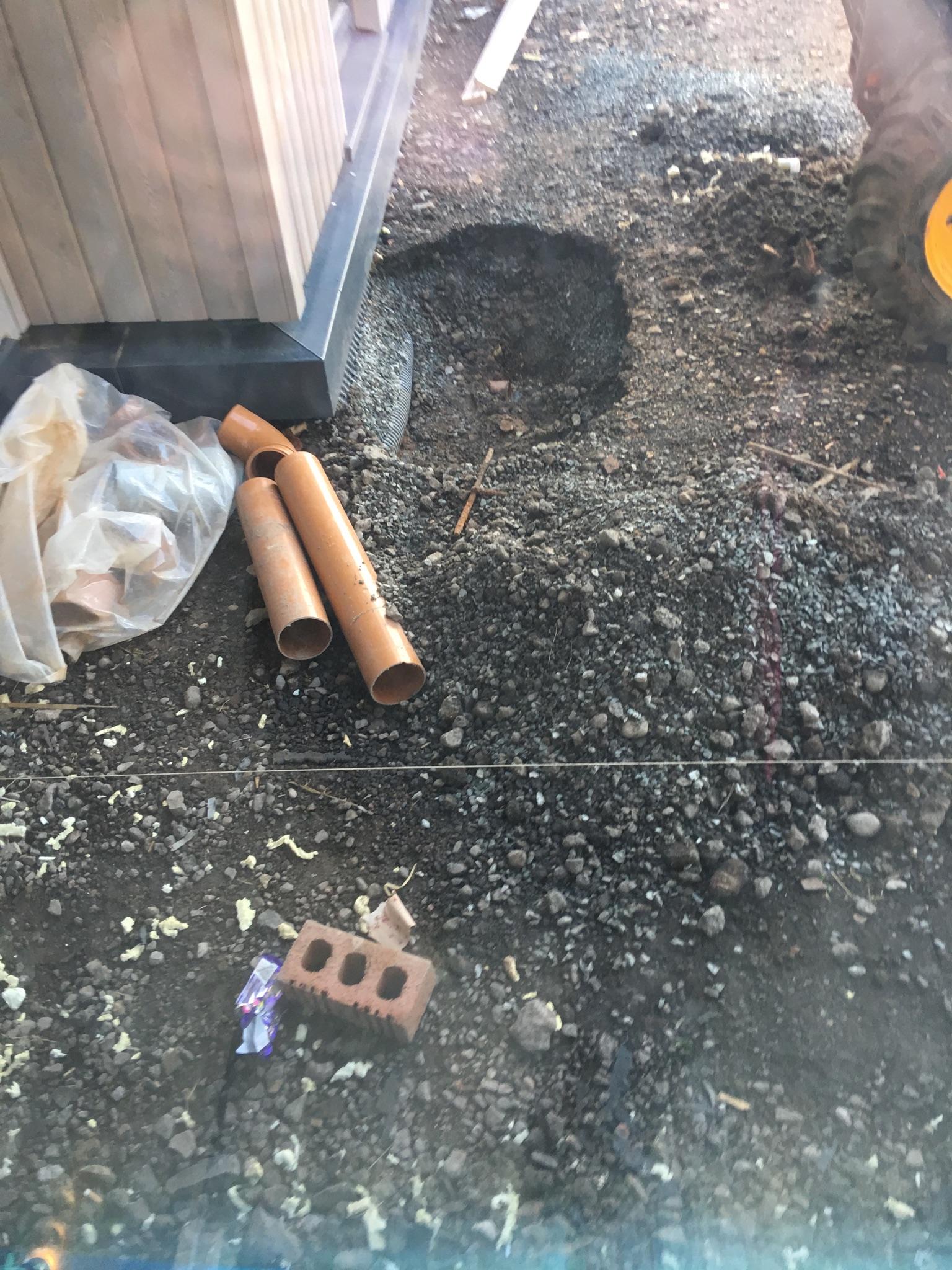

Weebles Posted July 8, 2018 Share Posted July 8, 2018 I am re-opening this thread (if that's OK to do?) with some questions on this neat finish. Our MBC slab is going in at the moment so we are thinking about this geotextile and alu finish. Looks so smart. My question is on the geotextile. Is this rodent proof or did you put something else over it? What have you back filled in next to that geotextile? I was thinking about putting my excess MOT type 1 in there. But don't want the rats to make a home under my house...... Any spec on that geotextile (is a minefield of choice out there)? Or any other finishing ideas for on top of the EPS? Link to comment Share on other sites More sharing options...
lizzie Posted July 8, 2018 Share Posted July 8, 2018 2 hours ago, Weebles said: I am re-opening this thread (if that's OK to do?) with some questions on this neat finish. Our MBC slab is going in at the moment so we are thinking about this geotextile and alu finish. Looks so smart. My question is on the geotextile. Is this rodent proof or did you put something else over it? What have you back filled in next to that geotextile? I was thinking about putting my excess MOT type 1 in there. But don't want the rats to make a home under my house...... Any spec on that geotextile (is a minefield of choice out there)? Or any other finishing ideas for on top of the EPS? I have a whole roll of geotex unused was taken away by the project manager to sell...we bought 2 only used 1........not heard any more about it or of he ever sold it but as he took a job with mbc after getting involved with them while working on my job if you get offered a bargain roll by an mbc bod it is probably my surplus. It was about £250 a roll, I will look out invoice from BM so I can tell you spec. We fixed to eps with things that looked like enormous plastic nails...mushrooms I think they were called....will have detail somewhere. Our alu flashings are deep they come right down over most of geotex and go down below ground build up around eps. I think we just brought the type 1 up to alu nothing further, will check with my man who did it. I dont think rodents will get through the geotex it is very strong....underneath well who knows but where do you stop....the attached pic gives a clue...this is where we had to dig out to find why a toilet was not flushing properly and found it had not been connected to anything in the ground but thats a whole other story, just thank goodness for a second fix plumber who noticed a slow drain on the w.c. he was installing. Link to comment Share on other sites More sharing options...
lizzie Posted July 8, 2018 Share Posted July 8, 2018 @Weebles found the detail on geotex amazingly quickly given my filing system is a big box! We used Wykamol Kontract Geotextile 1.9m x 20m long. It was £197.80 plus vat per roll. I think we had to trim it we didnt use 1.9m over the eps.maybe half as wide feels about it. Link to comment Share on other sites More sharing options...
PeterW Posted July 9, 2018 Share Posted July 9, 2018 On 08/07/2018 at 13:24, lizzie said: @Weebles found the detail on geotex amazingly quickly given my filing system is a big box! We used Wykamol Kontract Geotextile 1.9m x 20m long. It was £197.80 plus vat per roll. I think we had to trim it we didnt use 1.9m over the eps.maybe half as wide feels about it. Thats an odd choice for just protecting EPS as that’s a draining geotex for use around buildings and basements. It’s double layer to allow water to drain away into a French drain below. Who specified that @lizzie..?? Link to comment Share on other sites More sharing options...
Jeremy Harris Posted July 9, 2018 Share Posted July 9, 2018 I just used expanded metal. Relatively cheap and provides a more robust rodent barrier. Link to comment Share on other sites More sharing options...
lizzie Posted July 9, 2018 Share Posted July 9, 2018 26 minutes ago, PeterW said: Thats an odd choice for just protecting EPS as that’s a draining geotex for use around buildings and basements. It’s double layer to allow water to drain away into a French drain below. Who specified that @lizzie..?? The erstwhile project manager.....please dont tell me its the wrong stuff!!! We do have a french drain all around but its not in that. Link to comment Share on other sites More sharing options...
PeterW Posted July 9, 2018 Share Posted July 9, 2018 4 minutes ago, lizzie said: The erstwhile project manager.....please dont tell me its the wrong stuff!!! We do have a french drain all around but its not in that. Well it’s certainly over spec ..!!! I’m sure he has his reasons, you won’t have damp issues with that though ..! 1 Link to comment Share on other sites More sharing options...
