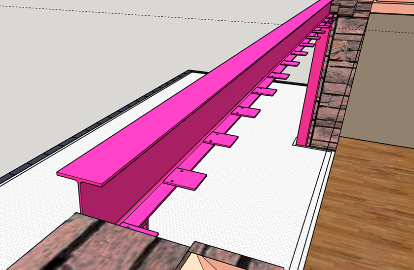

nwnw Posted September 19, 2025 Posted September 19, 2025 Hi folks, I'm working on the design for a new extension (all in Sketchup). Loads of queries to come and I'll probably put my drawings up here soon for scrutiny. My biggest headscratcher just now is how to support the existing roof structure when I remove a 6.5m length of structural stone wall. I've seen various ways to do this with joist hangers and sandwiching timber on the steel, but I'm wondering why I can just mount direct as shown below. I've coloured for clarity...Blue = existing roof trusses and joists. Red = new extension flat roof joists and firrings. Pink = Steel Existing timbers I'm sure will not be perfectly aligned so my thinking would be to leave a nominal gap and shim to the steel, or to profile the face and underside of the joists a tiny bit to fit. Thoughts?? Pitfalls??

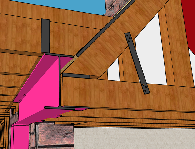

nwnw Posted October 15, 2025 Author Posted October 15, 2025 Ok, so I came the the conclusion that I was overengineering the beam a bit and it was going to be very heavy. I've reduced in size down to a 305 x 165 x 40 Universal Beam (this will be run past a structural engineer). Downside is that the bearing area on the inner rib is then not enough for the joists. So I am proposing to add bearing plates as shown below. These can also be differing thickness and used as shims. Thoughts anyone??
Big Jimbo Posted October 15, 2025 Posted October 15, 2025 I dont have a clue, but would it not be easier / cheaper to just have a wider plate welded to the underside of the RSJ. to allow a larger bearing surface ?
Big Jimbo Posted October 15, 2025 Posted October 15, 2025 Do you need the goalposts ? is there not enough room to simply bear the RSJ on the wall either side of the opening ?
nwnw Posted October 15, 2025 Author Posted October 15, 2025 2 hours ago, Big Jimbo said: I dont have a clue, but would it not be easier / cheaper to just have a wider plate welded to the underside of the RSJ. to allow a larger bearing surface ? I did consider that but I think plates are possibly a better option... - For the smaller plates I can do it all myself. I can order the plates pre-coated and simply drill all the holes and bolt. - It keeps the weight down (saves maybe 20-30kg over a full width plate). - It can also act as a shim Regarding the 'goalposts'...my assumption is that I will need that to comply with the structural calcs and building regs. The cottage is circa 140 years old so most likely will not have compliant foundations.
gamestrolley Posted October 15, 2025 Posted October 15, 2025 Over doing solution, timber glulam or flinch beam and fix truss or beam shoes to face of timber or use a deeper C channel and will will have more surface for the rafter to sit in
nwnw Posted October 28, 2025 Author Posted October 28, 2025 Thanks for the feedback and ideas @gamestrolley. I like the fact that glulam or flinch beams would give an easy way of hanging the joists. However, one issue with these methods is that the ends would be 'free' to pivot and therefore I would see more deflection in the centre of the beam (and therefore possibly cracking plaster, etc). The Universal Beam/Column design would be bolted to the uprights, meaning that the ends would be 'fixed'. Online calculators show centre deflection roughly doubles if the ends are free. Thoughts? C Channel or 'Parallel Flange Channels' (PFC) only go up to 100mm deep as far as I can see. This is right on the limit for bearing area - and that's assuming all the existing old joists end on the same plane (unlikely). Strangely, they also seem to be 20% higher price than UBs for similar size/strength.
torre Posted October 28, 2025 Posted October 28, 2025 With a timber packer bolted into the web of your steel you could face nail joist hangers onto the packer. The hangers then also prevent any rotation and easily nail at different heights. Given you'll need SE calcs for this anyway, honestly I'd leave the design to them. The bolted on shims sound like quite a lot of work and will need additional specification by the SE.
nwnw Posted November 2, 2025 Author Posted November 2, 2025 On 28/10/2025 at 14:27, torre said: With a timber packer bolted into the web of your steel you could face nail joist hangers onto the packer. The hangers then also prevent any rotation and easily nail at different heights. Given you'll need SE calcs for this anyway, honestly I'd leave the design to them. The bolted on shims sound like quite a lot of work and will need additional specification by the SE. I think you could be right. Meeting with structural eng this week. Will see what he thinks.
saveasteading Posted November 2, 2025 Posted November 2, 2025 It's fun to think of ideas, but there is a more fundamental issue. If you put all that load on one half of the bottom flange, it puts a rotation into the beam. A beam out of plumb becomes very much weaker. So this is likely to be 'knocked back'. 1

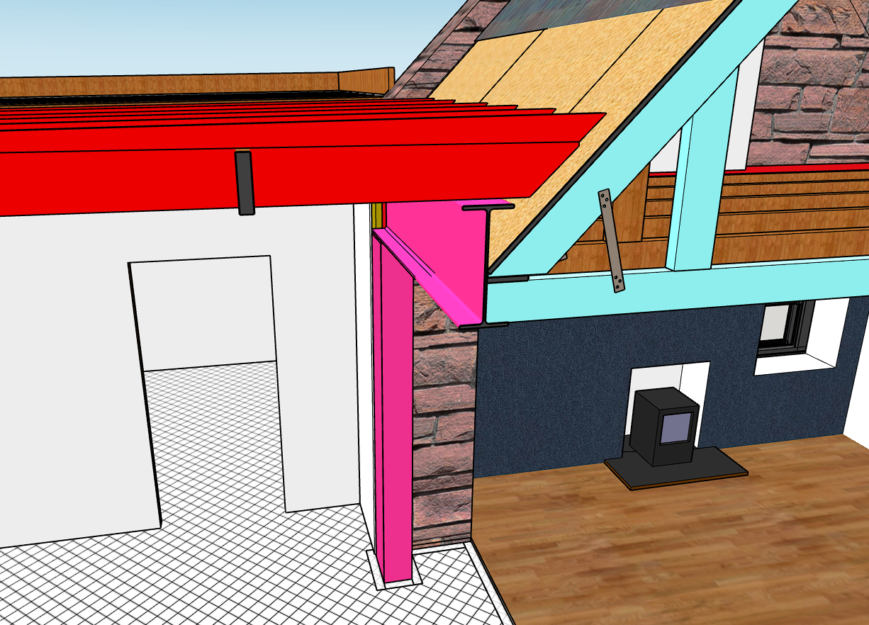

Nickfromwales Posted November 2, 2025 Posted November 2, 2025 On 15/10/2025 at 14:23, nwnw said: Regarding the 'goalposts'...my assumption is that I will need that to comply with the structural calcs and building regs. The cottage is circa 140 years old so most likely will not have compliant foundations. This may be worse as you’ll likely need 1/4 cube concrete pads set in to take these point loads. Load would likely be better transferred down through the walls so it’s distributed.
nwnw Posted November 3, 2025 Author Posted November 3, 2025 20 hours ago, saveasteading said: It's fun to think of ideas, but there is a more fundamental issue. If you put all that load on one half of the bottom flange, it puts a rotation into the beam. A beam out of plumb becomes very much weaker. So this is likely to be 'knocked back'. I see your point. I think in reality it would be fine as the flat ends of the beam would be flat onto the 'goalpost' tops. But...proving this through simple calcs is another matter. I think I agree that the engineer will much prefer the simpler method of a timber packer bolted to the centre rib to keep all the forces square. Thanks for the input.
nwnw Posted November 3, 2025 Author Posted November 3, 2025 20 hours ago, Nickfromwales said: This may be worse as you’ll likely need 1/4 cube concrete pads set in to take these point loads. Load would likely be better transferred down through the walls so it’s distributed. My assumption was that I would need the goalposts and significant reinforced concrete pads. Existing foundations are obviously fine for the load going through just now, but concentrating that load on 2 points would surely need a bit of verification, right? It will be at least 6.5m clear span so quite a load. Will see what the engineer thinks. 1
nwnw Posted November 17, 2025 Author Posted November 17, 2025 @Nickfromwales ...structural engineer agreed that steel bearing on walls is probably the simplest and cheapest, if the foundations are suitable for underpinning. I have a couple of holes to dig. 1
saveasteading Posted November 17, 2025 Posted November 17, 2025 6 hours ago, nwnw said: I have a couple of holes to dig. Underpinning is hard work and done in stages. Dig access trench along the wall to the bottom of the footing, then as far beneath that, as instructed. So you are quite deep. Tunnel under the footing locally, about 1m wide. Mining. Fill under the wall with concrete and wedge up. Repeat. Backfill. Commercially this would be many hundreds£ per metre. Anything is better. Is the ground that poor in bearing? The point of letting the existing wall take the load is to use the existing bearing capacity.
Mr Punter Posted November 17, 2025 Posted November 17, 2025 I think a trial dig near the wall make sense. Don't do it near where you may be keeping the nibs of the existing wall. You may find that the existing wall foundation bears onto very stable base. Try to avoid underpinning.
nwnw Posted November 18, 2025 Author Posted November 18, 2025 (edited) 17 hours ago, saveasteading said: Underpinning is hard work and done in stages. Dig access trench along the wall to the bottom of the footing, then as far beneath that, as instructed. So you are quite deep. Tunnel under the footing locally, about 1m wide. Mining. Fill under the wall with concrete and wedge up. Repeat. Backfill. Commercially this would be many hundreds£ per metre. Anything is better. Is the ground that poor in bearing? The point of letting the existing wall take the load is to use the existing bearing capacity. @saveasteading@Mr Punter I dug a couple of holes for the engineer this morning. Founds only go down about 25cm or so. House is very old and ground here is generally solid (dig 2 inches anywhere in the garden and I seem to hit big stones! Digging a small trench last year needed a digger). Engineer is suggesting just underpinning 900mm wide at the wall sections below where the beam will land. Given the foundation depth, this should be easier than 1m deep pad stones if I went the steel goalpost route. Edited November 18, 2025 by nwnw
Nickfromwales Posted November 18, 2025 Posted November 18, 2025 On 17/11/2025 at 00:20, nwnw said: @Nickfromwales ...structural engineer agreed that steel bearing on walls is probably the simplest and cheapest, if the foundations are suitable for underpinning. I have a couple of holes to dig. Yup. KISS wins every time mate. Tbh you’d be opening up a giant can of worms if you went opening up / disturbing bigger sections of ground near existing founds to drop pads in afaic, so glad that sense has prevailed here At least underpinning can be controlled in smaller sections. 1
saveasteading Posted November 18, 2025 Posted November 18, 2025 6 hours ago, nwnw said: Founds only go down about 25cm or so. House is very old Be aware that the house will be moving a lot seasonally. So going too deep would make the new foundation too much stronger than the existing. Your SE should tell you exactly how to do this. Width, depth, length, and how to ensure that the new concrete is jammed tight under the existing. Presumably the new extension will go before the bco. Your SE will need formal calculations for all this. What will the new foundations be?

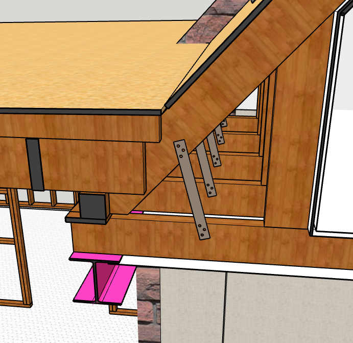

nwnw Posted November 19, 2025 Author Posted November 19, 2025 In case folks did not see it in my other thread...my SE also suggested moving the beam to under the existing joists. So it now looks like this... Not great as there will be a concealed beam in the ceiling space (doesn't actually look that bad). It does however make the build much easier, especially as the old timbers are likely at different lengths.
