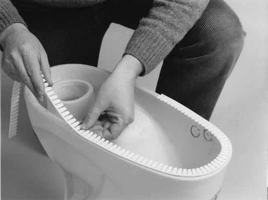

MortarThePoint Posted September 16, 2025 Posted September 16, 2025 I've just discovered this plastic strip product that you can put between ceramic surfaces. It sticks to one of them and conforms to the other. My main use would be below floor mounted toilet pans. Has anyone used it or have any thoughts about whether it's worth it? 1

MortarThePoint Posted September 16, 2025 Author Posted September 16, 2025 13 hours ago, Beau said: Nice idea if it works. I hate sealing around toilet pans and it never looks good You still need to apply a bead of silicone around the joint when done with this though so I think it's more about avoiding the ceramic on ceramic contact if that is indeed a problem

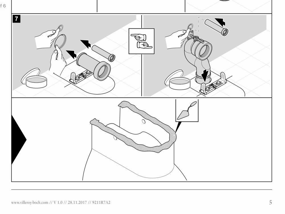

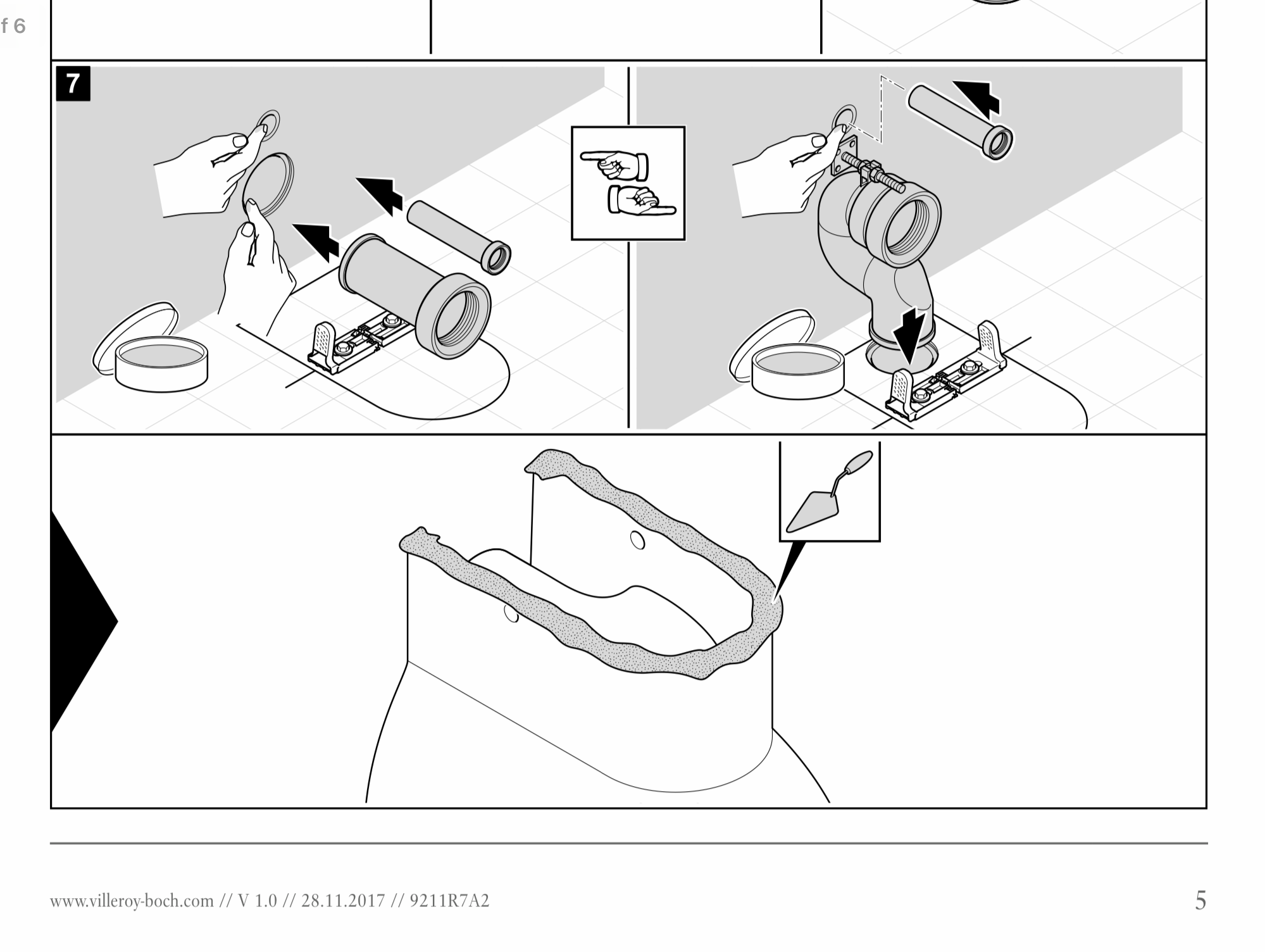

Nick Laslett Posted September 18, 2025 Posted September 18, 2025 (edited) My floor mounted toilet pan had this less than useful picture in the install instructions. Which I assume is tile adhesive. But I still don’t understand how you can have adhesive on the bottom of the pan and then do all the movement to fit it to the two connections. Wouldn’t it make a right mess? Edited September 18, 2025 by Nick Laslett

MortarThePoint Posted September 18, 2025 Author Posted September 18, 2025 1 hour ago, Barnboy said: @Nickfromwales What about wall hung toilets ? I asked a 2 local pluming merchants today who both said that they'd never heard of these tape /strips . Sorry, should have mentioned that Screwfix sell it: https://www.screwfix.com/p/harosecur-strip-42500-fitting-strips-clear-500mm/742fn
