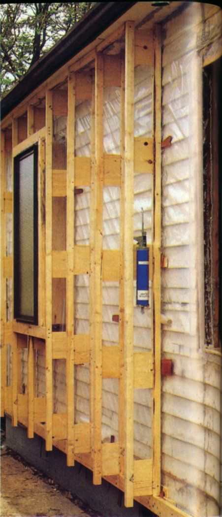

Iceverge Posted September 28, 2025 Posted September 28, 2025 Using the chimney to vent the underfloor isn't a good idea thermally. As Nick says it'll cool the house 24/7. Forget rigid boards, impossible to put in there properly. Instead make some Larsen truss type joist extenders with flanges on bottom to tack to the side of the existing joists. If you could rip a 300mm I-joist in half it would be perfect. The OSB webs will be plenty thermal break. Imaging something like these hanging from below your existing joists. Drop in hardboard to sit on top of the new flanges. Use acoustic sealant/tape/foam to make it windtight. Drop in mineral wool insulation. Glue all joists in the flooring deck as your airtight layer. The process is much like this apart from your Larsen trusses. Cover the ground with polythene if you're worried about moisture.

marshian Posted October 1, 2025 Posted October 1, 2025 18 hours ago, YodhrinForge said: Honestly starting to think you're right. I went back and ran the rough calcs for just deepening the joists to 200 or 250mm and using ecologicalbuildingsystem's retro-ecofloor technique and it's coming back somewhere between 0.13 and 0.15 which is in the same range as the thermally broken approach and would be easy as widdlin' up a wall by comparison - grab some joist stock, tack them on underneath with the nailgun on an angle, a few screws up from below, then it's all vanilla. I don't anticipate there being any missed bits, I'll actually have pretty good access to everywhere I'll need to do comprehensive airtightness and I'll be handling that aspect of the project personally to ensure no bodging, but tbh that aeroseal thing looks nas-tee to me. "Non-toxic water based" but requires full-face breather with VOC cartridge during application hmm yuh-huh. Looks to be an aerosolised acrylic caulk, no info on longevity testing, no info on whether it is or how long it stays flexible to deal with wood movement etc, can't see vapour permeabilty numbers in any of the docs on their site. Seems like it would be a useful tool in the context of the volume housebuilding sector to save them time and effort, if they were building near-passive homes(and assuming engineered timber rather than sopping wet CLS that will look like a plate of spaghetti by the time the house dries out), but in a back-to-masonry deep retrofit I don't see the value really. 80 - 20 rule for me If I can get 80% of the benefit for 20% effort I'm comfortable with the compromise I'm not going to put 80% of my effort in to getting the 20% extra - big wins for min effort every time for me I could have fitted 100mm of PIR under my suspended wood floors v 75mm the cost would have been 40% more 75mm PIR U value 0.33 W/m2K 100 mm PIR U Value 0.23 W/m2K When I considered my actual floor losses once I was over 50mm the bang for buck was done. Payback on 75mm was 4 years (Russia helped me out - I was projecting 8 years based on energy cost increases) 1
