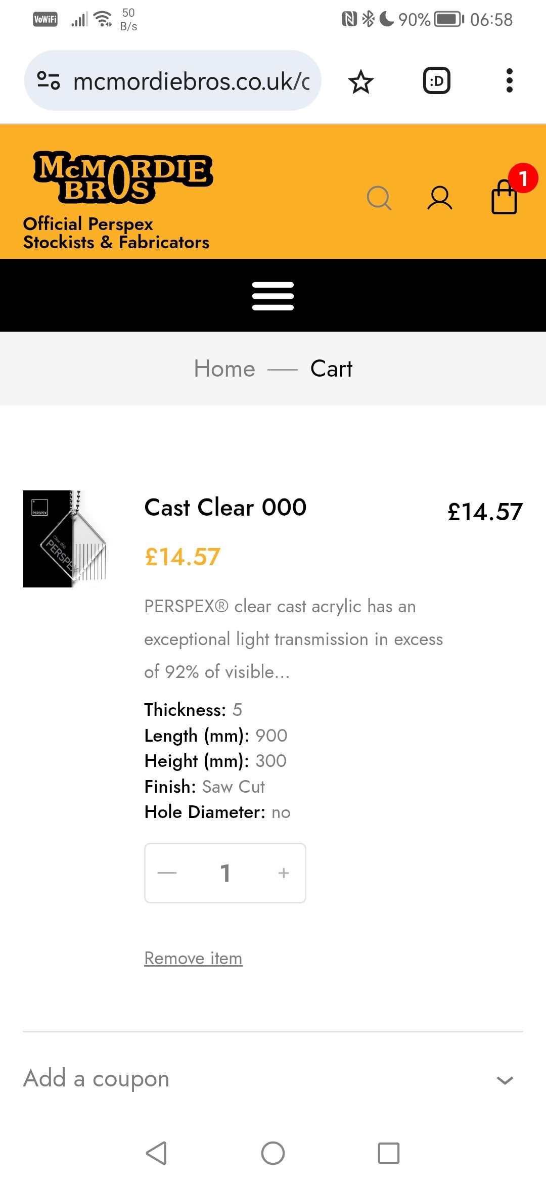

dpmiller Posted Sunday at 17:02 Posted Sunday at 17:02 I wouldn't expect McMordie's to be the cheapest source ever, but they *do* know their stuff...

aidy55 Posted Sunday at 20:39 Author Posted Sunday at 20:39 Do you anyone else in Northern Ireland who can supply it, preferably precut.
