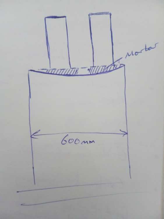

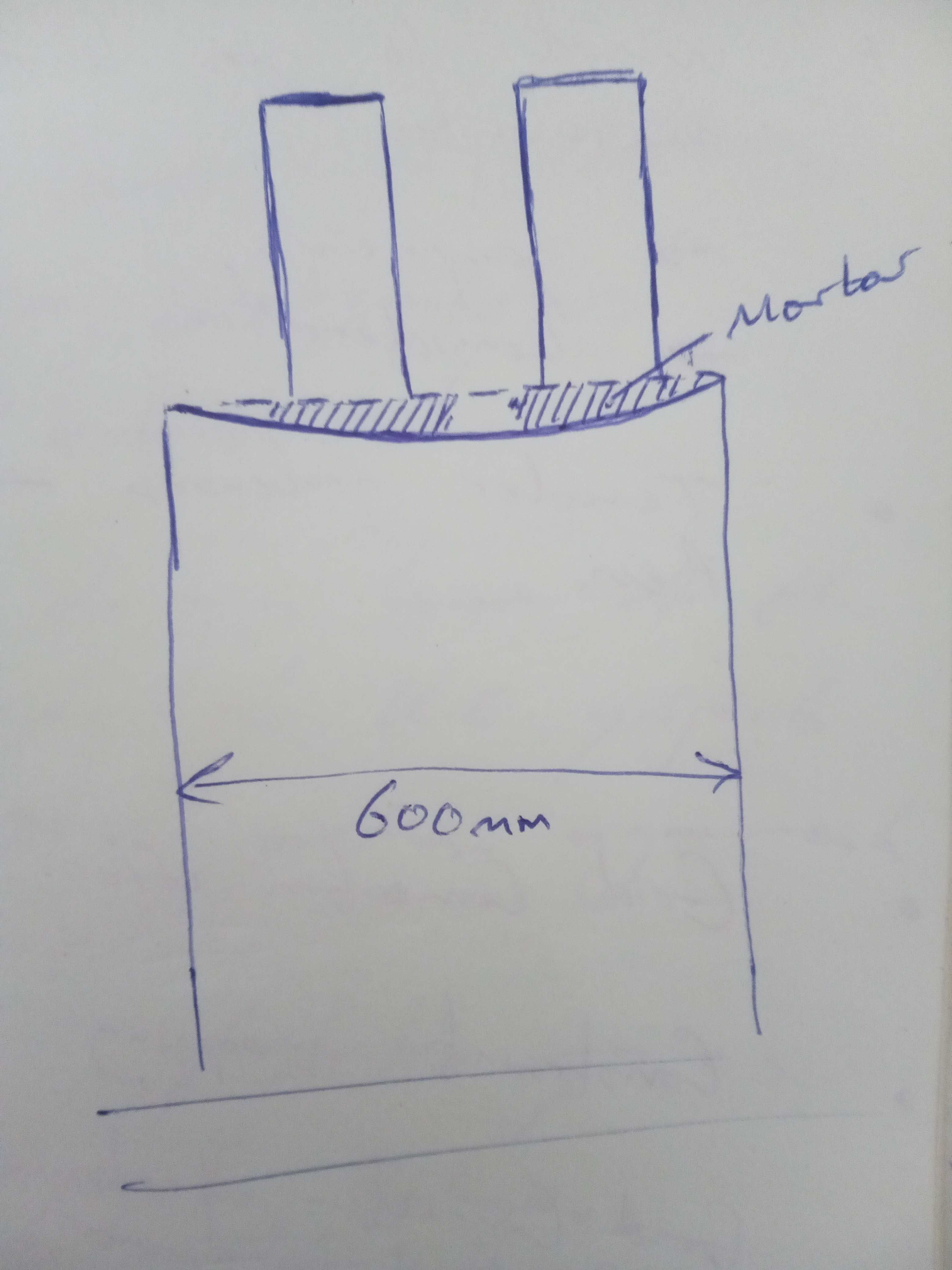

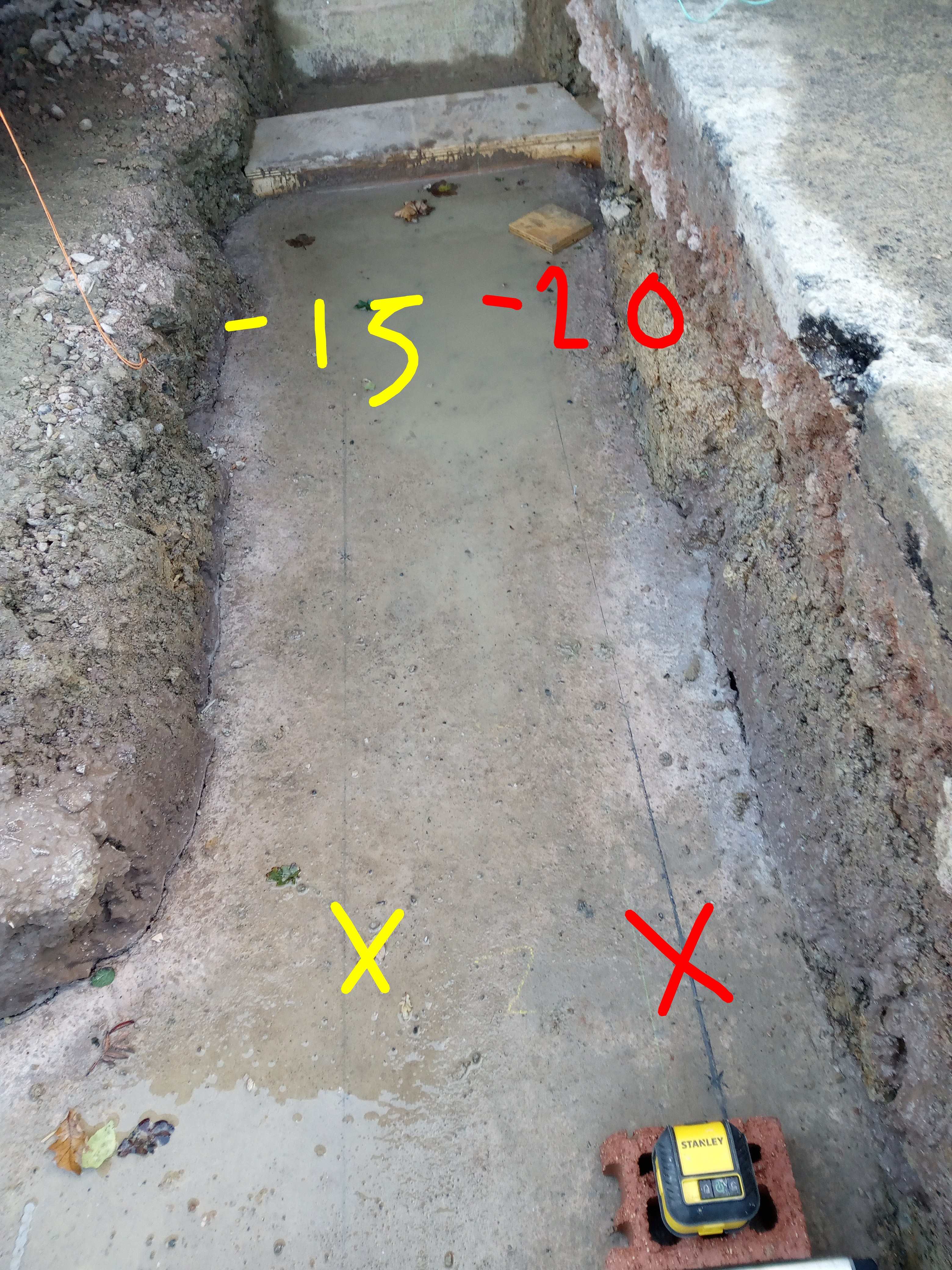

Stu84 Posted September 12, 2025 Posted September 12, 2025 Greetings all Trench fill happened yesterday for small side extension (3x4m footprint). Footings are about 600mm thick and 600mm wide. Checked levels today and there's up to 25mm deviation in height and if viewed in section there's a slight dish (up to a 10mm dip across the width of the foundations). Also the pour is 10-35mm below the finished depth we agreed. To be truthful I am upset as builders quoted to dig,rebar, box-in pipes and pour. The digging was hard going so of course I helped dig. I boxed in the pipes and even resin-fixed all the rebar. We've had some down pours so I've painstakingly kept the site as dry as possible with tarpaulins / pump etc. I asked them to drive stakes in to ensure level all around which they argued against. They said they'd use a laser and would get it to within 10mm and that I should trust them. When the concrete arrived I thought best to leave them to it so they can focus. 4.5T of concrete was poured in about 10 min and I returned after about an hour to find they were packed up and about to leave. I asked if they used the laser, they said they had. There was a bit of floating water but not much and I covered with a tarp. I'll get over the disappointment. Just hoping it can be worked with. Does the 'dip' across the width of the foundation matter? Can this be leveled off with mortar before laying the first course of regular block? It is definitely there (the water pools along the centre). Should I be grinding down the sides a bit to better level? Excuse long message. Part of the healing process! 🥴 Thanks all.
nod Posted September 13, 2025 Posted September 13, 2025 You can easily sort that out with your foundation blocks 1 1
Stu84 Posted September 14, 2025 Author Posted September 14, 2025 On 13/09/2025 at 07:21, nod said: You can easily sort that out with your foundation blocks Thanks nod, that does help. On one stretch they managed to lose 15mm+ over 2m, impressive! This is my first self-build so steep learning curve. I know bed courses can be increased a bit but in the real world what is roughly deemed acceptable below ground for a standard 3:1 mix? 20mm? Think if I had to go more I'd start looking to cut a few blocks. There's an inverse camber across the surface so the mortar will be deeper on the inside than the outside otherwise blocks will want to tip in. This is common?? At least the weak concrete mix that will go in the cavity will help blocks wanting to cave in. Thanks!

Alan Ambrose Posted September 16, 2025 Posted September 16, 2025 I think the reality is that groundworks is a often a rough and ready process - maybe on a fine day with the right team it isn’t, but on a bad day or with a less skilled team it just is. 1/2 an inch is a good tolerance in groundworks, anything better is probably uneconomic. It is upsetting to a certain kind of person and I’m one of those. I have internal drainage out by up to 200mm in horizontal position and the same in invert level. And I suspect I have not discovered all the faults yet. I wish I hadn’t trusted my groundworks guys and looked over their shoulders more. Will it result in impossible-to-fix problems - probably not. Has it cost me much extra time and effort - definitely yes. I’ve resolved to buy a total station and do my own detail layout for the ‘next build’. My surveyor is good but a total station to use to check a position or level any time I want would be better. 1 1

saveasteading Posted September 16, 2025 Posted September 16, 2025 It's OK. I've seen very much worse. Lasers aren't always accurate and are only used approximately in trench footings. Successive processes get more accurate but For perspective: the published tolerances in timber buildings are plus/minus 10mm. 1 1
saveasteading Posted September 16, 2025 Posted September 16, 2025 23 minutes ago, saveasteading said: only used approximately in trench footings. For future reference, I tended to either bang pegs in the bottom and mark depth with a nail. In clay, knock nails or bars in the sides at finished level. Very formally for precision ( big structures) we would have T profiles along the side at say 2m above finished level and a 'traveller' a T that we placed on the concrete and lined up with the profiles by eye. A laser can replace this if used skilfully. Big IF. Hence the nails. 1

Stu84 Posted September 17, 2025 Author Posted September 17, 2025 13 hours ago, Gus Potter said: I get @Stu84's disappointment. But as others have said, and which I design for, is to be able to level things out with the masonry underbuilding. You can often go for a 20mm thick mortar bed with no detrimental effect. Thicker mortar beds can be ok but you thicken the wall base on the first couple of courses.. it's still economic. Hi Gus and thanks for your perspective. The builders wanted to lay a few trenchblocks down with very thick beds. But I can't do this all the way around as on one side they will be above ground and prone to freeze/thaw. Then I pondered using trench blocks for the immediate problem area only but Thermalite technical said not ideal abutting Aircrete products against aggregate blocks and it just raised more Qs. I suppose I could use a few extremely heavy 6" blocks for that small stretch? It was soft clay for the first 700mm then we hit good shillet. The boards came out just before the pour to reduce risk of side collapse which I was pleased about. To make level with the first corner block we'd need a 30mm bed (tapering to less). I've asked my SE whether he thinks that would be OK, and if so whether he prefers to see a 'levelling' bed of about 20mm go down first, followed by a another bed on top. I'm aware all of this is getting into crazy detail, but I can't help it. That's the way I am until I understand a subject well. My mind's eye just sees a concrete slope with ground water pooling around a thick mortar bed. The SE has come back and said that something like Sika MonoTop 630 repair mortar would do the job but may be overkill as would need to scabble the surface so I await his opinion on deep standard M12 mortar. Which must be pretty darn tough as I think 3:1 mix (M12) is what they bed some manhole covers with on major highways. But probably doesn't have much movement. It might not sound it, but I am comforted by all of the feedback above. I know rationally there most be thousands built on worse. But perhaps irrationally I don't seem able to move forward comfortably without very high confidence, not helped by things like Eurocodes 6 that quotes maximums of 15mm bed.

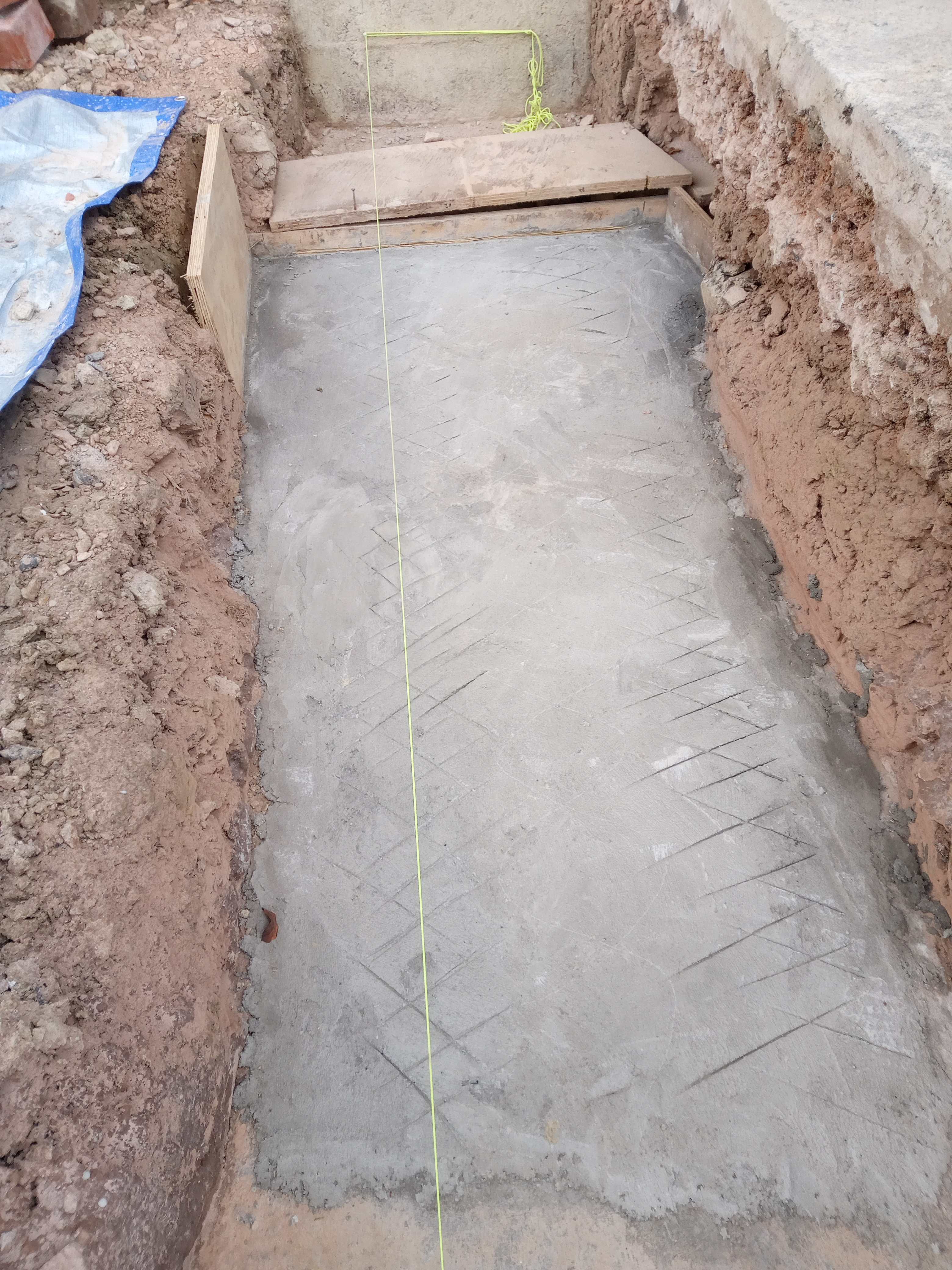

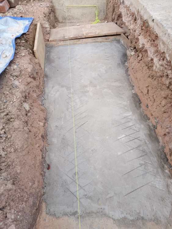

Stu84 Posted October 1, 2025 Author Posted October 1, 2025 Hi everyone sorry to revive this just wanted to say thanks for all the input and update you on what happened. So the engineer had a very slight preference to scabbling and using something like a Sika repair mortar to level out. He did say that a thick mortar 25-30mm would be adequate. However I did a few experiments with some thick regular mortar and I found it pretty brittle stuff when it gets to that depth. So I got in touch with Sika and they suggested either Sika Monotop 630 Rapid or 4012. Both with the application of a primer (Sika 1010). I went for it. The preparation was difficult (trying to get a straight edge around the repair patch for it to key to, no dust, etc etc) and also application of the primer was very specific. It wasn't easy. The image looks like its keyed into soil, it's not, there's a step not far in from the edge(s) which has been covered with a bit of repair mortar which I will sand down so that it can't 'flake off'. Any way, I now have a level area to build off. Moving on to my next challenge. I can't be absolutely certain it's better that just throwing down some regular mortar but can' see it being worse. Lesson learned: Insist on builders pegging depth markers and be there during the pour! Thanks all. 1
