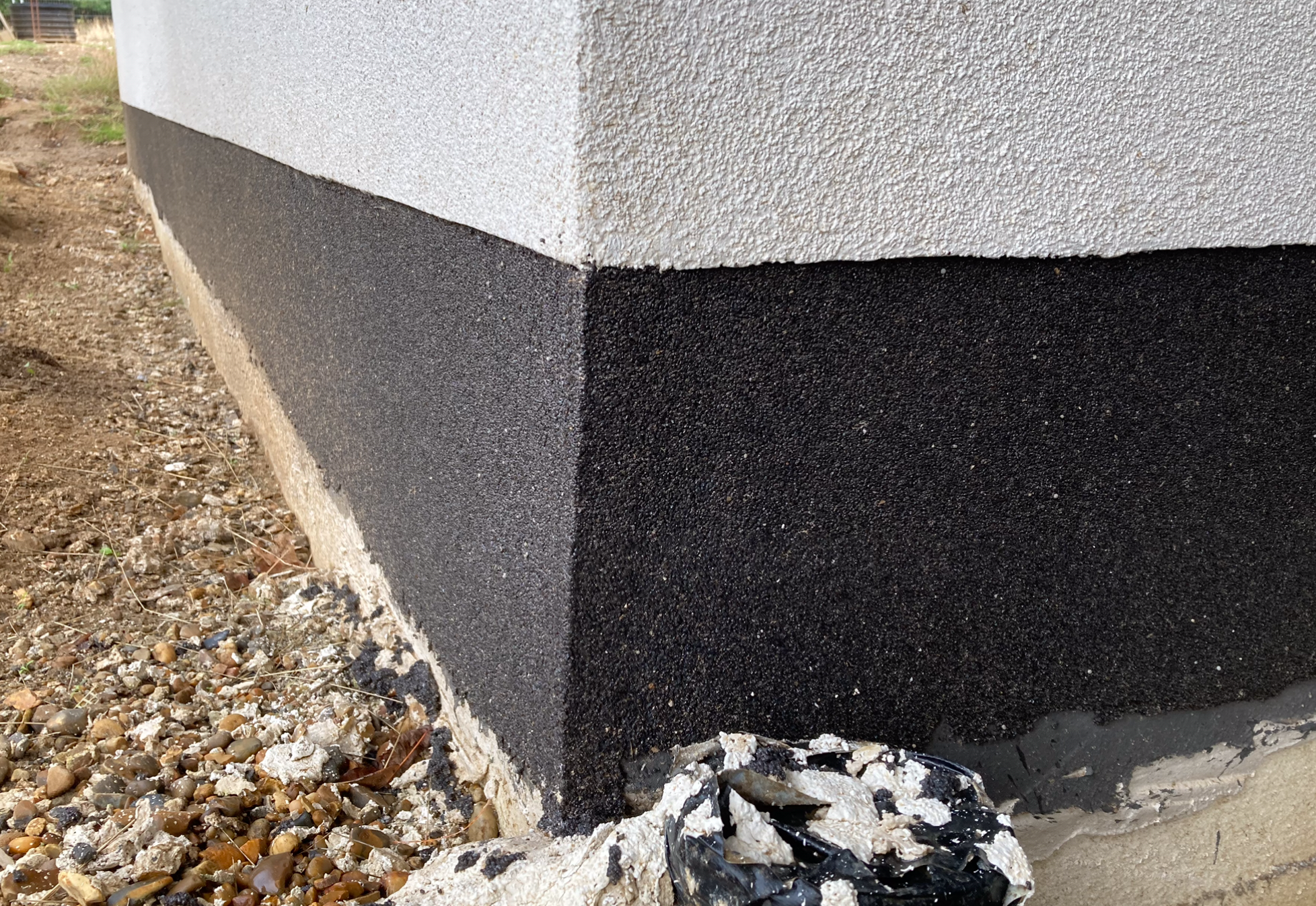

Nick Laslett Posted September 11, 2025 Posted September 11, 2025 (edited) 2 hours ago, WiltshireLink said: Thanks so much! Did you use a peel and stick membrane as well? I used Thermohouse for my ICF blocks, they are Irish based. According to their technical specs, there is no additional sealing needed at the slab/wall junction. I have an insulated raft and the ICF block overhangs by 9mm. The walls are rendered and there is stop bead along the bottom edge. The EPS upstand of the insulated foundation is rendered with EWI Mosaic Render (EWI-050). Here is a picture. We used the Triton TT as a DPC on the EPS of all the rough openings of the doors and windows. Thermohouse have specific ‘check reveal’ blocks for window and door openings. There was a discussion about water ingress at the wall/foundation junction in this thread. My post in that thread. Quote I assumed the shear weight of concrete in the wall helps slow the water ingress? On my build the ICF overhangs the insulated raft by 9mm, this is before the 10mm of render. The DPM laps over the top of the foundation insulation. Not had the rendering done yet, but assume there is a drip edge. They used PU foam when putting the blocks down, which I know is not water resistant. Perhaps I should use some TT Vapour Membrane paint along this edge. The good thing about EPS is that the water it absorbs, easily evaporates away, this is what makes it preferable to XPS. I don’t doubt that some water will ingress at this junction, but will it be substantial enough over the long term to cause issues? Response was not to worry. Three years later house seems okay, no evidence of water ingress at this junction. Still have Air Test to come. Edited September 11, 2025 by Nick Laslett 1
