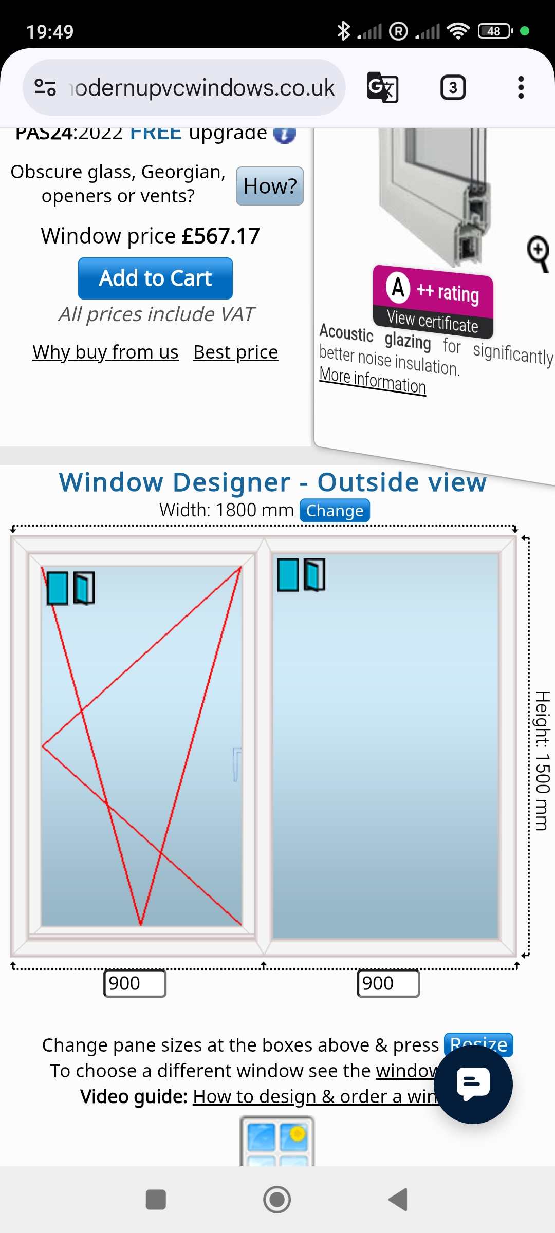

Do you have views on the window? I specced a side hung pane because I assumed it was best to have the hinges on the longest side. But having watched it sag and fail, I don't think the hinges were capable of handling the weight of a 1500*900 3G pane.
I've since fitted some large top hung units which have been great.
Unfortunately I'm struggling to find a company who will sell me a 1500*900 top hung window.
It's the mechanism on the top hung, they generally aren't that great for weight, you're on the verge, if you want to send me a msg I can see what I can do to help.

In other news a tilt and turn will be easy to get.
Is it idiot proof enough though. They're more ingeniously destructive than you could possibly imagine.
I like ModernUPVC, and when I renovated my other house that's who I used. The online quote tool is my go-to device for getting a quick idea of the effect of different design decisions.
However they don't offer 3G sliding doors, and in general their thermal performance doesn't really meet my needs.
