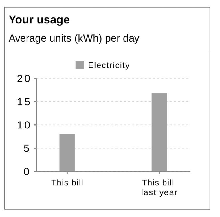

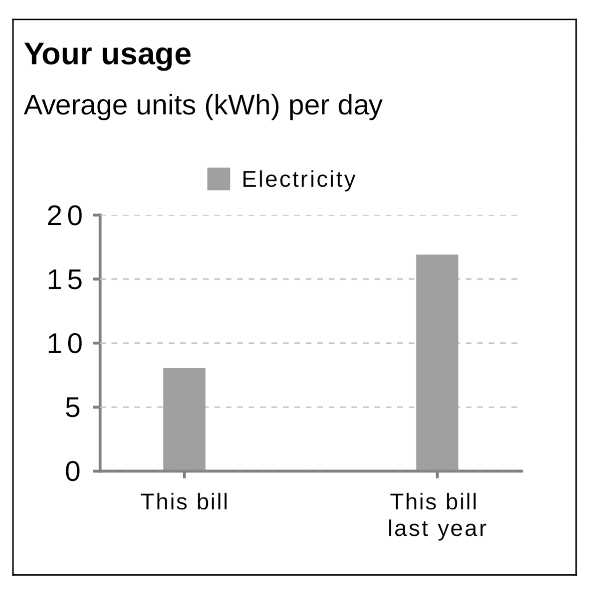

saveasteading Posted September 6, 2025 Author Posted September 6, 2025 On 27/08/2025 at 15:07, JohnMo said: calculate the electricity demand on your coldest day or close to that. I have information. The steading phase 1 (3 bedrooms ) has been in use for a year or so. A self contained unit of 107m2 gross internal. Ufh to the ground floor and radiators 1st floor, all from an ashp. All electric, No solar or battery. The power used has been rigorously recorded from monthly bills. Nov to March inclusive we will consider to be winter. 0.19kWh /m2 /day average Cost £200 / month use winter Summer £20/month. The insulation is good but to conversion standards, not new. Also the surface area is very high compared to floor area. And it is Highlands. So for a chunky building in SE England it should be much less. So I think I may simply forecast the barn conversion use as kW/m2 x our floor area. 0.19 may be extreme as an average but a decent guide as worst case. Any thoughts or your own numbers?
JohnMo Posted September 6, 2025 Posted September 6, 2025 19 minutes ago, saveasteading said: 0.19kWh /m2 /day average Suspect a cold day would be about 50% higher than the average. So if your 200m² (add your own area) that's about 50kWh to cover all consumption on the coldest day on cheap rate - let's assume Cosy tariff for now. 50kWh a day is around 2kWh per hour. Cosy gives 8 hrs of cheap rate, so that's 16kWh (2x8) and needs battery for 34kWh. 34kWh/3 needs just over 11kWh battery to cover all electrical demand on cheap rate on the coldest day, if charged three times. The shortest cheap tariff period is 2 hrs, so you would need a 6kW inverter to comfortably to charge. Just add your building size. 1

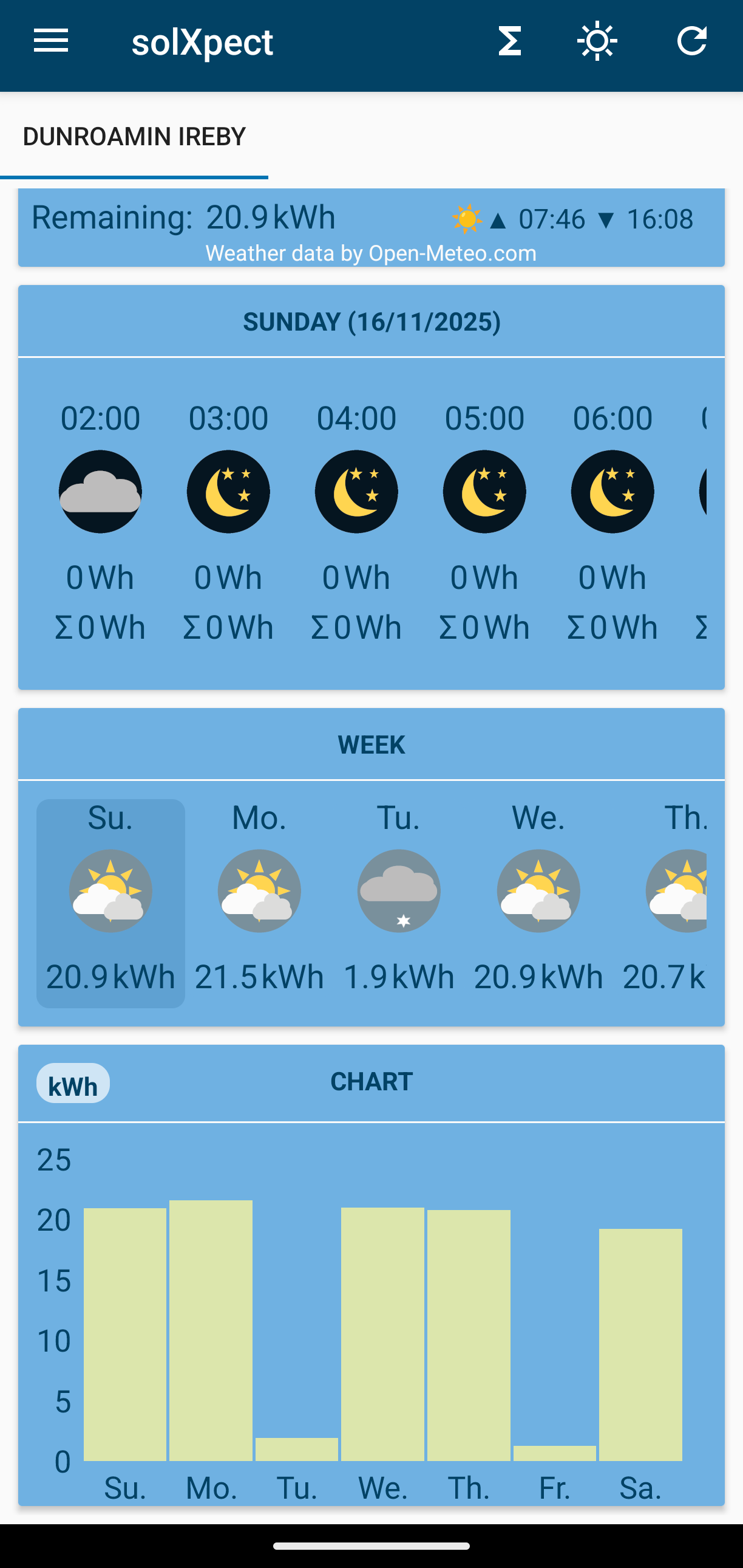

renovator123 Posted November 16, 2025 Posted November 16, 2025 (edited) TL;DR Got ours installed last month. Obsessed with the details now. Energy Savings Trust PV calculator is excellent although we went for double the size. I think you are overestimating the number of panels that will fit. They are big and don't come in that many different sizes or shapes. Similarly crap solar PV forecast in my location, but it cut our usage by 50% in Oct-Nov. Ours is the SE roof only, 45 sq m in 22 panels giving 9.8kwh peak, house footprint is 75 sq m, generated 6.5kwh last month with a large battery. Info dump to follow. Scroll to pics. Estimated solar PV needs We started off with the Energy Savings Trust PV calculator, super helpful but it wouldn't do calculations for our size of system and limited our annual electric use to 6,000kwh when it is double that (yours will be on your bill). Solar PV depends on location - not just roof direction - west coast UK being the worst area (dark clouds and thick clouds)- put it in a calculator to find out, but it also depends far more on time of year. It can vary a lot between days - batteries will smooth this out - but what you will notice more is exporting excess to the grid most days in summer, and rarely being self-sufficient in winter (depending on your calcs). Several apps will do a daily solar PV estimate if you enter your longitude and latitude, expected system size, and the angle ("azimuth") which is usually degrees from South. Typical roof pitch is 35 degrees. PV Caculator and SolXpress are free ones. You can monitor the predication charts this winter, compared to average daily usage (from your bill). Heat pump cylinder Some of solar PV compatible and some aren't. I have no idea what this means since that's next year's job! Batteries are big They can go outside (under a shade canopy), in garages and I think probably in lofts. Might fit in a garage loft if it has a sloped ceiling. It CANNOT be fully boxed in because ventilation is needed but this can be at the top, sides, and underneath if wall hung. If you put it outside the garage you can hide it with planting on trellis or similar. We can't get them outdoors here due to limited space. Our house layout is extremely complicated with no garage, and internal thick stone walls. We have a 13.5kwh Givenergy All in One battery unit and it fits in a typical "alcove" - its at the side of our disused chimney breast where you might fit a bookcase and takes up almost the full depth and width of the alcove. It is about 1.2m high x 0.65 x 0.65 (I think), above it are 2 small string inverters (Solis ones about 0.30-0.35m deep) and 3 isolation switches plus the cabling between them so basically nearly up to ceiling (which is quite low) and about 0.20m off floor. It actually works well with something similarly sized in the other alcove. It is similar to a 250L heat pump cylinder but boxier, and has string inverters above it (they are not much bigger than A4 paper but shouldn't be right next to each other). You can probably get much smaller batteries but ours is a modular system we can easily add to. It does hum, the smaller string inverters are much quieter. It is a large capacity battery given the size of our panels, although your home is much bigger I think (assuming you have 2 floors) so you might want similar battery size. It is in the office/study and I plan to cover the front of it with (removable, painted) ply sheet with top and underneath gaps for ventilation - luckily we have a MVHR supply valve right above it that gives continuous ventilation moving heat away from it. I wouldn't be able to tolerate working with the hum but it is fine for my other half. LAN cables needed for us (dodgy wifi) go up to ceiling and under upstairs hallway down to router. I think I remember that the battery should be near the string inverters and panels, ours is directly below the middle of the panels. Further away works but you can lose some power I think. You can fit to outside of house under opaque canopy, or in an unheated porch (it will warm the porch a little). They should have shutdown safety features, fire risk didn't come up when were seeing installers but they can get hot especially boxed in. Ours briefly got to 31C in October indoors which is fine (we are in a stone house that doesn't overheat). I wouldn't put one in direct sunlight though. And don't put it in the lounge or a bedroom lol because of the bright LEDs and hum. Wide hallway would be fine, under the stairs if not enclosed by a cupboard. Kitchen or utility would be ok but I would raise it a bit off the floor in case of flood from washing machine. You don't have to have batteries but if you do then you will be able to get the bonus export prices during high demand, and it will pay for itself quicker, and in winter yoy can charge batteries from the grid at night for us in peak hours on gloomy days eg 5-7pm when it is dark. Calculations example 43sq m of panels (22 panels), all SE facing, 9.79kwh peak, 13.5kwh storage, West of UK (poorer solar irridiance), no shade, typical usage 13kwh/day. Installed last month (mid Oct), first electric bill since showed 50% less electricity usage. Our typical electric bill is £120-150/month, in summer we except export amount may cover the £13 standing charge and zero usage. 13kwh/month going up to 15kwh in spring, autumn and winter once we get a ASHP and EV. For us at the moment (mid Nov which is the 3rd worst solar month, we are in the west coast, by hills), today Sun is forecast 18.6kwh, Mon 21.5kwh, Tue 3.8kwh but last 2 days were less (storm and power cuts). Our usage is 13kwh/day (no heat pump yet but an electric immersion heater runs the hot water, induction hobs and electric oven). Our batteries are 13.5kwh so these few sunny days this week will be self-sufficient and charge our pretty flat batteries enough for an extra day (75 sq m footprint, 9.8kwh system only on the SE roof so not ideal setup. BTW we have A LOT of battery given the number of panels, and the fact we only use 13kwh/day. Exactly 1 month after getting solar PV our electric bill was halved (and that's for October!). We haven't yet got income for exporting and the standing charge came to £15. We are expecting close to 100% electric met by solar in summer because there won't be a heat pump on. It will be a 8kwh heat pump with SCOP approx 4.2 so should run at about 2kwh when it's on, given it is an old house it will need more heating than many. We don't know how not having an immersion heater will reduce the bills. We can decide after a few years on whether we should do the NW roof, since adding to the system is cheaper than the initial install and we won't increase battery capacity. It is a modular system so adding or upgrading the string inverter plus the new panels is all that is needed, but pv panels may have improved efficiency by then. We went for extra batteries to smooth out the times when there are several darker days in a row particularly in spring and autumn. Payback time In general UK solar PV payback time should be 7-10 years usually (it is better if you have some batteries), occasionally up to 15 years payback but it can be up to 20 years for direct North facing. (This is assuming that you are getting hot water from electrics.) For us having off-grid generation and battery use during power cuts was about 2.5 years extra payback time. Electricity standing charge currently approx £0.50/day (£15/month) but this can be offset by money from exporting. MCS certified installers will do very helpful calculations for you including estimated kwh, price savings and payback time. Some energy companies will give you a much higher export rate if you get them to do the install as well. Export rates (SEG tarrif) can be anywhere from 1p/kwh to 21p/kwh and you need a smart meter (with a working half-hourly signal) for this Power cuts If you want to generate or use your solar for the ASHP during powercuts you need extras eg a gateway (often there is a single plug EPS that can work from batteries but solar PV generation disconnects for safety during power cuts. We had 3 brief power cuts during the storm Fri/Sat but being November and dark already the battery was empty (we plan to tweak the settings to reverse some battery for the next power cuts, we had 30 last year!) Heat pump size has a big effect here, and that is based on insulation (especially wall insulation vs uninsulated solid walls and windows) - assuming here that loft insulation is topped up as needed for the heat pump BUS grant. So 8kwh heat pump vs 15kwh heat pump dramatically alters what electricity you need from autumn to spring. The gateway for off grid needed to be near our consumer unit, which is actually in the lounge, we have the gateway outside directly through the wall to the consumer unit, it is I think 30-35cm deep, not that big and wall mounted under a canopy (rainfall is heavy here, and we get wind driven rain from that side, it is IP 65 or 66 rated. Panel choice Vertical panels aren't as good because they don't get as much light as roof panels. Integrated solar (that looks like roof tiles) generates maybe 10-15% less than "on roof" but are far better in strong winds and there is easier cleaning and maintenance with no need for netting to keep birds from nesting up there. I think your roof surface area calc are most likely too high because it depends on the panels and what sizes are available plus manufacturer clearances from the edge and working around any chimney. If you want to work it out, we just had Viridian Clearline Fusion panels and the sizes and specs are online. Wifi If inverters or batteries are in garage or outdoors then check the wifi signal because although you can do fit it and forget it being able to monitor it and checking when it is at peak so you can run washing machine, dish washer etc will save you from drawing from the grid when out of battery. If you don't have wifi you need to run LAN cables to your router, and possibly between consumer unit and batteries, and have a system allowing a LAN connection. Our installer was crap with commissioning (I was literally reading him the manual) and tried to convince us to "just try wifi" so we had to insist on LAN. EV charger Worth getting at the same time if you don't have one yet. Photos 1. SolXpect forecast graph for week of Nov 16, 9.8kwh system on SE roof in west. 2. Electric bill from mid Oct - mid Nov compared to last year shows 50% less usage, it does not including export to grid but unless we want to pay ££££ we can only export 3.6kwh at once (40% of what we could generate). Edited November 16, 2025 by renovator123 summary needed for this dissertation 2
JohnMo Posted November 16, 2025 Posted November 16, 2025 10 hours ago, renovator123 said: Heat pump cylinder Some of solar PV compatible and some aren't. I have no idea what this means since that's next year's job! If it has an immersion that isn't being controlled by the heat pump, it will be compatible. If controlled by ASHP you may hit issues with the secondary cutout being bypassed. So may need a bit of rewiring to take away from heat pump. 10 hours ago, renovator123 said: Integrated solar (that looks like roof tiles) generates maybe 10-15% less than "on roof" Be careful with those numbers that may be case in a hot country, which the UK isn't. Your maybe nearer say 1 or 2%
