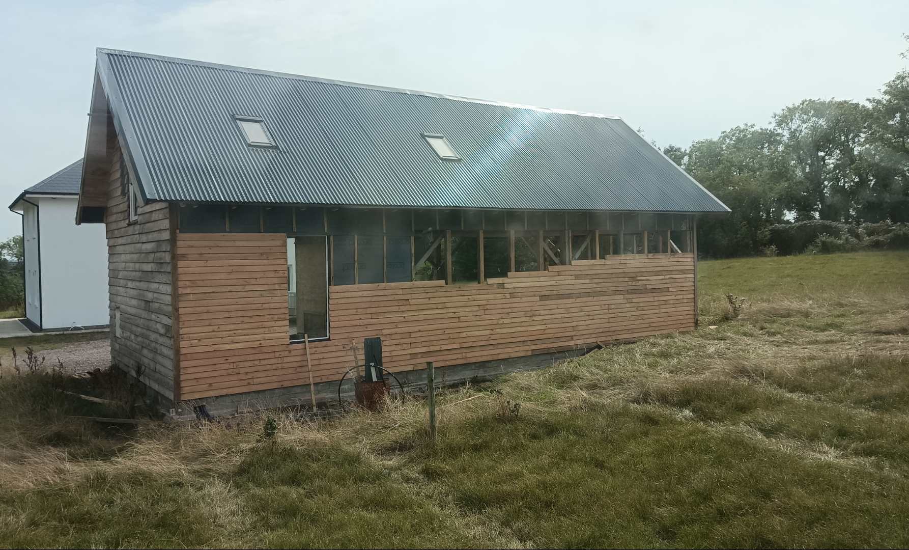

Screenshot_2025-08-29-02-11-11-816_com.google.android_apps.photos-edit.thumb.jpg.de7ab9dd509606564cbefa3c45f64468.jpg
That's the back of my garage roof.
I used the " just start sheeting and see what happens approach" as it was rarely going to be seen.
I cut the corrugated sheet where it landed and moved on. I used the standard keylite flashing supplied.
With some planning it should be possible to get the sheets to have equal gaps on both sides but for a shed I don't think anyone has ever noticed
Edited by Iceverge
For reference I battened and counter battens the corrugated sheeting for ventilation. It happily made the roof lights more or less flush.
I taped and staples the membrane appropriately over the flashing. Laid battles as required for the sheeting and cut it as square as I could to the edge. Seemed to work ok.
