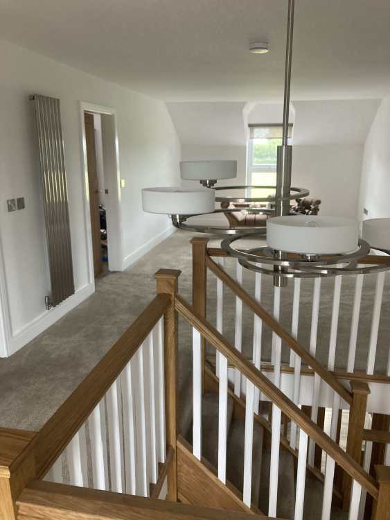

Clark Kent Posted August 20, 2025 Posted August 20, 2025 Had a heat loss survey with a Heat Geek, when it came to the topic of radiators the guy pooh-poohed column rads. He suggested they weren’t efficient and wants to use type 21 or 22. I’m not after using Victorian cast iron ones, just something slightly more aesthetically pleasing. I know that heat pumps run at a low temp so you have to have a decent surface area but I would have thought BTU’s were BTU’s…..
Dillsue Posted August 20, 2025 Posted August 20, 2025 You are right that BTUs are BTUs and watts are watts. No matter what the style it's the output that matters, but..... The output of the rads needed as the flow temperature drops increases quite considerably. Manufacturers supply correction factors for their rads at lower flow temps so once you have the loss for a room you can size the rad for your planned flow temp. I'm designing at 35deg C and have just finished installing the last of the replacement/additional rads and there's some big uns gone in!! Unless a room has a very low heat loss the fancy tall rads without any convectors will likely give a very low output at HP low temps. Do the calcs and see for yourself.
nod Posted August 20, 2025 Posted August 20, 2025 We have eight SS in the bedrooms landing etc We are unlikely to use them But when we have tested them They don’t run hot from a HP The same radiators ran very hot from a gas boiler on our previous build You would have to use them like UFH man’s let them heat up slowly and let the thermostat keep the temperature within a couple of degrees of what you want Our upstairs tracks the ground floor UFH by about 1 degree less Same as our previous
Clark Kent Posted August 20, 2025 Author Posted August 20, 2025 Thanks for your replies. I’ve done a fair bit of research on heat pumps and am quite aware that the rads will probably feel like they aren’t even on. We’re only putting them upstairs as we’re having UFH downstairs. So basically without the convector's the column radiator isn’t as efficient and will need to be even bigger to work with the low flow temps?

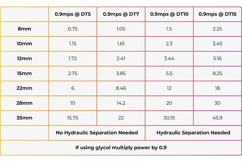

JohnMo Posted August 25, 2025 Posted August 25, 2025 Pretty simple cheat sheet below. You really want to aim at zero hydraulic seperation. So 8mm will carry 0.75kW at a dT of 5 etc.
JohnMo Posted August 25, 2025 Posted August 25, 2025 7 minutes ago, Michael_S said: 3.85kw Why do you need rads doing that output with a heat pump system? If you room has that heat loss you must be living in an open shed. Flow rate just sets dT, it is the mean radiator flow temp that sets the output. 9 minutes ago, Michael_S said: takes a long time to warm up after a cool down Why would you cycle the system on and off, or do you mean something else?
