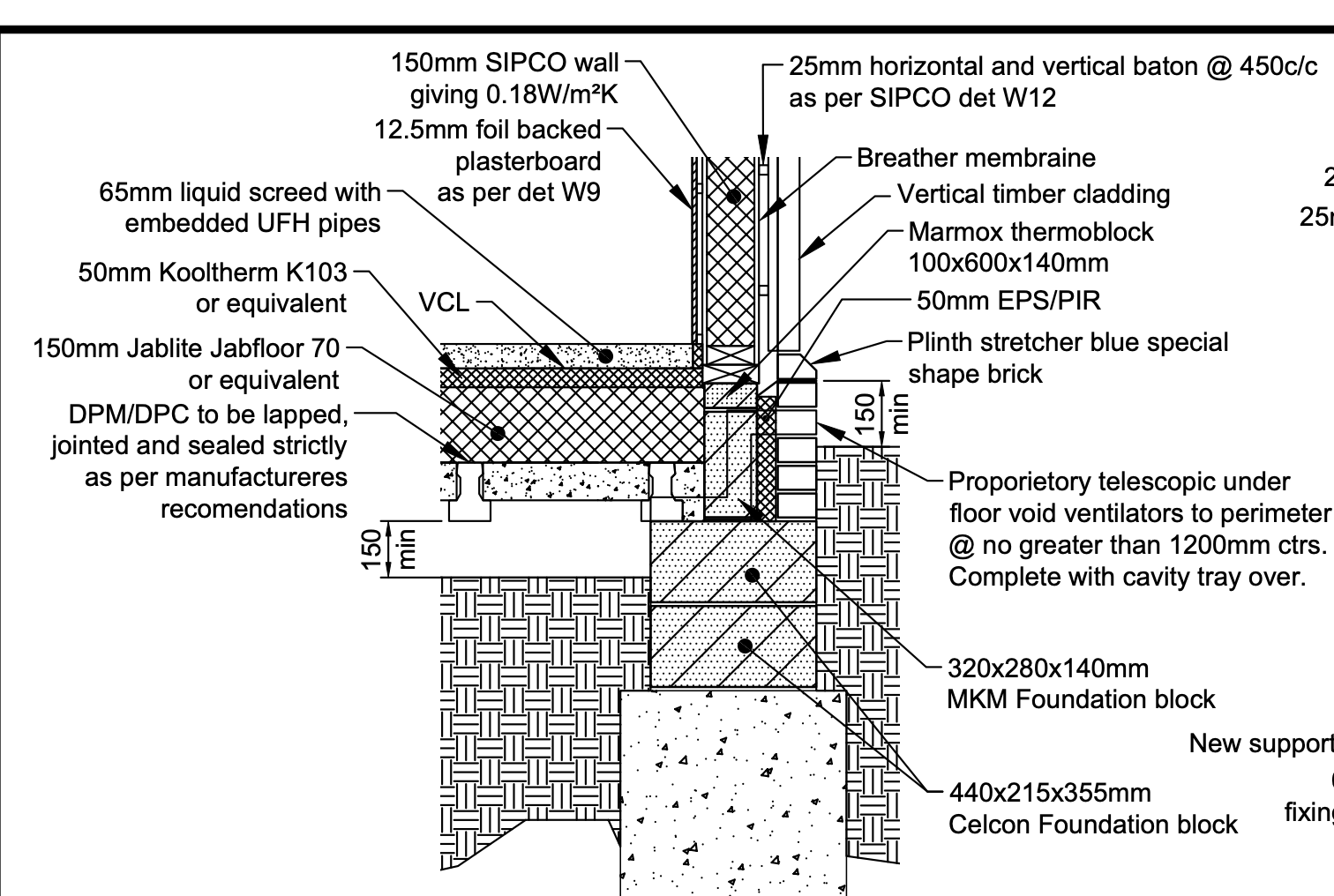

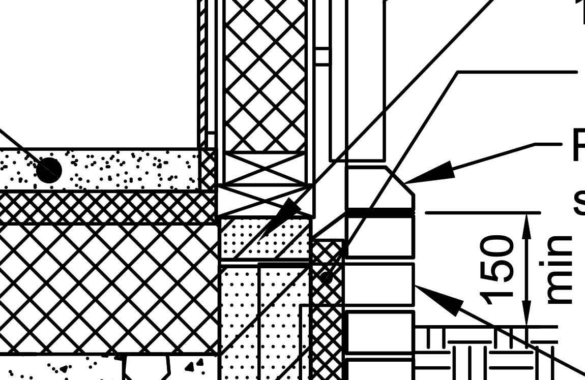

  1. it's pretty hard to see as the scale is quite small but I do have a 25mm PIR up-stand at the edge of the screed. I Guess I could bring the 50mm EPS/PIR up to/slightly higher than the sole plate. I haven't had any design drawings back from SIPCO yet but their standards don't show anything to insulate sole plates. I did wonder how these work in reality, you have a nicely insulated SIP panel just nailed to a pice of timber which is fixed to an existing outer wall. Even if you we're building an entire new build out of SIP's you would have lots of similar details like this at corner junctions and window reveals etc so I didn't think the sole plate would be a massive cold bridge. In fact, do I really need to use a Marmox block?!?
  2. @Redbeard thanks for replying. There's 50mm EPS/PIR up to the Marmox black. It's un-dimensioned currently though

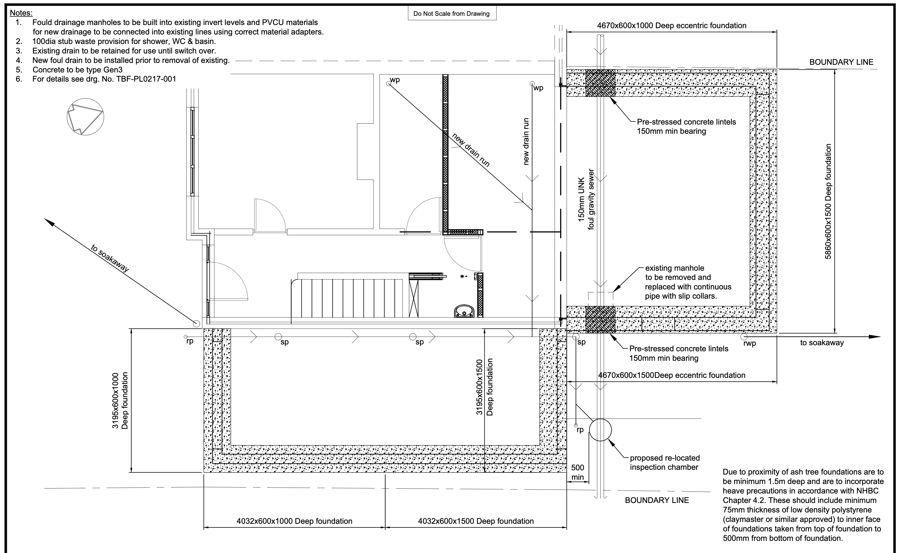

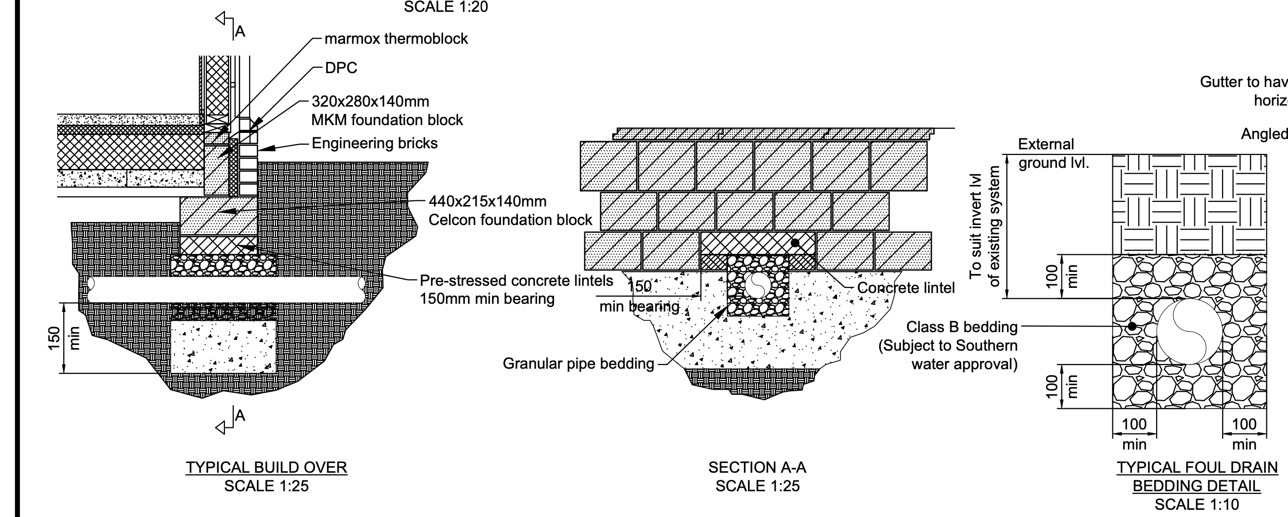

  3. Hi Would be grateful for any feedback on these details. It's for my own extension, first time doing building detailing etc so if there are any schoolboy errors please let me know. The build is for a SIPS extension, I know it's probably very light but the proximity of neighbours tree means I've had to go deeper than standard. I've attempted to design out any thermal bridges, hence the use of a Marmox Thermoblock....hopefully this will mitigate any danger of condensation on the sole plate that I've read about. Thanks for the help in advance!
