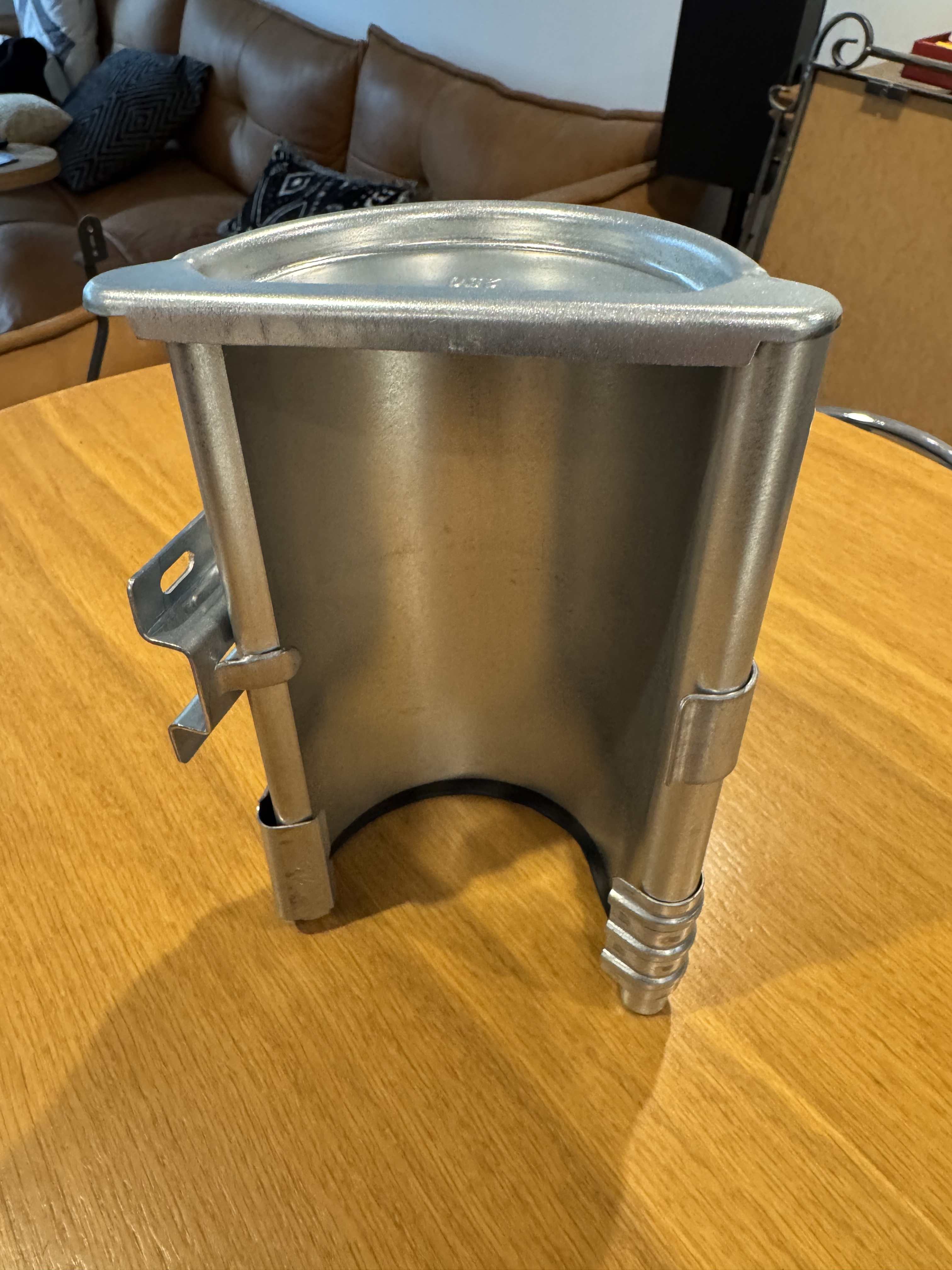

saveasteading Posted August 18, 2025 Posted August 18, 2025 4 hours ago, Pocster said: Thinking this might look smart That's the look I had in mind, but colour coated. That's nicely big too.

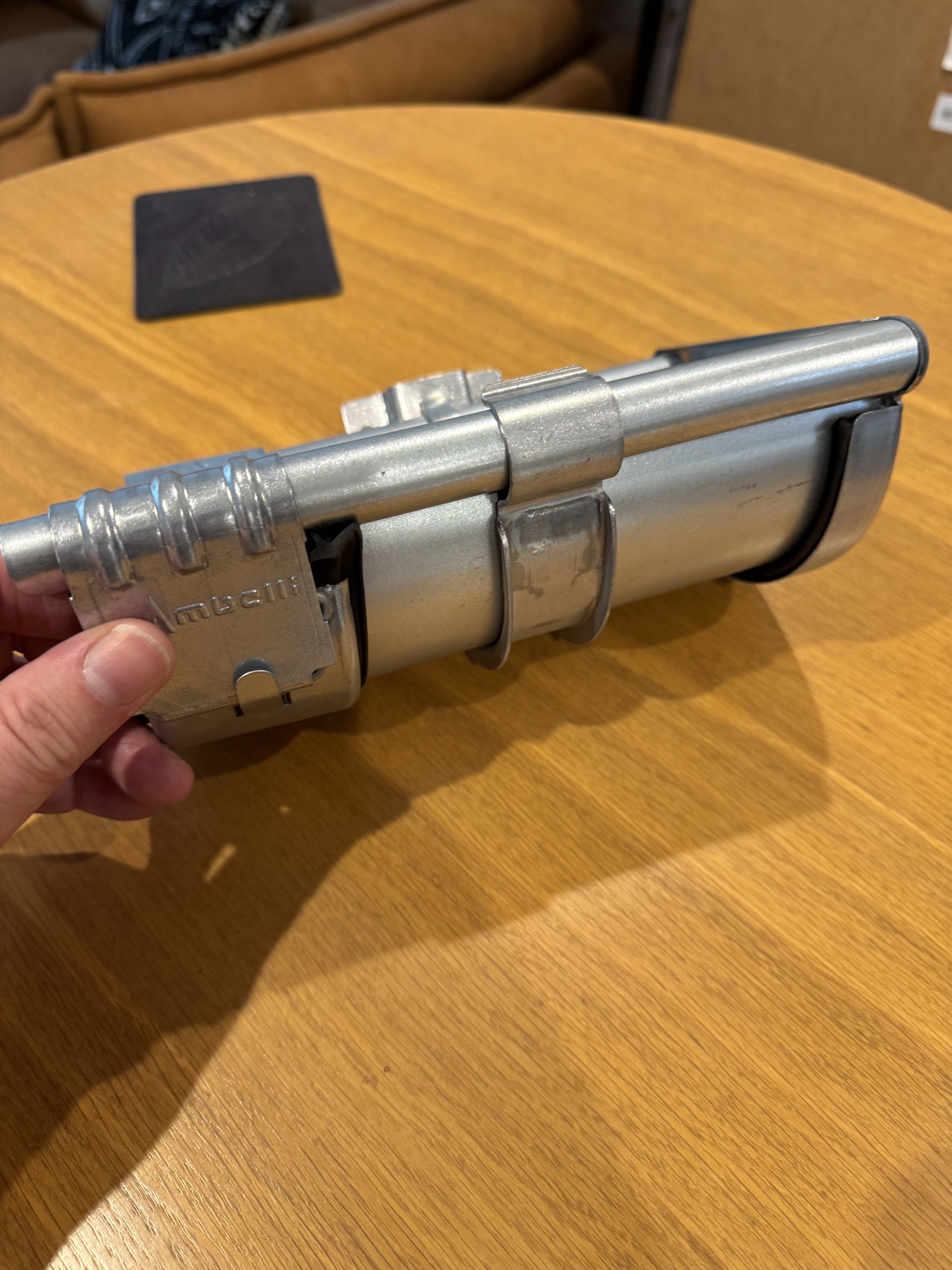

Pocster Posted August 20, 2025 Author Posted August 20, 2025 Crumbs ! Ordered sample yesterday. Arrived today ! Not just a tiny slither either ! I will be ordering from https://www.tradewarehouse.co.uk/
saveasteading Posted August 20, 2025 Posted August 20, 2025 38 minutes ago, Pocster said: Not just a tiny slither either That's not big. Not what i would use. It will need a fair slope, a good outlet and a means of avoiding splashing st the entry.
Pocster Posted August 20, 2025 Author Posted August 20, 2025 5 minutes ago, saveasteading said: That's not big. Not what i would use. It will need a fair slope, a good outlet and a means of avoiding splashing st the entry. I mean that’s just a free sample !!
saveasteading Posted August 20, 2025 Posted August 20, 2025 There is a bigger option, but the rectangular ones are bigger yet, and will be easier to fix / look better?

Pocster Posted August 29, 2025 Author Posted August 29, 2025 (edited) Well I got this galvanised guttering . The end cap has a special edpm end strip that lets it fit on the guttering easily - the sample is the half circle guttering . So the sample is great . I ordered the box guttering No edpm strip ; end cap simply can’t marry up to the gutter . A few emails to the company I get my answer . You’ve got to bend the end of the gutter , get the end cap on - and then hit it 🙄 Assuming it’s anywhere near ‘on’ you then fold the seams over . Bit shit if you ask me . Guess what - it leaks ; what a surprise! ct1 on the inside around that ( crap ) joint should fix it . Is it even possible to make a waterproof seamed joint like this ??? - I can’t see how . Edited August 29, 2025 by Pocster
