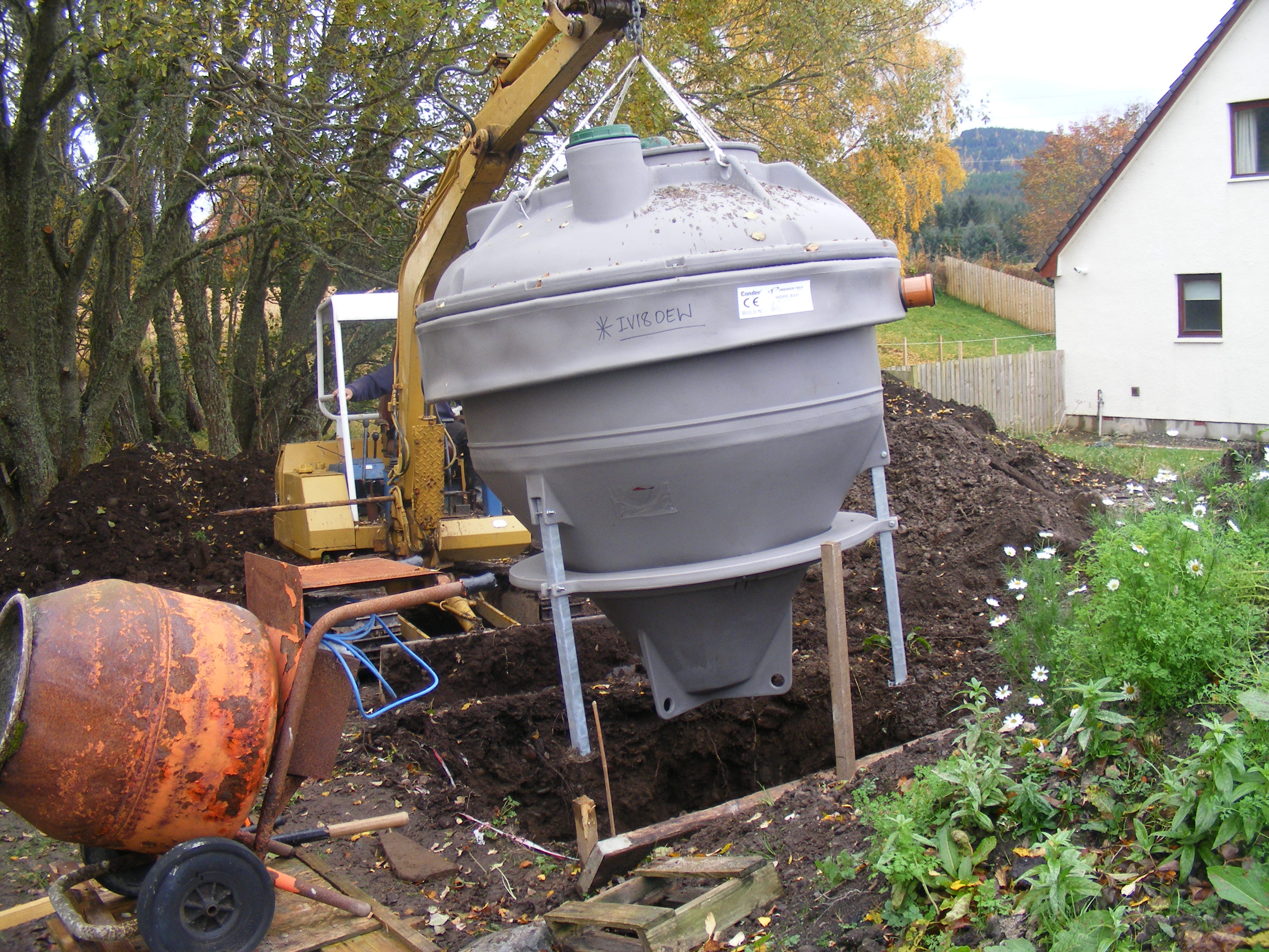

Jeremy Harris Posted June 17, 2016 Share Posted June 17, 2016 The concrete around a treatment plant is to anchor it and stop it floating out of the ground, not to support it, so hard ground doesn't negate the need for a ground anchor if the area around the treatment plant is likely to get saturated with water. We fitted a concrete anchor ring around ours to stop it floating up, as per the manufacturers recommendation. They can (and do) float out of the ground, as when only partially full (as would be the case with a long neck extension) there can be a few tonnes of buoyancy, and that can easily float a tank or treatment plant out of the ground. I have some personal experience of this, as we buried a Klargester "onion" septic tank on a farm in Cornwall years ago. We just put pea shingle around the thing and backfilled the hole. A week later it had broken free and was sitting on top of the field, just like a damned great orange mole.............. Link to comment Share on other sites More sharing options...

Jeremy Harris Posted June 20, 2016 Share Posted June 20, 2016 17 hours ago, PeterStarck said: Different sewage treatment plants use different methods of installation. Mine for instance doesn't use concrete to hold it down. It has an old 2'x2' stone slab which the base sits on. It has four galvanised angle irons driven horizontally into the sides of the hole which it is strapped to with galvanised chains to prevent lift. It is back filled with sub-base. I chose it because it was a relatively easy DIY. Ours came with the option of a similar ground anchor kit, as an extra. Form the description it sounds very like the one you describe, galvanised angle iron and chains: Because our unit was going to have it's lower 1/3rd below the local water table I was a bit concerned about the possibility of corrosion (and I may be paranoid, but having witnessed a Klargester "onion" float out of a field I wasn't taking any chances!). When I spoke to the manufacturer they said they had moulded in lugs that could be embedded in a concrete ring anchor, as an alternative to using the anchor kit. It was a bit fiddly, as we had to hold the tank up in the air with a digger as a crane, whilst barrowing in concrete around the narrow slot around the tank, then lowering to its final resting place, pumping water into it to get it to sit at exactly the right level. There was a layer of gravel under the concrete that the pointed bit of the tank base was resting in, with the concrete ring above this. Link to comment Share on other sites More sharing options...
ProDave Posted June 20, 2016 Share Posted June 20, 2016 The issue of "anchoring down" the tank was one thing that made me chose the Conder. It has built in legs and the ring around the bottom. So it sits unaided in the hole while you pour enough concrete to encase that ring to anchor it down. Some of tha alternatives that had various anchor kits, seem to involve someone going down into the hole to fix parts of the anchor kit, which frankly sounds a VERY dangerous exercise. Link to comment Share on other sites More sharing options...
