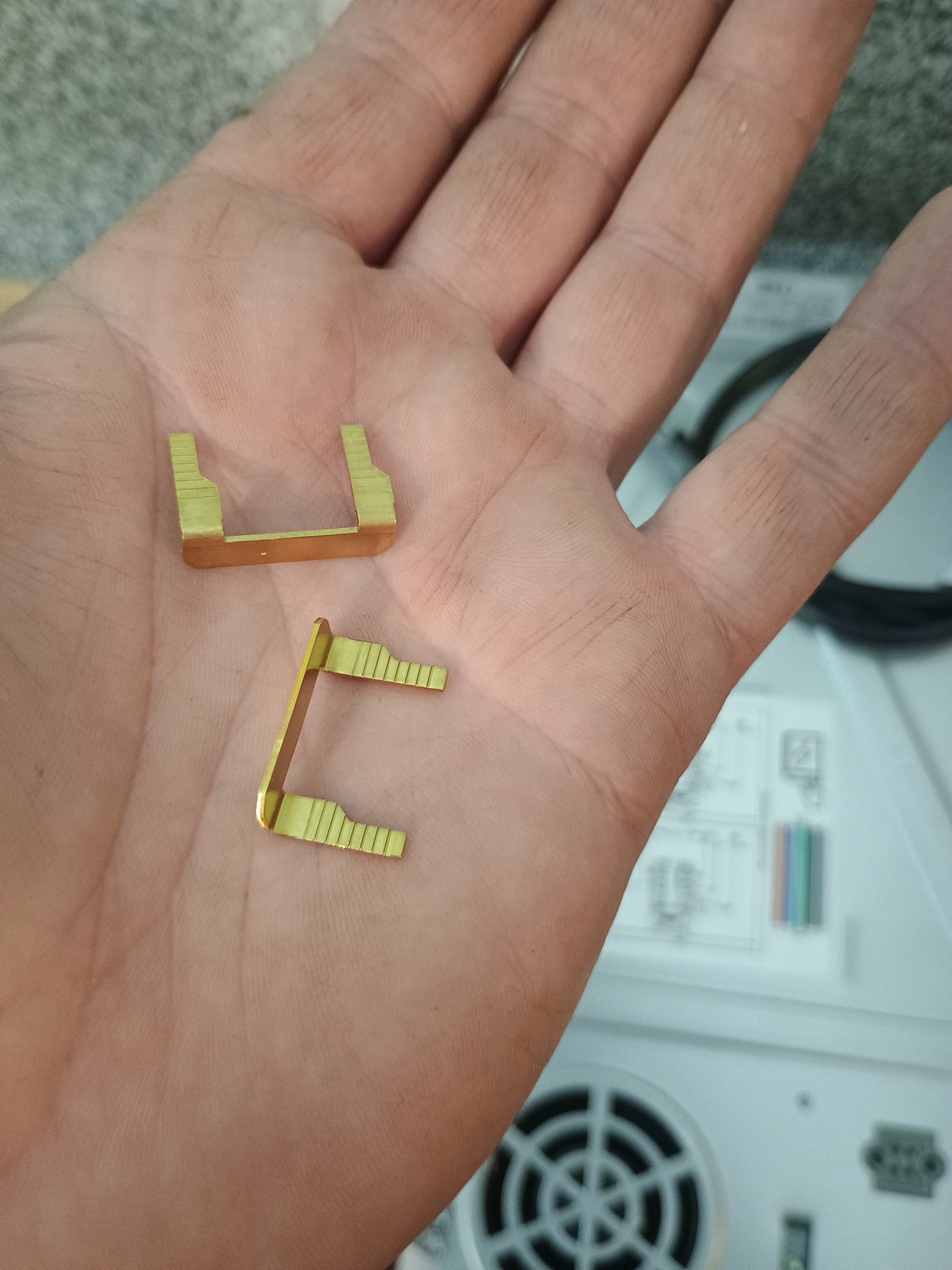

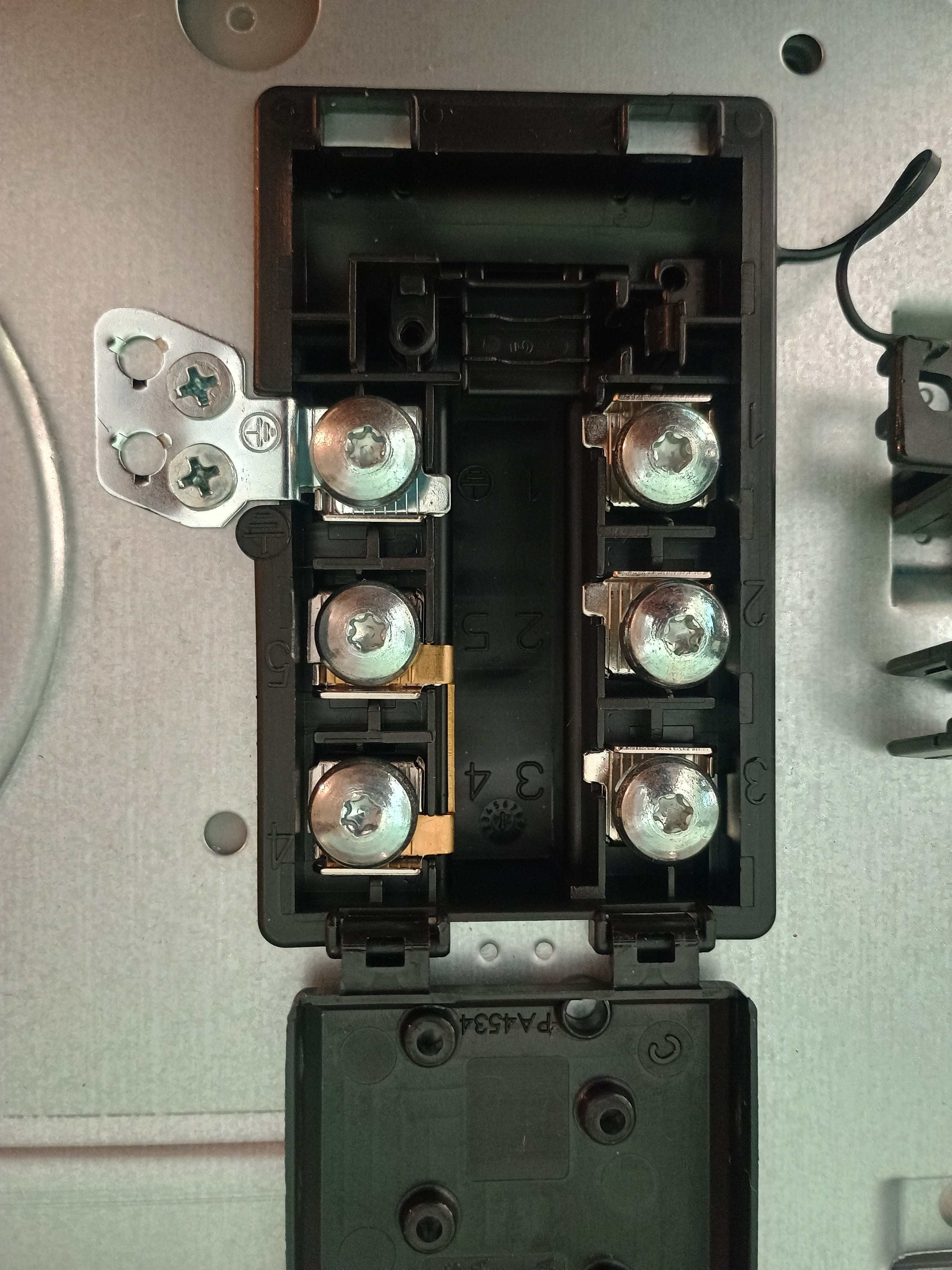

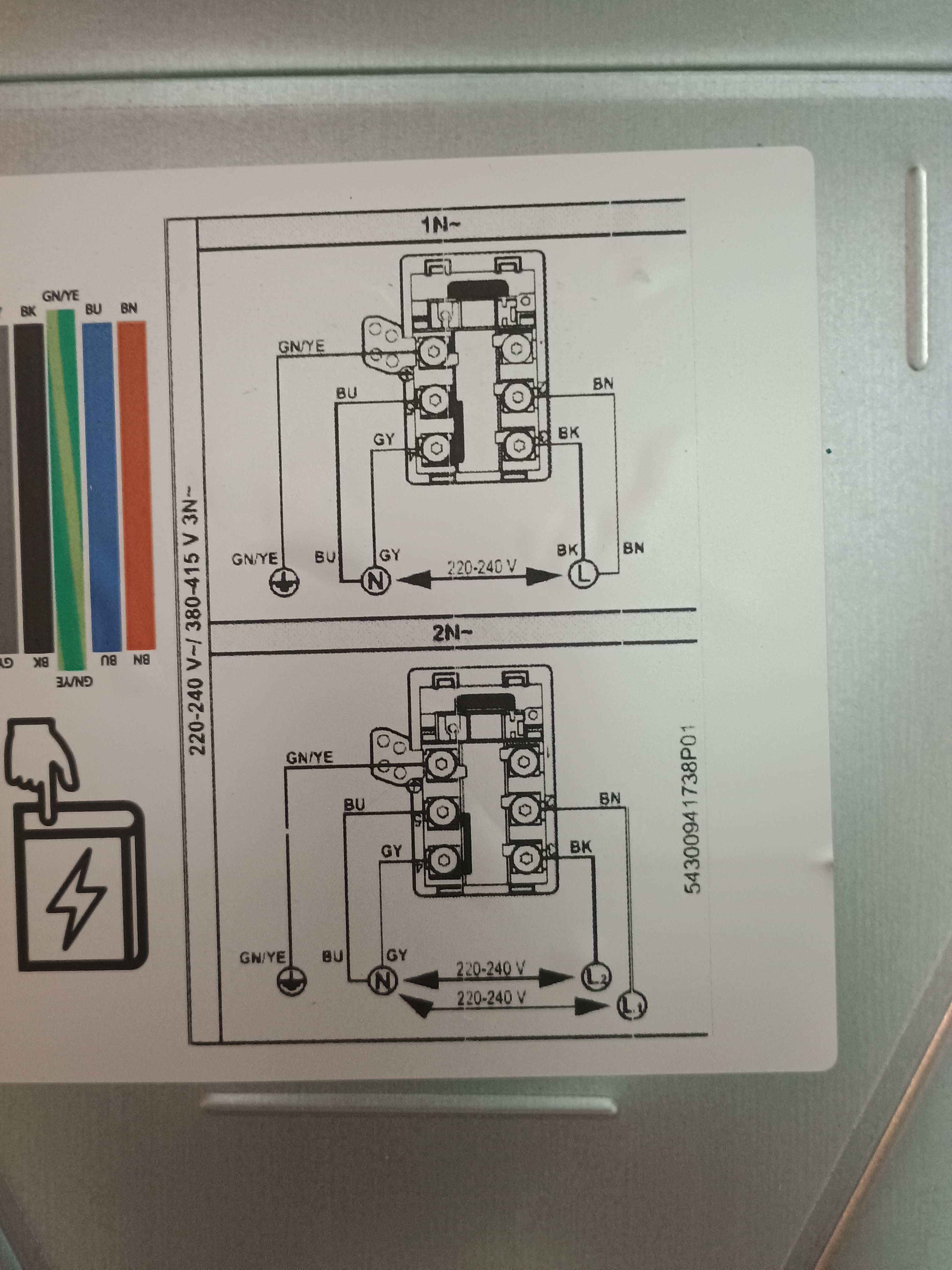

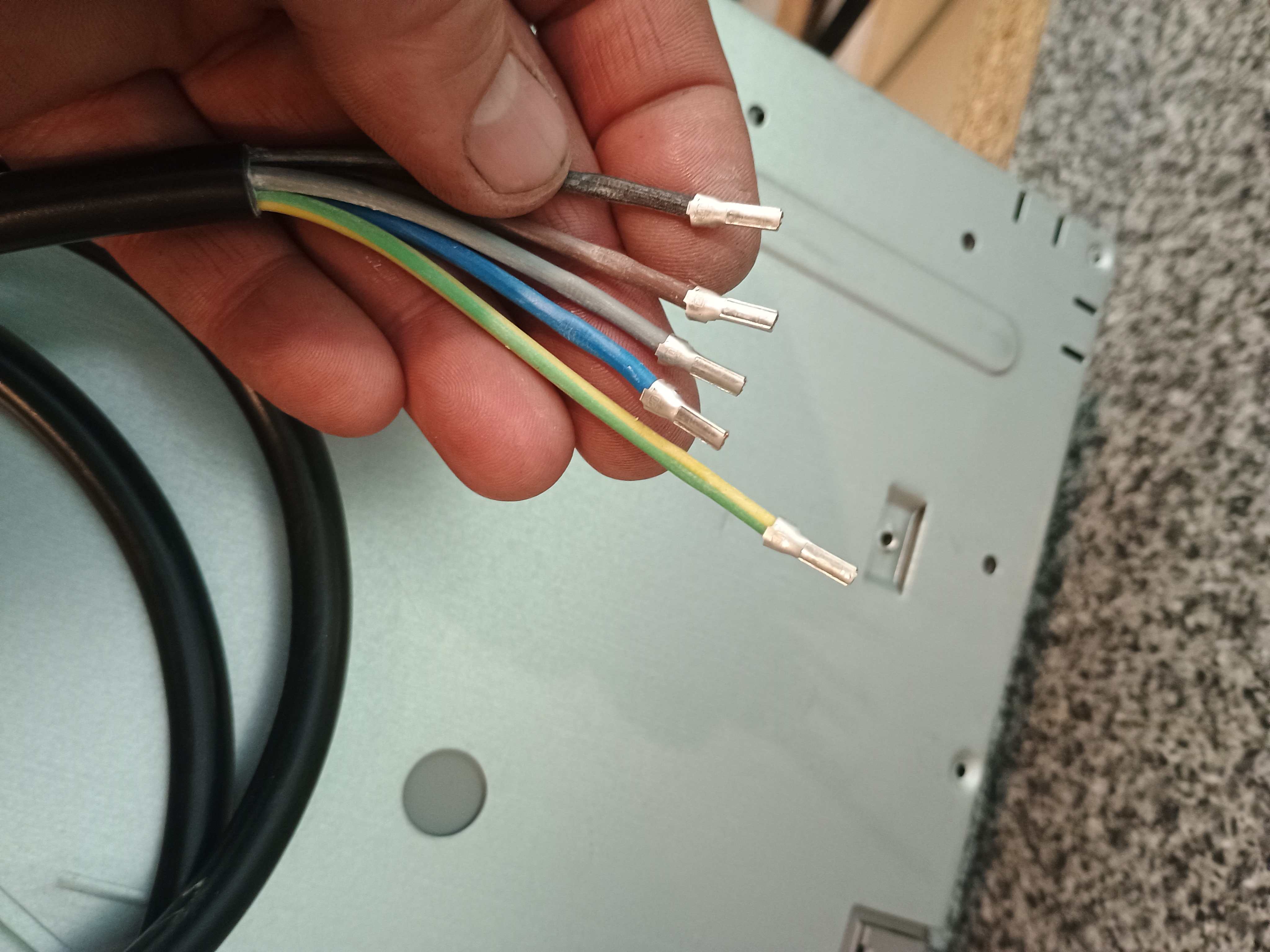

Gave up on trying to fix the old Electra Elecheib induction hob and bought a Bosch. No problem there. The old hob was fed from a length of 4mm² butyl.
The new Bosch can be fed from one or two phases.
It comes with a length of this cable:
So they are suggesting to use this length of cable for single phase operation and just wire the cables in parallel.
However....up top in the terminal box are two brass links. Doing nothing, just sat in a "made for it" plastic slot. They look to be about 4mm². There is however no reference to them in the manual?
I can see no reason why I can't use the original 4mm² cable and then use the links in the terminal box to link 2+3 and 4+5.
I can't fathom why they include the links but don't mention them?

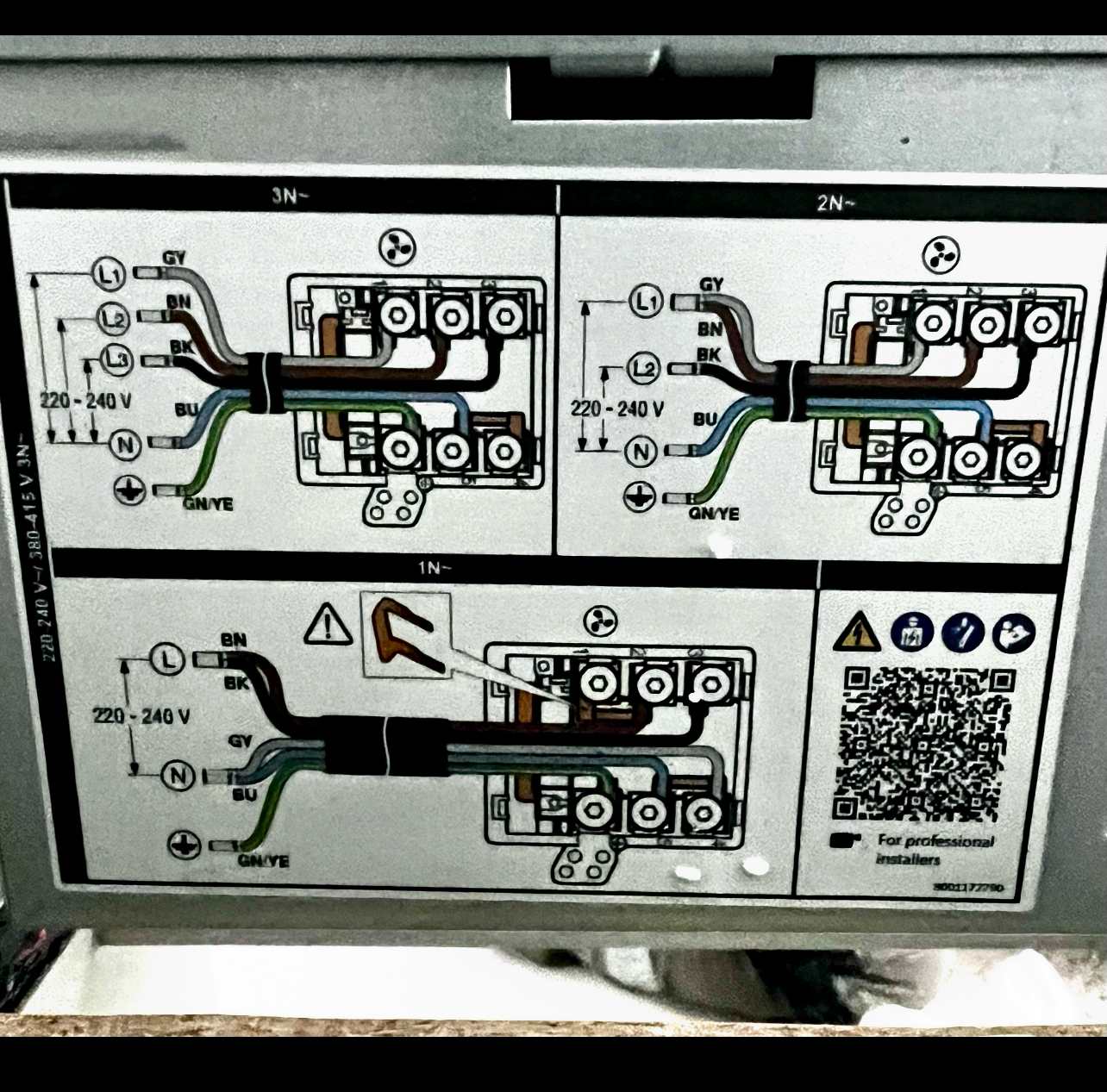

Posted (edited)
That looks similar to our Neff (which had a 3 phase wiring option too) I had to use one of the links (single phase bottom pic) plus there was already a link in place.
Edited by Kelvin
Posted
Just now, Kelvin said:
That looks very similar to our Neff (which had a 3 phase wiring option too) I had to use one of the links (single phase) plus there was already a link in place as I recall.
Pun intended but aren't there links between Neff & Bosch? As in they're the same company? I'd expect parts crossover.
Posted
I’d suggest the links are spares. I had one more than was needed in any of the three wiring options.

I just installed our induction hob last week and it came with the same 5 cable arrangement as pictured above.
Seemed a little weedy compared to the hefty supply from the DB that our sparky ran in. Total power for the hob is 8kw so i was a little surprised just how thin their cables are.
I was also confused by the 5 cables until i googled the subject. Sparky also said either just common the phases together or link them at the hob end with the brass links to achieve the same thing.
