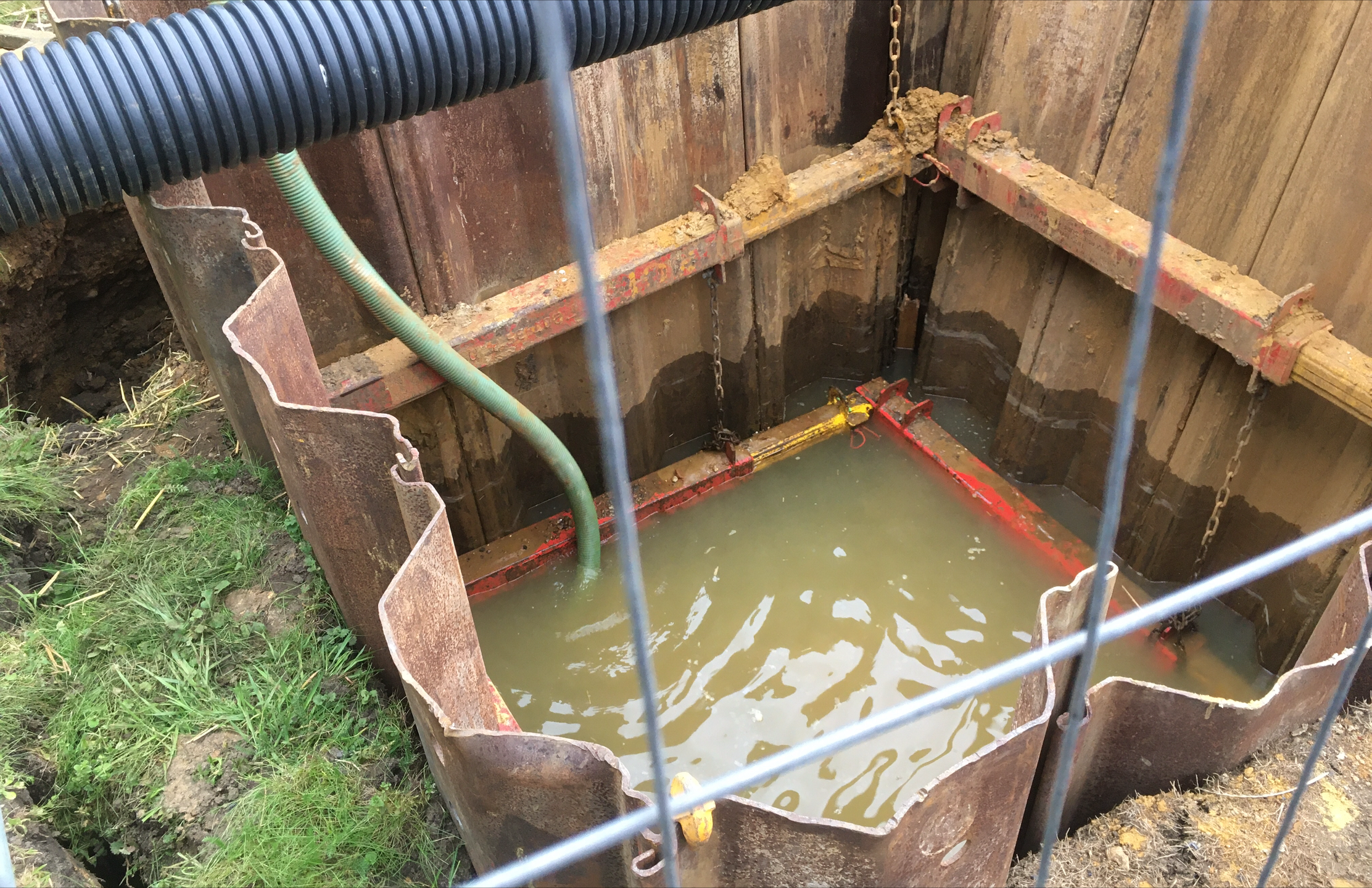

We’ve got a high water table and the groundworkers abandoned the first attempt at the STP, when the hole collapsed. We are in a former gravel pit, so the soil is not robust.
The second attempt was a very serious affair, with another 3 man crew joining the three guys already on site. The shuttering hire, and associated plant, was an insane cost.
Photo from the morning of the install. I have a lot of photos of each step, happy to share, if helpful.
Edited by Nick Laslett
@Nick Laslett Wow that is a high water table. What time of year was that? And you had it specially sheet piled? And your digger guy managed to excavate a smallish narrow vertical hole? How did he do that?
