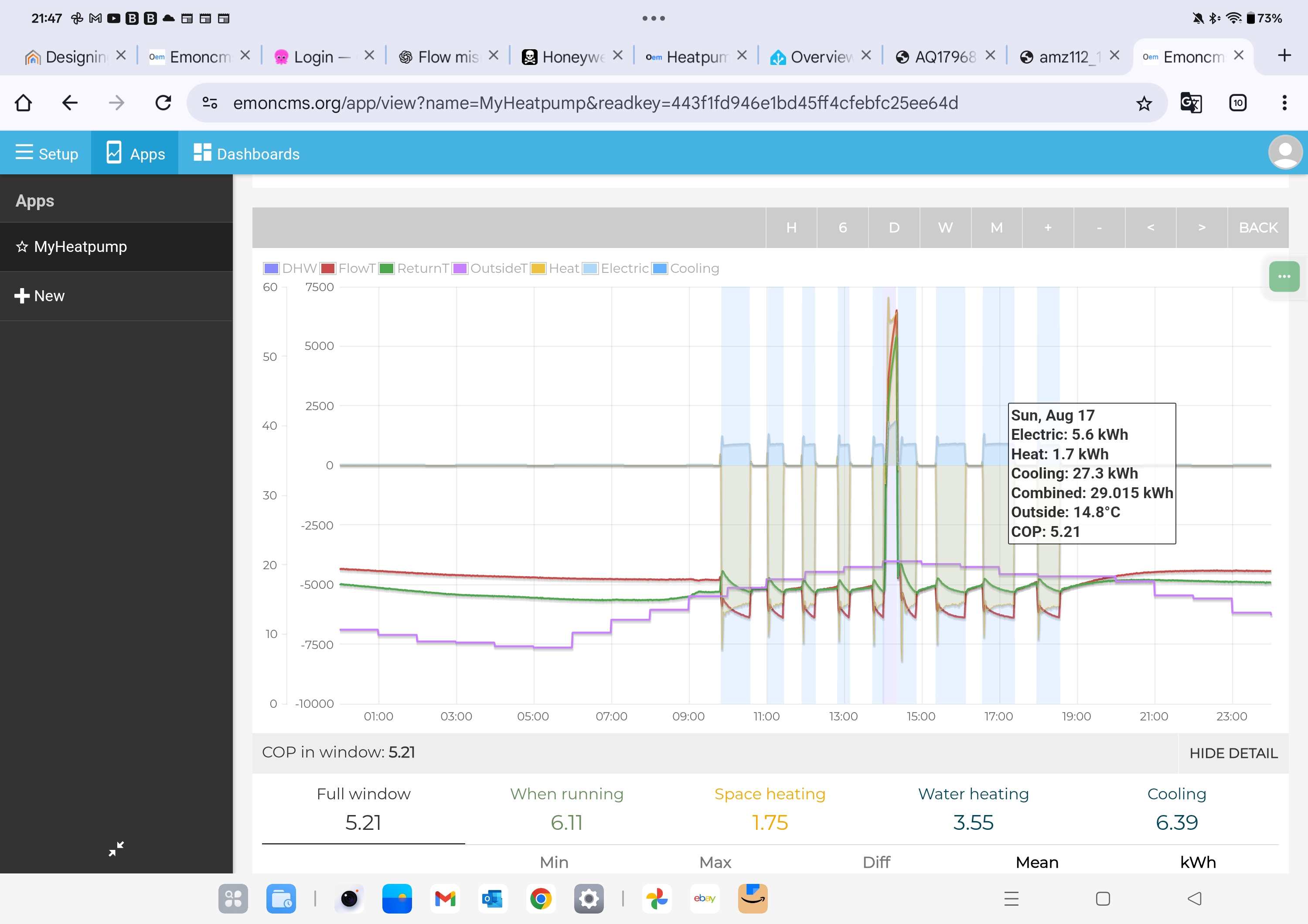

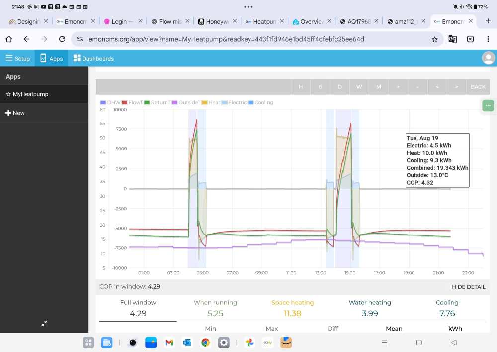

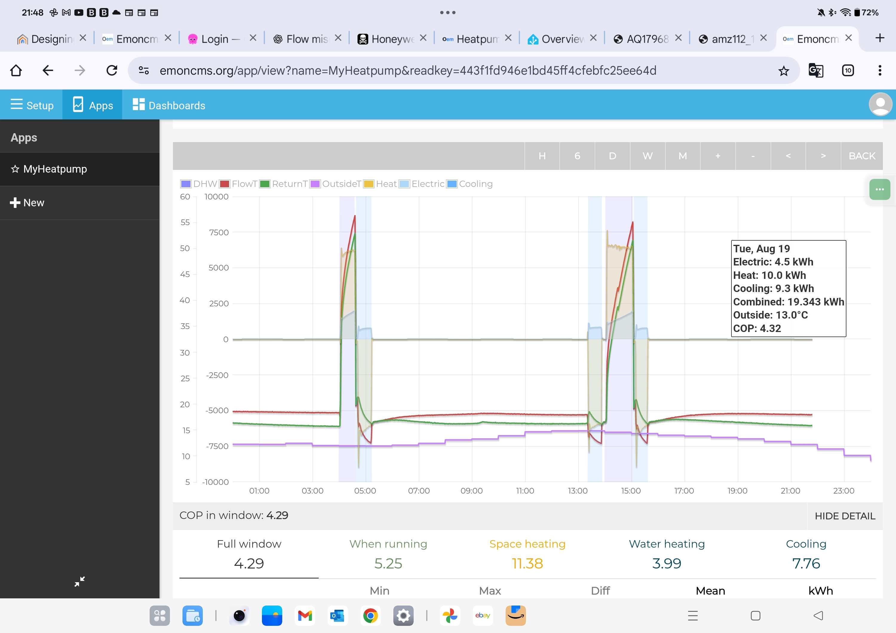

2 hours ago, SimonD said:
the heat pump needs additional feedback
Sorry it doesn't. Two different days this week, doing cooling but the same rules apply as for heating.
First shot a couple of days ago, pretty sunny all day - big spike is DHW heating - does 27kWh of cooling
Screenshot_2025-08-19-21-47-59-49_40deb401b9ffe8e1df2f1cc5ba480b12.thumb.jpg.733147f2814169e5fead76b45be21b91.jpg
Second today, very little sun does 9kWh of cooling
Screenshot_2025-08-19-21-48-53-93_40deb401b9ffe8e1df2f1cc5ba480b12.thumb.jpg.a0dd5074c6938706c51eaa5a3c2f056c.jpg

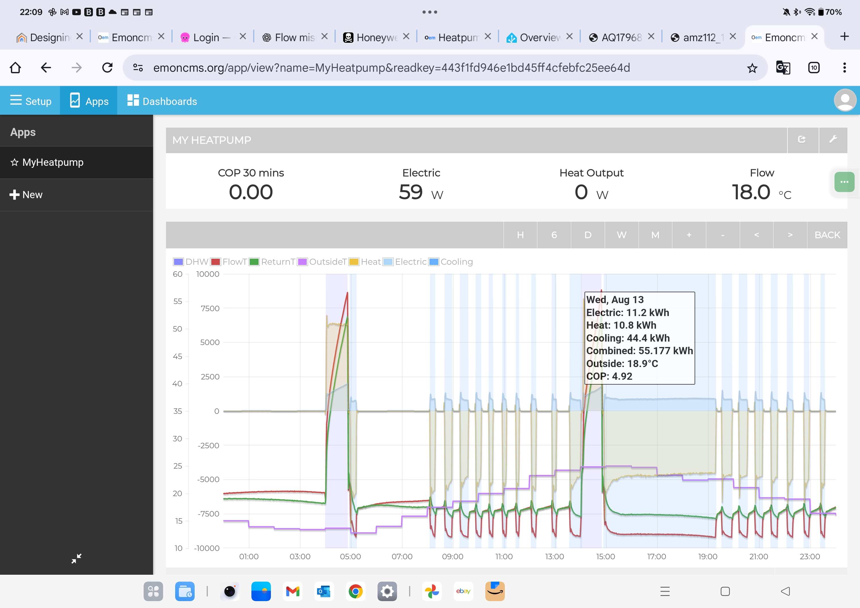

There is no control other than what the heat pump senses, nothing in the house except UFH pipes.
A week or so ago, plenty sun and heat, does 44kWh of cooling
Screenshot_2025-08-19-22-09-03-23_40deb401b9ffe8e1df2f1cc5ba480b12.thumb.jpg.aae4610473a6e1e9648183ea736710b6.jpg
