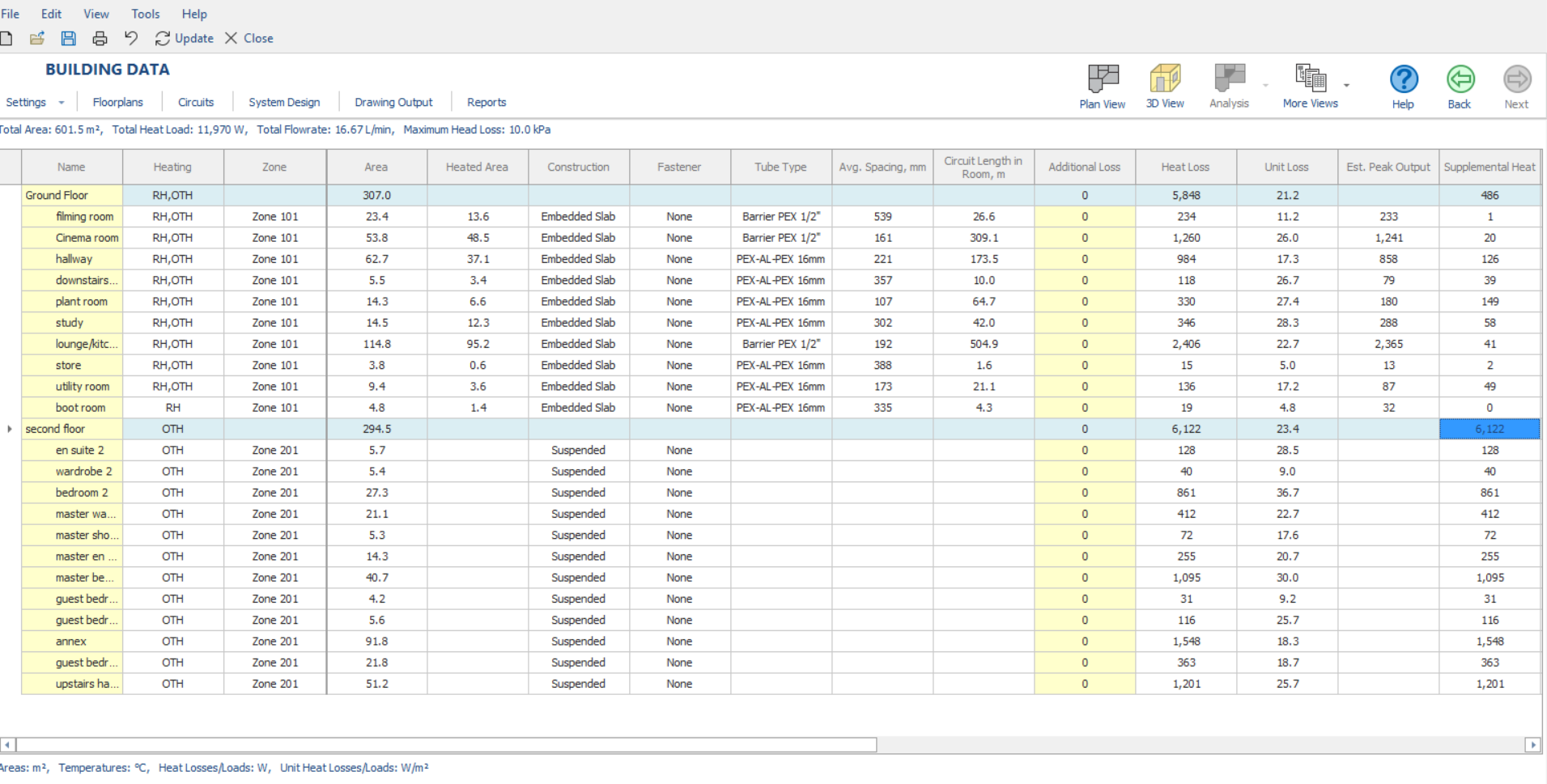

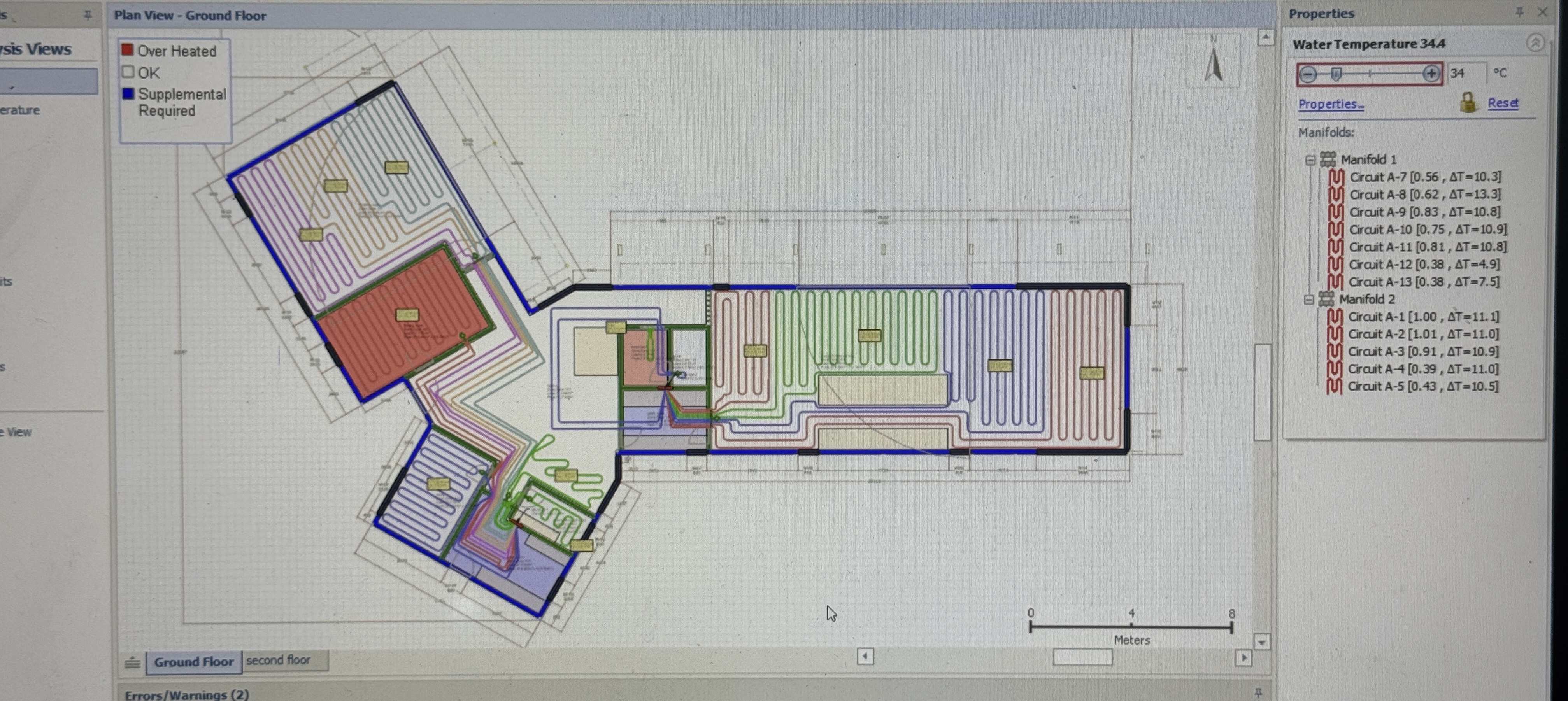

mattgibbs Posted August 10, 2025 Author Posted August 10, 2025 @JohnMo yes it’s 300sqm downstairs and almost the same again upstairs. This is my first design in loopCAD. All spacing is at 300mm centres which based on a water temp of 34 degrees keeps most the house the right temp. There is one room overheating which I can just reduce the amount of pipe work in to compensate is 34 degrees a good temp for the ASHP or should Increase the pipework to 150mm centres and run an even lower temperature? I’ve seen on your other posts you’ve run into trouble with short cycling by running the ASHP lower then 29 degrees. total heating load is coming out at 12,000w but I don’t think it shows anywhere how much the UFH is providing out of that total
JohnMo Posted August 10, 2025 Posted August 10, 2025 Just looking at you Loopcad the dT looks to 10 degs in the most part, you are going to be nearer 4 to 6. So that will drop your flow temp a couple of degrees for the same mean temperature. The design temp flow temperature is only a very short window of the year most the time it nowhere that cold outside. Even for 600m² you heat loss of 12kW sounds very high. Especially for Hampshire.
Conor Posted August 11, 2025 Posted August 11, 2025 I found LoopCAD over estimated heat loss. Says ours was 9kW, reality closer to 5.5kW. maybe I got some setting wrong. I'd reduce spacing in larger areas to 150mm, 200mm in other areas. Flow temp of 32c. Should work well. LoopCAD assumes the UFH is the only heat source, and will give warnings if supplimentary heating is required.,
mattgibbs Posted August 16, 2025 Author Posted August 16, 2025 @Conor It does assume its the only heat souce but it doesnt design the system to heat the upstairs also (unless you have upstairs ufh). see the attached below, the current UFH is providing the 6kw of heat the downstairs requires but the highlighted box shows there is also a further requirment of 6kw for the upstairs. Based on this i would have a 6kw UFH system in a 12kw demand house. Do I double the size of the system to have the full 12kw of heat in the downstairs UFH which would massively overheat the downstairs in loopCAD or just get some electric radiators in the upstairs bathrooms to cover the heat requirments upstairs. @JohnMo Thanks, I increased the flow rate for a total of 16L/m which brought the DT to around 5 and lowered the flow temp to 31 degrees. Jeremys spreadsheet estimated 11,200w heat loss with a 25 degree defecit so its not far off. There is around 200m2 of glazing which is our main heat loss.

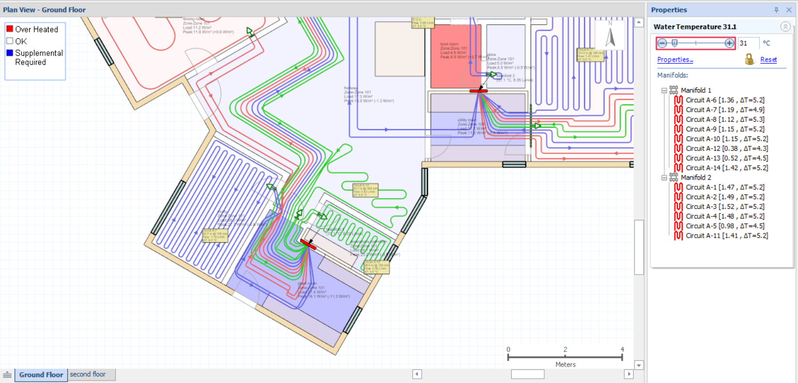

mattgibbs Posted August 16, 2025 Author Posted August 16, 2025 Also does anybody know how i can make LoopCAD count the supply and return pipes towards the room heat. Our plant rooms and hallways show as needing supplemental heating when in reality they are probably going to be hotbox's? Ignore the pipe layout in the triangular room as i still need to space it out. but there is a large amount of pipework in the plant room (lowest room pictured) which is showing as being to cold and same for the hallway but there is no way thats actually the reality.

Conor Posted August 16, 2025 Posted August 16, 2025 Ouch. You'll want to work on that glazing and reduce it. It's going to cost you a lot to run and potentially very uncomfortable in the summer. Has your architect done a full heat gain / loss model?
mattgibbs Posted August 16, 2025 Author Posted August 16, 2025 (edited) @Conor Glass is already all in to be fair. its also mostly south facing but fortunatly our overhangs keep to sun off the glass in the summer almost entirly. But no we didnt do a heat gain/loss model did you have any idea on my comment above about Loopcad only accounting for the downstairs heating requirements? Edited August 16, 2025 by mattgibbs
Conor Posted August 16, 2025 Posted August 16, 2025 (edited) I never had that issue, I put all three floors in to the one model and it gave me total heat demand at the top of the report. Make sure you get an ASHP that can easily do cooling, you're going to need it! You'll fing likes of May and September will be the difficult months and the sun is lower and will bypass your overhangs. Edited August 16, 2025 by Conor

Susie Posted August 17, 2025 Posted August 17, 2025 19 hours ago, mattgibbs said: Also does anybody know how i can make LoopCAD count the supply and return pipes towards the room heat. Our plant rooms and hallways show as needing supplemental heating when in reality they are probably going to be hotbox's? You can change the target temperatures for the plant and hall or tick that they have supplemental heat. sorry my trial has expired months ago now. tip print every thing you can off and save to pdf all the reports so you have a copy of all the summaries and reports loopcad can produce.
