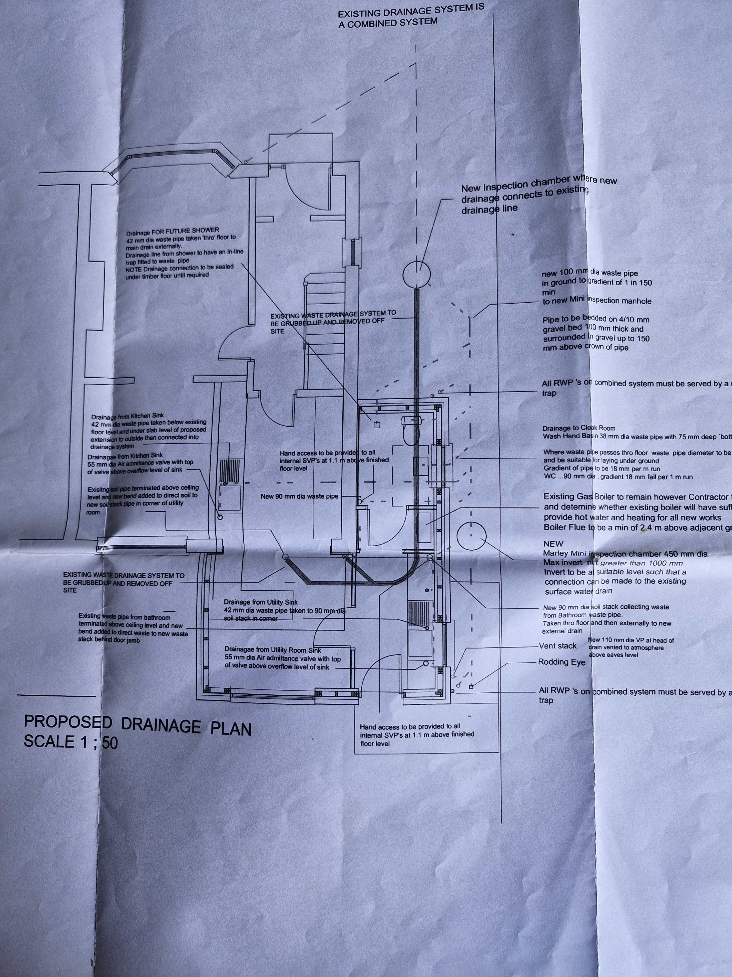

Tennentslager Posted August 5, 2025 Posted August 5, 2025 Father in law was in hospital when builder did his extension and his wife agreed to everything he said. The plan shows new drainage around the perimeter and associated inspection and rodding points. None of this was done and everything ( shower, toilet, sink and rain water) were connected to the existing system which is now covered by the extension which is now complete. Builder was sacked long ago, there was some legal advice and think my relative kept the final payment. He is 85.

ETC Posted August 5, 2025 Posted August 5, 2025 Does it work? Is it vented? Can you rod it? Are pipes properly protected?
Temp Posted August 5, 2025 Posted August 5, 2025 It looks like you have about 6 branches each at 45 degrees off the main run down the side. I think technically you should be able to rod each of these branches but they look quite short. Will probably be OK. The BCO might want to see it pressure tested. Toolstation/Screw fix sell a simple kit with hand pump quite cheap if you need to do that. Make sure all traps have water in them for the test and any open pipes and vents are capped off.
Tennentslager Posted August 7, 2025 Author Posted August 7, 2025 On 05/08/2025 at 21:23, ETC said: Does it work? Is it vented? Can you rod it? Are pipes properly protected? Yes it works Yes it is vented Can't see any way to rod it Pipes are under suspended timber floor in the extension and original stuff is buried If he gets an inspection chamber fitted as per the plan (this was not done) will this be okay to rod it?
kandgmitchell Posted August 7, 2025 Posted August 7, 2025 Well the new IC will certainly help to gain access but you can't rod the side branches from there. This is presumably Scotland so the administrative regs are different from here in England. Has all the work been signed off by BC?

Tennentslager Posted August 7, 2025 Author Posted August 7, 2025 None of the perimeter drains on the plan where put in! All the extension drains are fitted underneath to the existing drains (coloured dark in the plan) So, no IC no perimeter drains at all
kandgmitchell Posted August 8, 2025 Posted August 8, 2025 Assuming BC have signed this off the options are: 1) Leave things as they are and deal with any problems when and if they arise, 2) Leave things as they are but add the IC to at least make some of what's been done roddable and then deal with any problems when and if they arise, 3) Rip it all out and do it properly. If BC haven't signed this off: 1) Let sleeping dogs lie and apply the above options, 2) Arrange for the final inspection and await BC's reaction and deal with their requirements. I can't see many other alternatives
