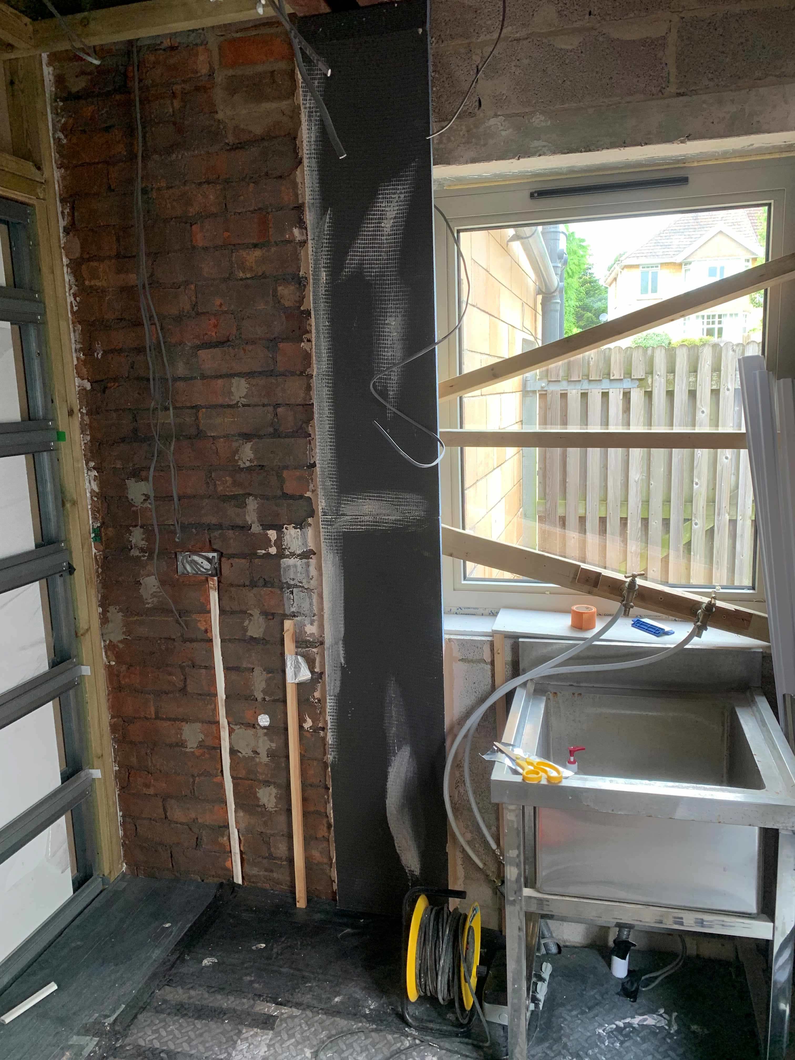

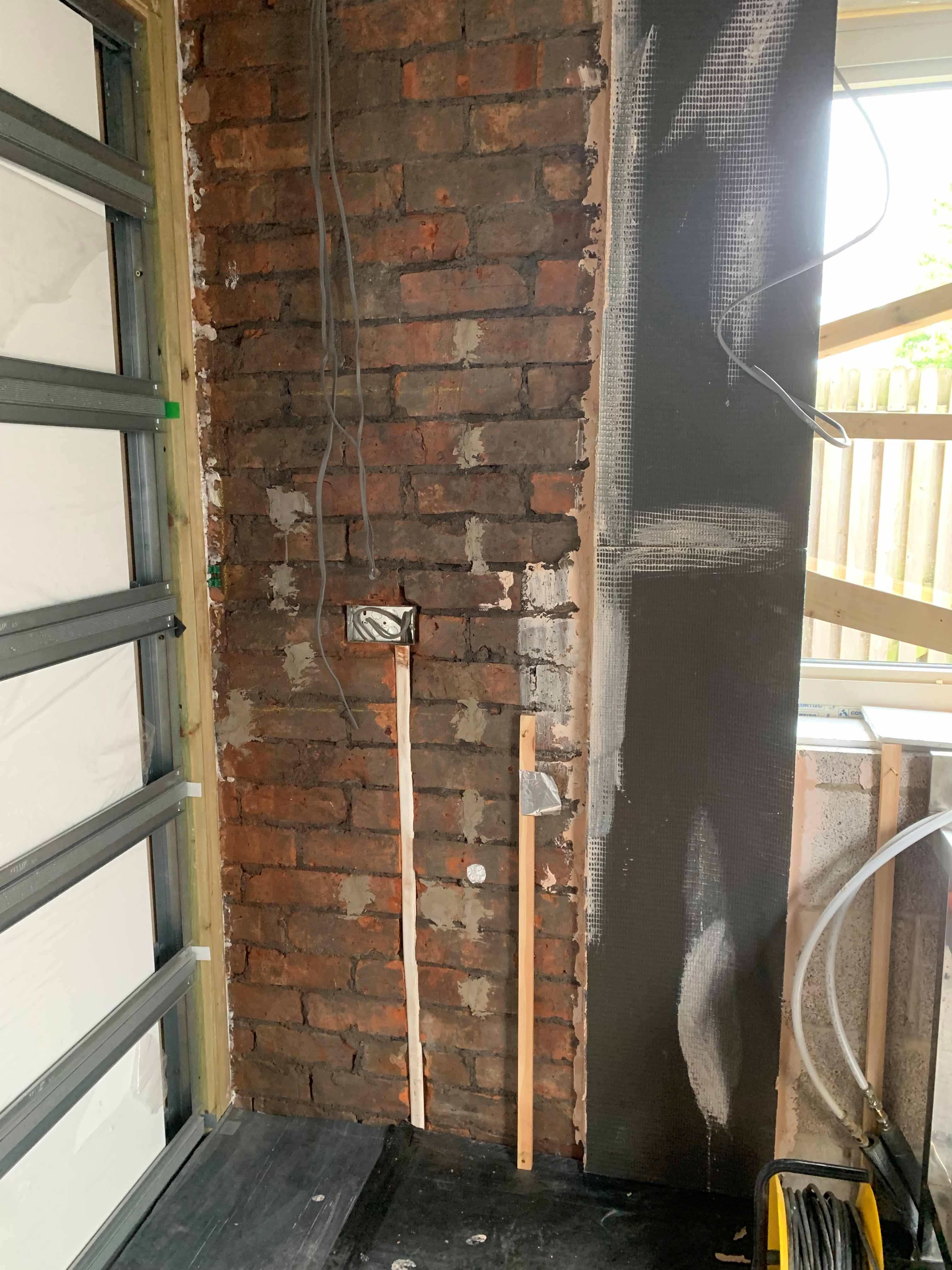

Spinny Posted August 3, 2025 Author Posted August 3, 2025 Pictures... Silver circle is approx position of waste pipe to come through the wall from the u/stairs basin. Silver square approx location of water pipes to go through the wall to the basin. two wooden sticks show approx position of the washer bay and the dryer bay extent. Cables down wall are switched live and live for switch in the wall cupboard for the extractor fan. So need to 'solve' routing for the plumbing and for electrical sockets for the washer and dryer - drain is located underneath the sink. I think a grid switch to turn the washer and dryer sockets on/off somewhere would be nice - would have to come off the ring main ? A washer seems to be up to around 2.5kw or 11A, and a dryer either 12A for a condenser or 4A for a heat pump. Do people still use a stand pipe for the washer plumbing, or directly connect it into a waste pipe to the drain ? And should the same waste pipe be used for washer and the u/stairs basin ? waste pipe would occasionally block with gunge on our old one.

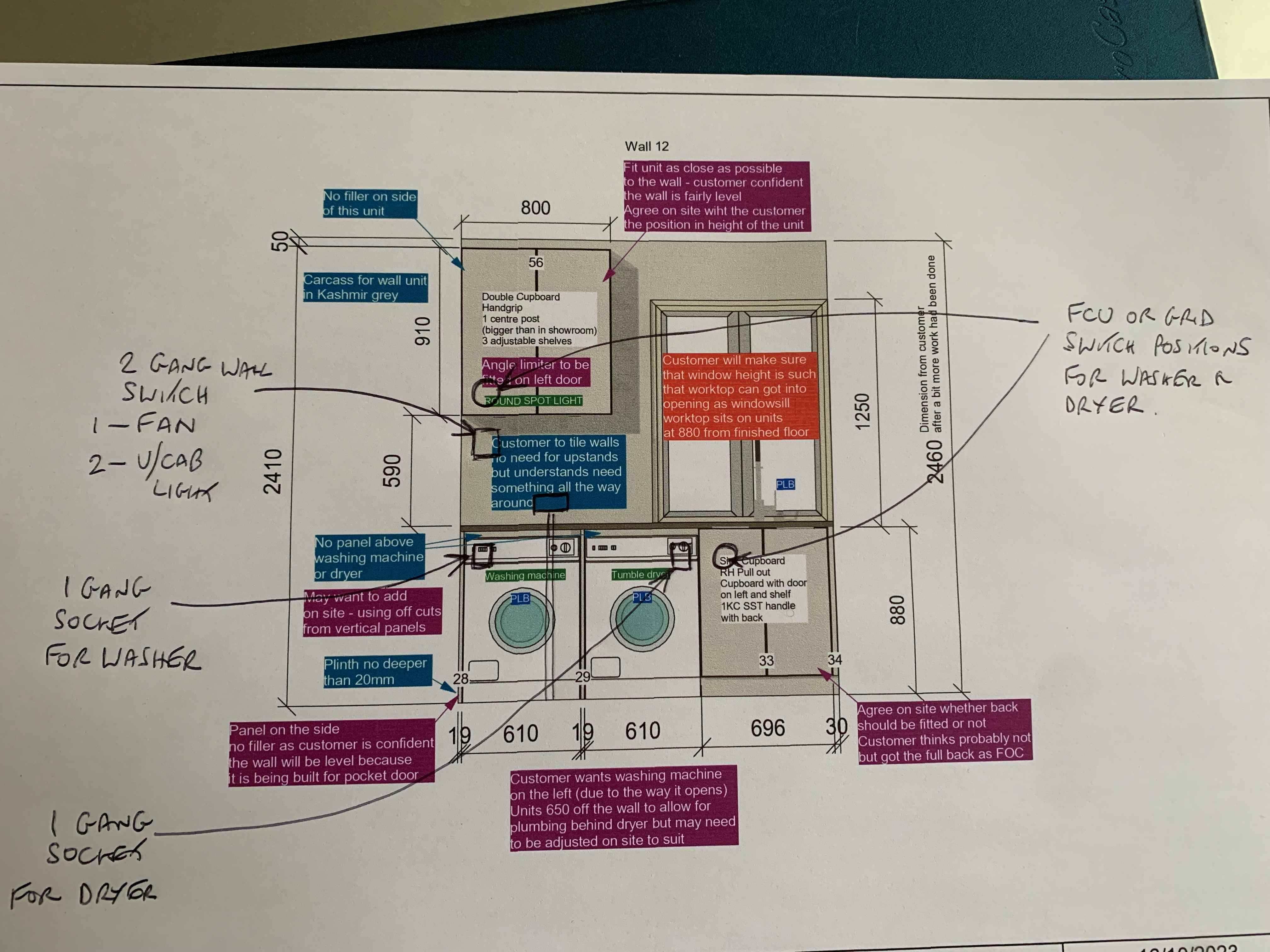

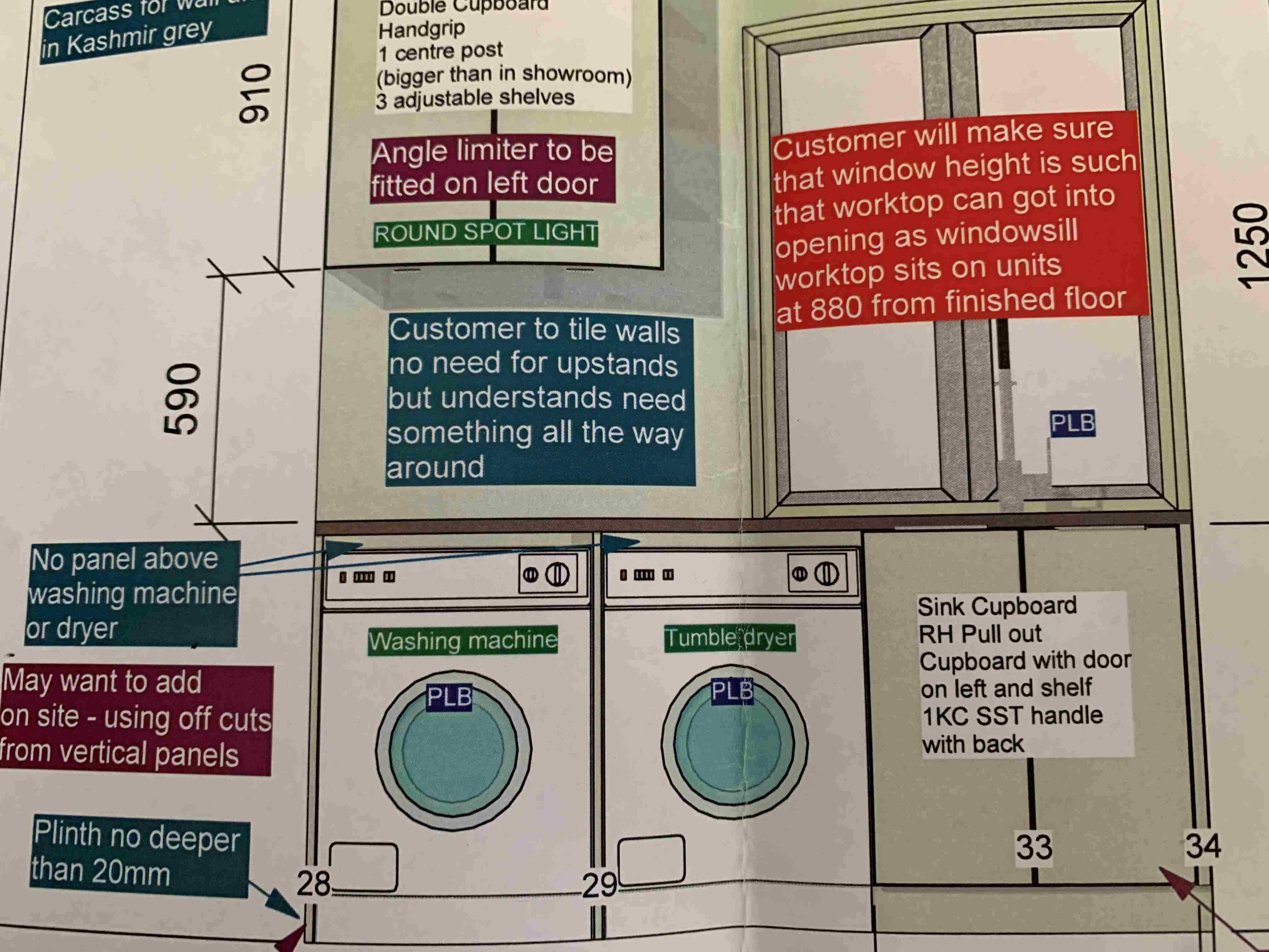

Spinny Posted August 11, 2025 Author Posted August 11, 2025 Still wooden head scratching on this one. Came up with this proposal, but now I find some manufacturers put the water inlet in the top corner where I thought to put the washer unswitched socket. Is there any 'safe zone'/'unfouled' area anywhere behind a washing machine that the manufacturers respect where you can site a socket and plug ? Without chasing into the single course brick wall, will have 25mm surface box (half covered with 12mm wet plaster, then a cover plate and plug seems to add another 30mm. This then totals 13+30 = 43mm mm clearance from the plaster line required - machine is 600mm - so the minimum would seem to be say 650mm deep worktop. And only that if I can find a socket position that doesn't foul with the drain hose or the inlet hose or the top cover, or the back of the drum.

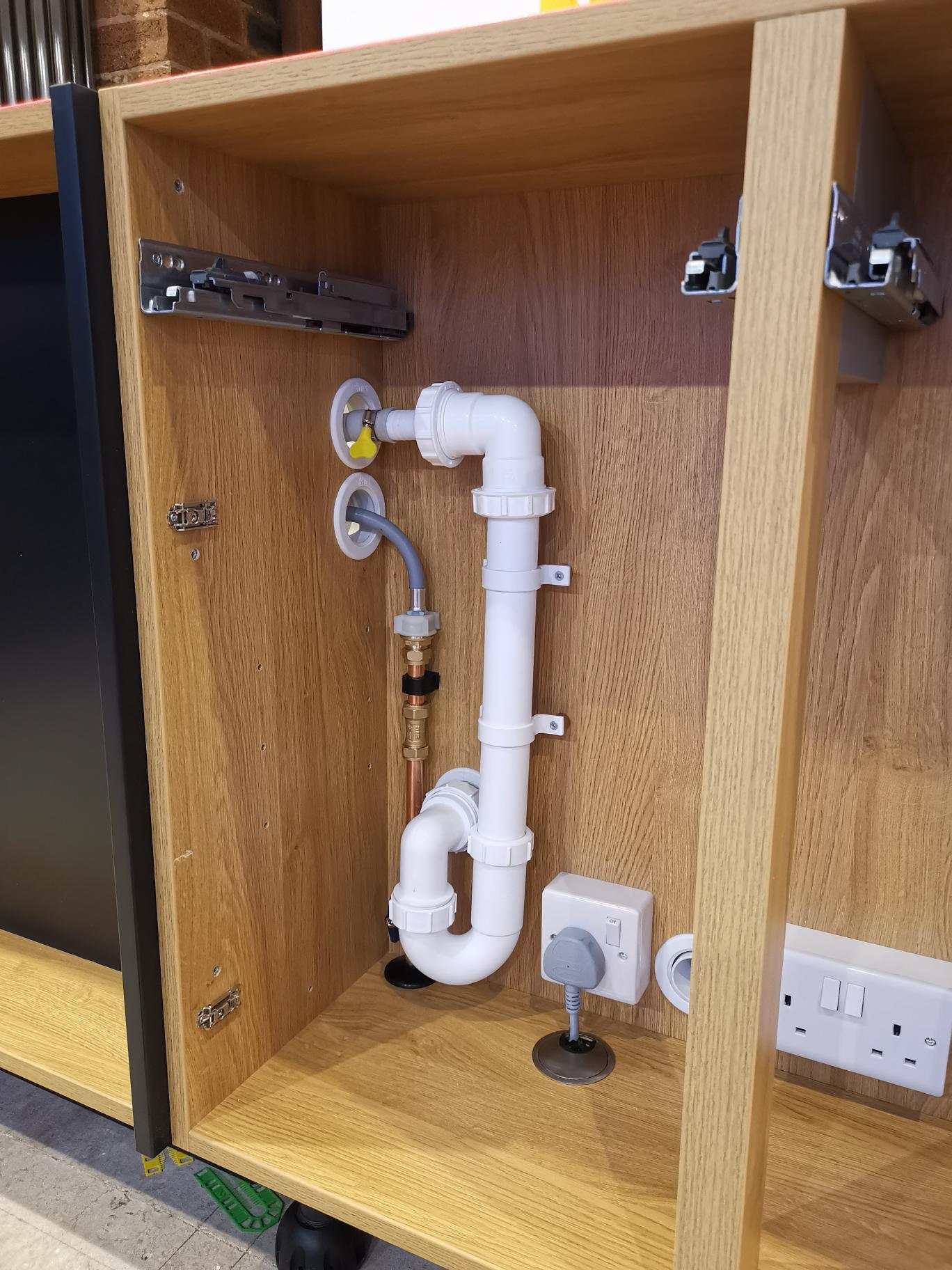

Super_Paulie Posted August 12, 2025 Posted August 12, 2025 as you have the 2 appliances side-by-side you are going to still have to remove the hoses if you need to pull one out, so its not a huge difference to have to pull the plug out as well as the hoses. Id personally have the 2 single sockets under the sink. If you are worried about pulling the plugs for whatever reason then cut the plugs off and hard-wire to 2x FCU's and then all you have to pull through will be a skinny cable. As for the plumbing i went a standpipe with a sealed top per appliance. Seems to work just as well as an open top one to be fair but there are no chances of any leaks from an overflow. I have noticed it makes an "air bomb" noise when emptying into the trap, but im happy with it. If this is a utility room then id probably just put both hoses into spigots from the sink and close the door. Im open-plan, so need it quiet. 1
Mike Posted August 12, 2025 Posted August 12, 2025 (edited) 1 hour ago, Super_Paulie said: as you have the 2 appliances side-by-side you are going to still have to remove the hoses if you need to pull one out, so its not a huge difference to have to pull the plug out as well as the hoses. This. Also, when you push the machine back in, you don't have a cable looping on the floor and getting in the way of the wheels - you can pull it through from under the sink. Edited August 12, 2025 by Mike
Spinny Posted August 12, 2025 Author Posted August 12, 2025 50 minutes ago, Super_Paulie said: I have noticed it makes an "air bomb" noise when emptying into the trap Presumably needs an air admittance valve added in somewhere ? That looks amazingly neat and trim with grommets etc you must have a tidy plumber. For the washing machine hose I am thinking to put a fixed drainage pipe in the washer bay, to run across behind the dryer, and into the undersink cabinet to the sink drainage pipework. Then the drain hose could attach to that directly behind the washer leaving the flexible hose slack for pulling out. I am going to put a socket behind each appliance running to a grid/FCU under the sink. I have other pipework going onto the same wall to pass through the wall and supply the u/stairs toilet basin taps and waste. So I think there is too much going on in that area to rely on pulling wires, plugs or hoses through two bays. And of course you cannot pull anything except by sliding the washer forward and using the fixings into the machine to pull the wires/hoses across. Bound to get snagged up and end up turning a 5-10 minute slide the machine out to check a possible leak into 2+ hours of messing about disconnecting and pulling the dryer out too to hand feed stuff through etc. with much cursing when(if) I get to 70 years old.
Super_Paulie Posted August 12, 2025 Posted August 12, 2025 i couldnt get a plug behind my machines unless they are way down at floor level, my machines are like 5mm from the wall when pushed home.
Super_Paulie Posted August 12, 2025 Posted August 12, 2025 (edited) 3 hours ago, Super_Paulie said: I have noticed it makes an "air bomb" noise when emptying into the trap, but im happy with it. If this is a utility room then id probably just put both hoses into spigots from the sink and close the door. Im open-plan, so need it quiet. i took guidance from @Nickfromwales so i dunno, any thoughts Nick? i assume when the machine discharges its airtight in the standpipe so has to push that air out. Only noticed it when its on the drying cycle, cant confirm it does the same on the washing cycle so im guessing its pushing hot air through the waste. Can easily remove the spigot and just push the hose in, but id like to understand. When it exists the cabinet it goes directly into the stack. Edited August 12, 2025 by Super_Paulie 1

Nickfromwales Posted August 13, 2025 Posted August 13, 2025 On 12/08/2025 at 13:35, Super_Paulie said: i took guidance from @Nickfromwales so i dunno, any thoughts Nick? i assume when the machine discharges its airtight in the standpipe so has to push that air out. Only noticed it when its on the drying cycle, cant confirm it does the same on the washing cycle so im guessing its pushing hot air through the waste. Can easily remove the spigot and just push the hose in, but id like to understand. When it exists the cabinet it goes directly into the stack. Not sure I’ve had that issue, but maybe we have and just nobody’s highlighted it or was bothered by it. I guess try it with the connection removed and with the discharge hose down to the bottom of the trap, so the end is submerged, and give it a test drive.
Super_Paulie Posted August 14, 2025 Posted August 14, 2025 17 hours ago, Nickfromwales said: Not sure I’ve had that issue, but maybe we have and just nobody’s highlighted it or was bothered by it. I guess try it with the connection removed and with the discharge hose down to the bottom of the trap, so the end is submerged, and give it a test drive. i'll see if i can capture it in a recording. Doesnt bother me to be honest, its just a sound that id never heard before with an open-ended standpipe.
