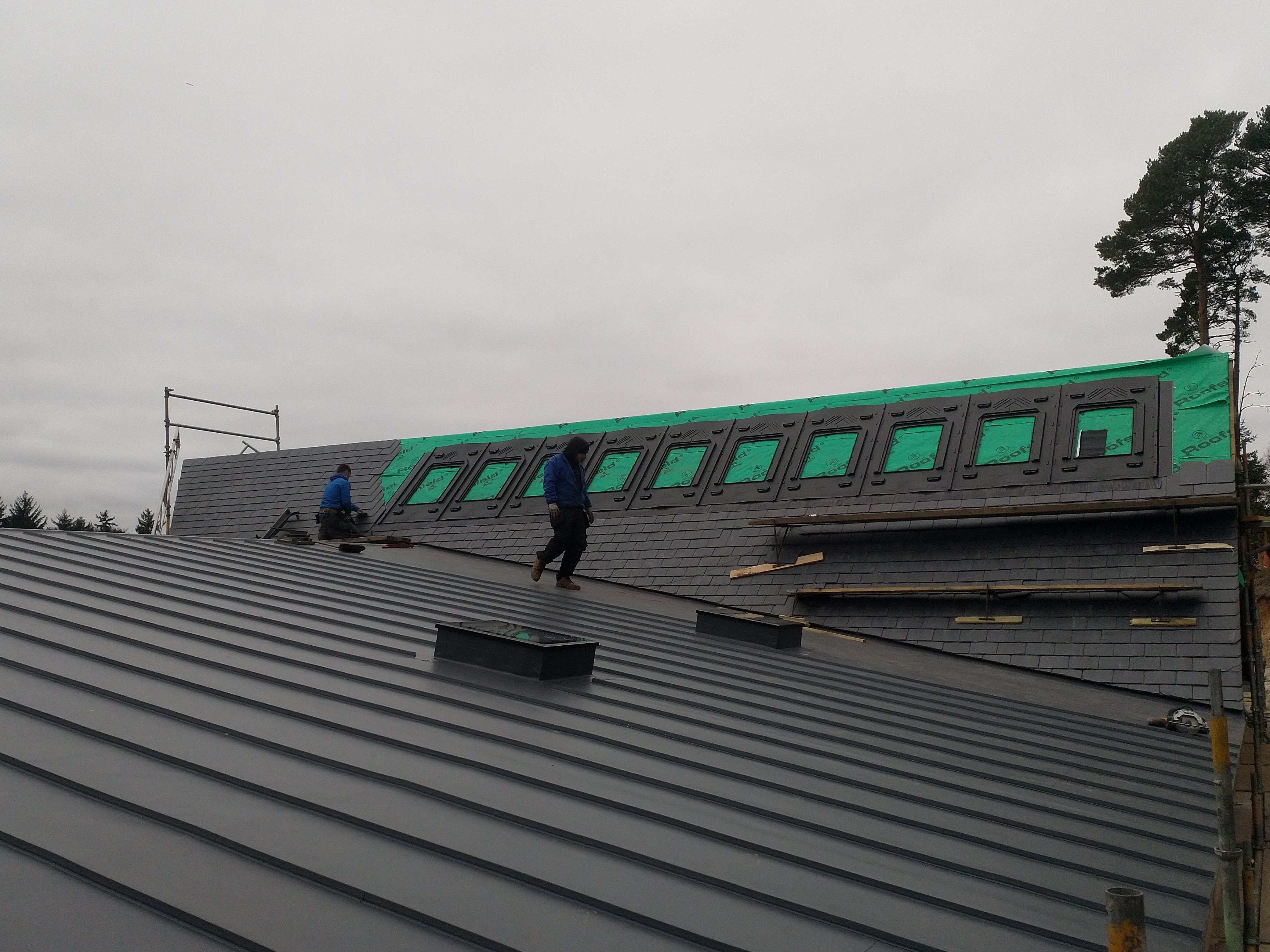

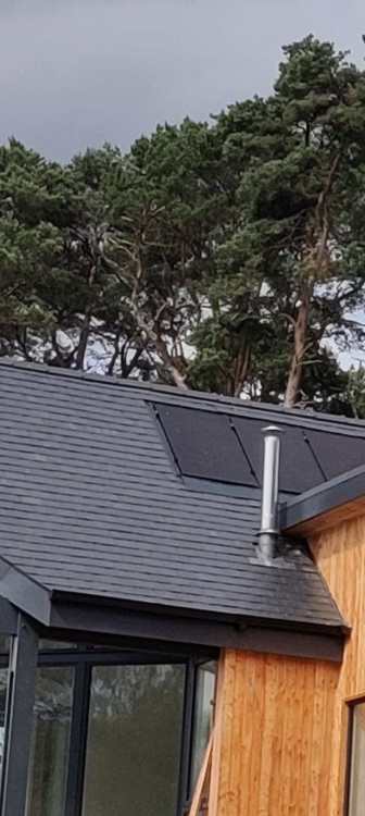

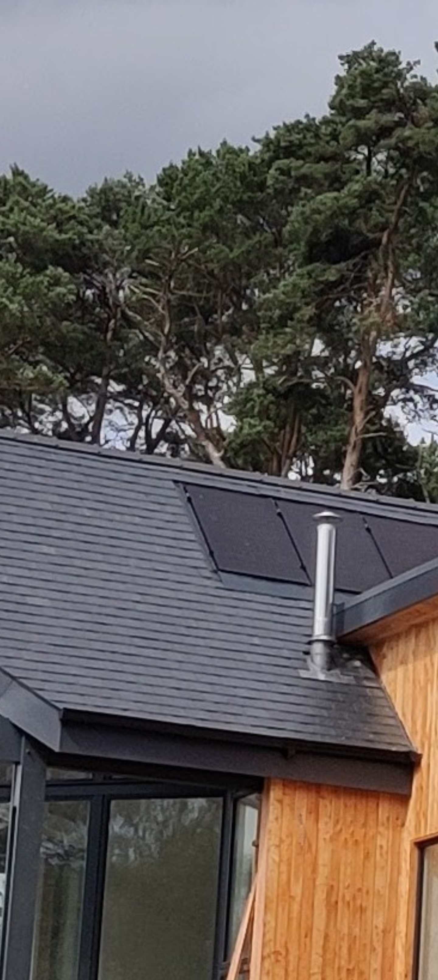

JohnMo Posted Tuesday at 13:53 Posted Tuesday at 13:53 This mine I have two slate at the top then the dry ridge. Not that obvious from the photo but there is step change in height as the tile overlaps the gse panel.
Nickfromwales Posted Tuesday at 14:01 Posted Tuesday at 14:01 Most need at least 1-2 courses above, to meet the ridge. This is where wind driven rain will want to get in. I guess the deciding factor is the dimension of the flashing on the tray system of choice? Images I’ve seen where the solar is 100% the size of the roof, have been on-roof systems eg fitted over a weathertight and functioning rain screen.
